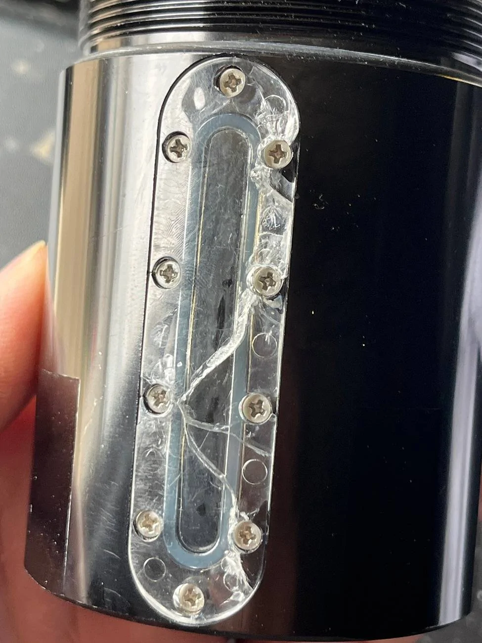

Sure glad I looked at the catch can this morning 😬. The view window it had, broke! Not sure if the plastic window broke from the pressure or heat or both. I ordered another one without the window but has a dip stick.
I dumped out the oil that was in it and just dropped it off at the lab. I’ll have the results tonight or by morning and we shall see what dirty little secrets the mist holds.

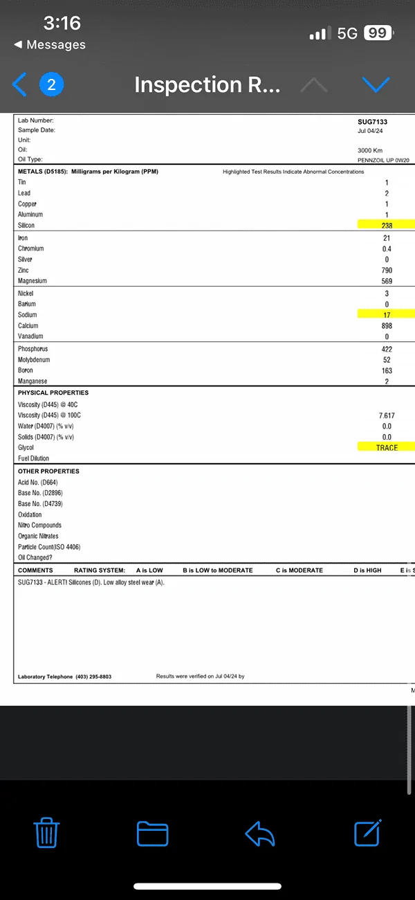

Lab results are in! (Love getting results the same day!)
3000 kms on the oil.
My initial take is that the high silicon, sodium and trace glycol is from the contamination in the manufacturing of the hose. I bought new hose. No fuel dilution.
You and Glycol.

You and Glycol.
🤣 I swear, the glycol has to be in the manufacturing of the hose. Where else would it come from? I don’t have a consumption problem, according to my last engine oil analysis…🤷🏼
I told the lab tech guy I want to see if there’s fuel vapour or water in this test.
Makes me wonder if your testing company can distinguish it between Ethylene Glycol commonly found and used it vehicle coolants vs. Propylene Glycol that is way more human safe?
I cannot see Ethylene Glycol being used by any company as a cleaning agent if their product has any means to be in a vehicles lubricated parts system.
All I know is they perform glytech tests to determine contamination
