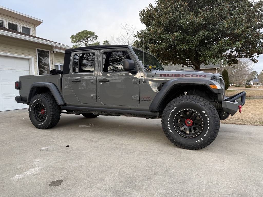

I found a fairly new pair of Mojave Shocks on FB in my area.
Can I put the Mojave Shocks on Gladiator Rubicon Diesel? Just the shocks.
Current Build
'21 Gladiator Rubicon Diesel
Standard OEM Rubicon Suspension with Fox Shocks.
1.5" Terraflex Spacer in Front
3/4" Daystar Spacer in Rear
35" BF Goodrich KO2
I did it and didn't like it. Never had the stock shocks so it maybe better. I believe mojave is 14mm bolt while everything else is 12mm. I made aluminum spacer/sleave and it worked. Everyone will have their opinions and its based on their preferences and their experiences.
