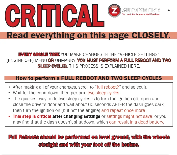

There is probably a miniscule parasitic drain from the Tazer, but in the grand scheme of all the other parasitic drains on a modern vehicle, it's well, minuscule. Only exception being if you made some programming changes with it and did not exactly do the proper reboot/sleep cycle/sleep cycle sequence. That *could* cause other problems that could kill the battery. But 6 yrs is a good run these days for vehicle batteries. I would fully charge BOTH batteries and check them and the charging system first. And budget for 2 new batteries.

I would say the answer is yes since they state it right in there manual but not sure if that is affected by Live Functions are not. But it is possible for the Tazer to drain your battery.

I got an answer from Tazer. They said that the winch mode is a LIVE feature. Meaning that, its still operating till I shut it off. Since I didn't tap the gas pedal to shut winch mode off before shutting the engine off, It was still pulling power. That explains the power drop.
The good news is that once I got home yesterday afternoon, It started right up, I drove it around 30 minutes to the kid's track meet, was there a couple hours and it started up again just fine. Drove home and it started up again this morning.
