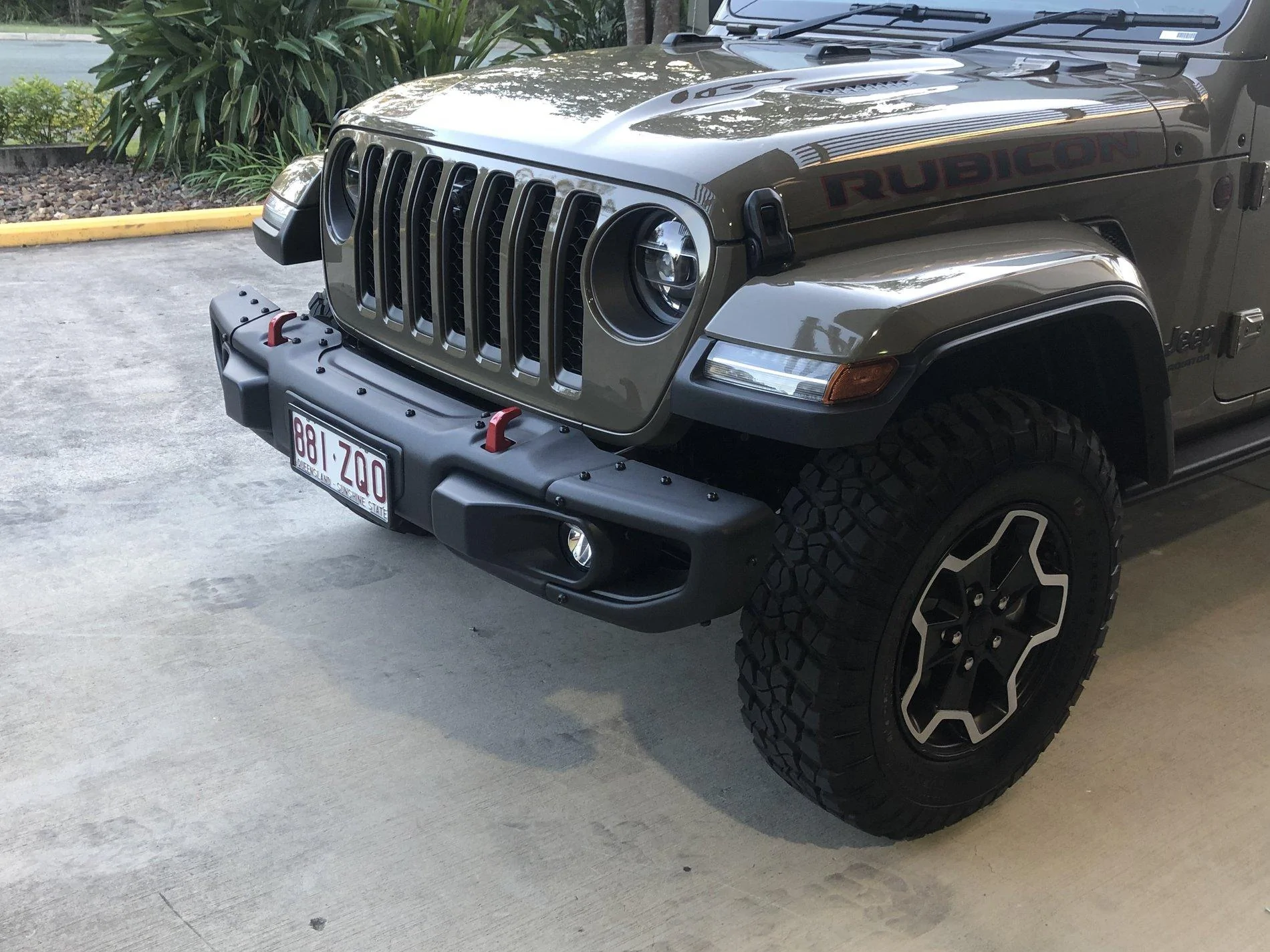

Can this stock piece between the fender and bumper be removed?

The cutouts won't fit your non-cutout bumper. The steel bumper itself is different. I know.......I ordered the cutouts, the piece between the grill and bumper (it has different sides) and it would not fit period. Why??? Why??? Would Jeep make 2 different steel bumpers that are behind the plastic cover????? Anyway, they won't fit.

Yep, first thing that came off mine, with the steel bumper the fog light wiring was slightly exposed anyway, 4 screws each side and gone.
Same first thing I did was get it home and start removing all the nanny plastic. You could also remove the pointless number plate holder, it's just screwed into a plastic insert that's covering fairlead. Just screw the number plate back to that

For anyone that comes across this in the future, i took a very thin and sharp blade and slowly cut the piece off so that my fog lights were still protected. It looks great.
Granted i only tried it because i ordered a new bumper to replace the stock one so if i messed up the stock it didnt matter.
I trimmed mine with a standard utility knife and it went fine, just take your time and slowly cut in increments as opposed to going balls deep right away.
I did the same thing to mine, but I used a utility knife instead of a dremel then cleaned up the edges with a mill bastard file. I only spent about 30 minutes total on it, you could probably clean it up even better if you really wanted but from the front you can't even see them and it doesn't really bother me.

This was the first part removed from mine when i got it home.
