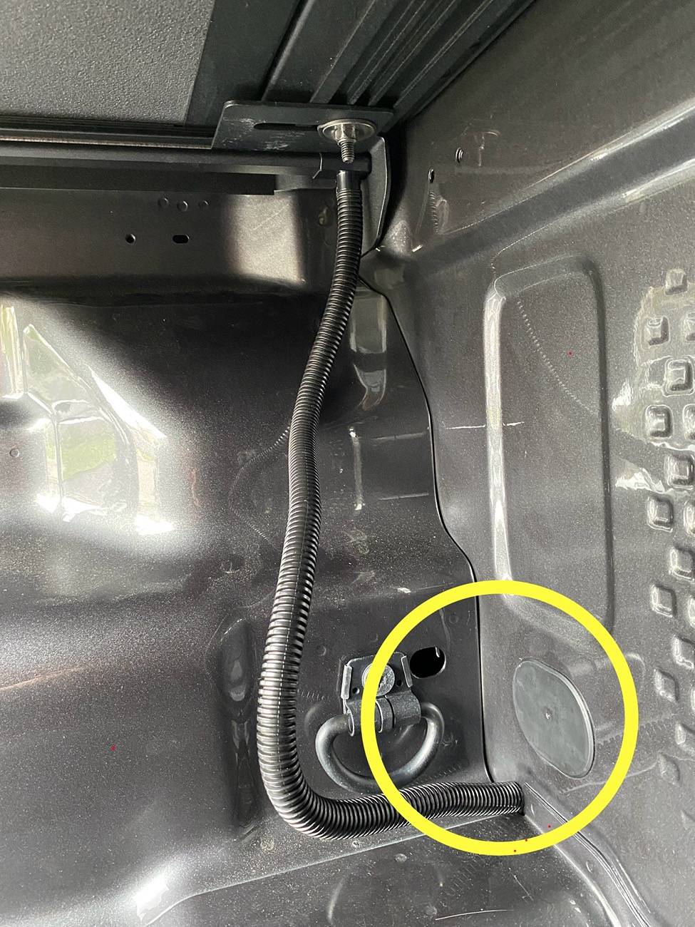

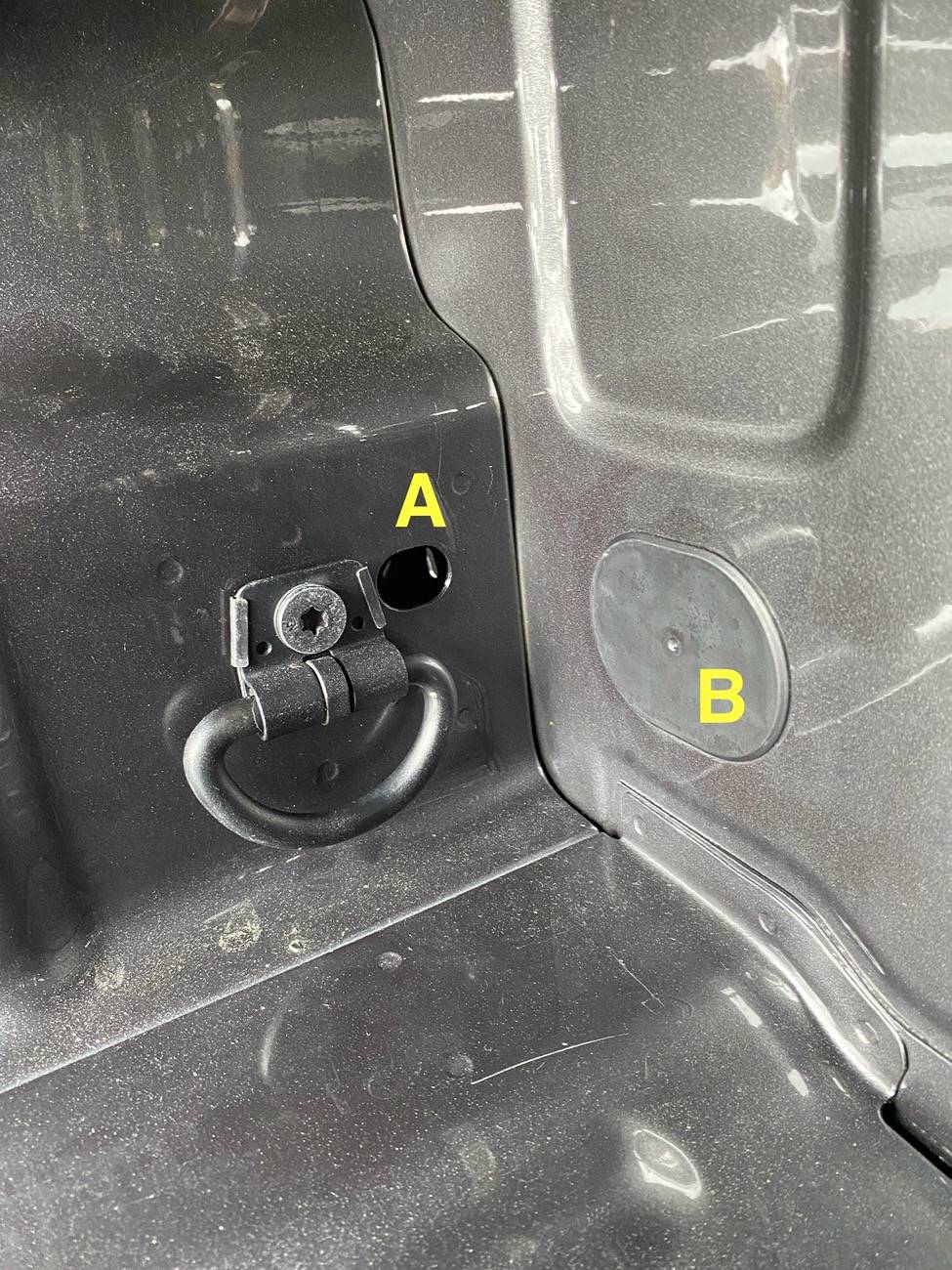

The Gladiator’s bed has two drain holes located beside the front tie-down anchors, shown attached.
(B) is covered by a plug, and exits into the gap between the cab and the bed.
Does anyone know the path for drain hole (A)?

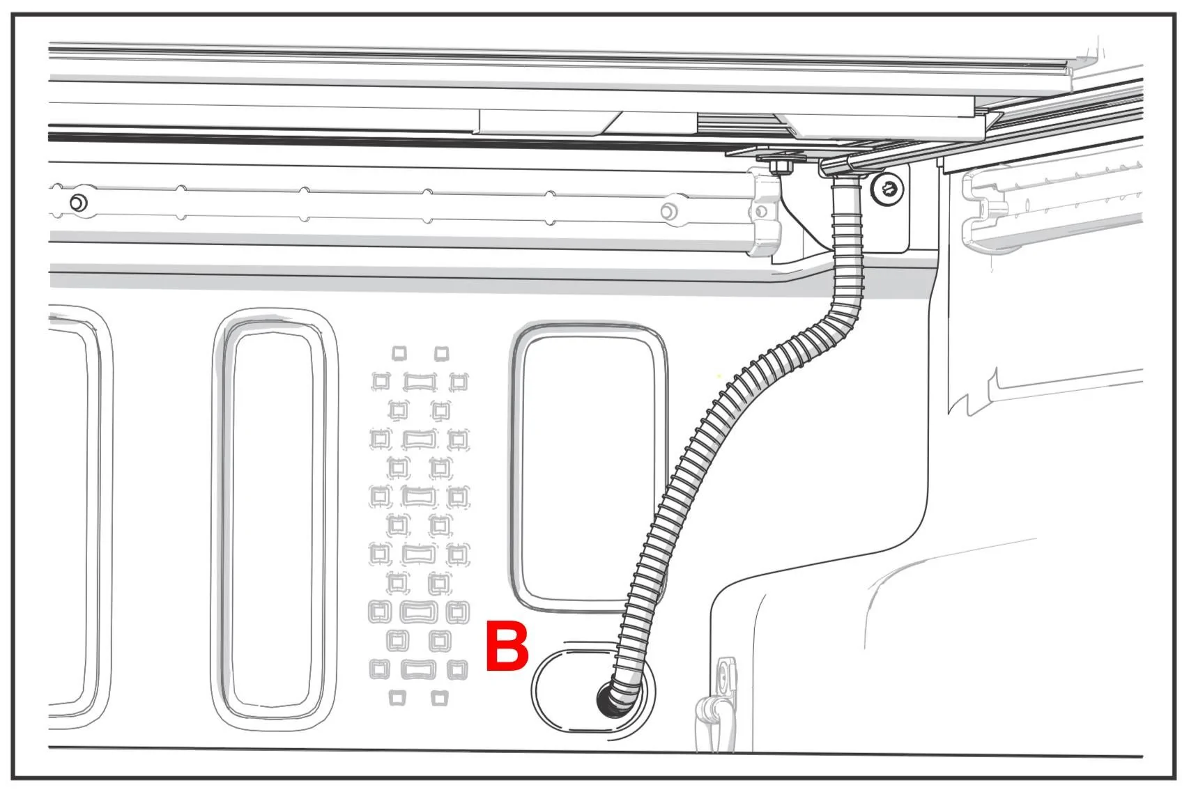

Installation instructions for the Mopar Hard Tri-Fold Tonneau Cover recommend drilling a hole in the bulkhead plug (B), but (A) seems like a better option with no drilling required.

A is a drain hole?
Are you sure? There are the same holes near the rear tie-down points, too. Can't see them as drains. I believe they simply are holes in the inner bed wall and don't "go" anywhere except out and down between the inner and outer bed walls/sides.
I plugged mine to keep dust out.
You'd only be drilling plastic covers, no big deal.

LOL - all that's needed is to get a hose out of the bed. Heck, you could take a hammer and chisel and make new custom cave-man type holes in it.
I don't have a tonneau or shell that requires any sort of drain. A hole would simply annoy me by letting dust in, so I plugged 'em.
IF I had a tonneau or whatever that needed to drain water - I'd probably still use the front areas because I'd not want any drain hose in the way of my tie down points. But that's me - picky.
Since those holes on the sides are at the front and rear of the bed sides and higher than the floor, but next to the tie-down points - you can bet they are there for manufacturing -either holding the panels on a jig, or assisting with the attachment of the tie-down points.

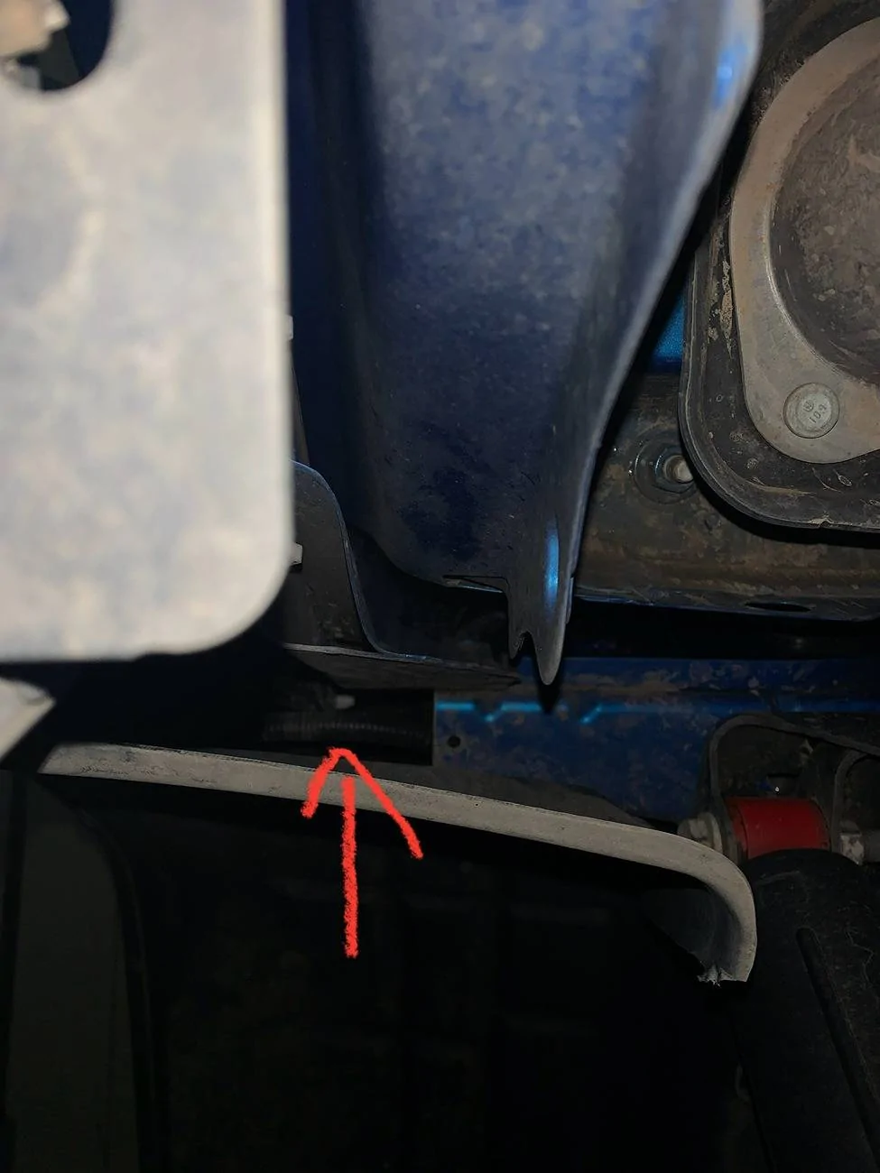

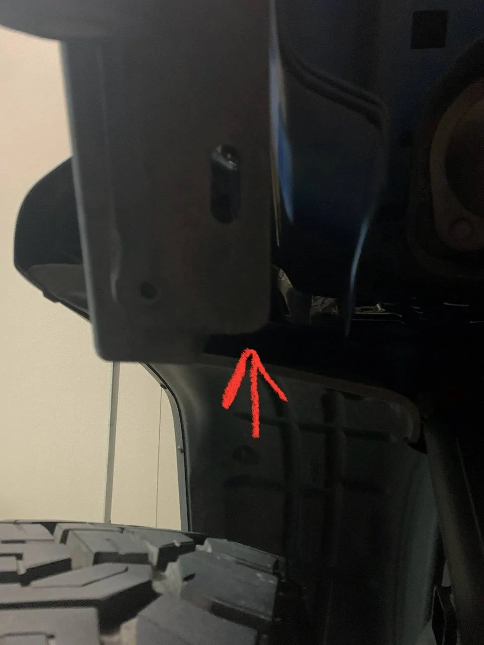

I have mine going out of what you indicate as hole (A). Here are some pictures of where it comes out. If you push yours through there and then look upward from just in front of your rear tire, you will see the drain sticking out. Mine drains water right there and water hits the ground just in front of the back tires.
Tire washers after you leave the mud! Great idea!
Just kidding.........
Whatever works. Doesn't matter the purpose of the holes if they work out like this. It's really not a bad spot to let water drain off of a cover or whatever.
Those pics give a good perspective.
They are there, ready to use, no drilling.
