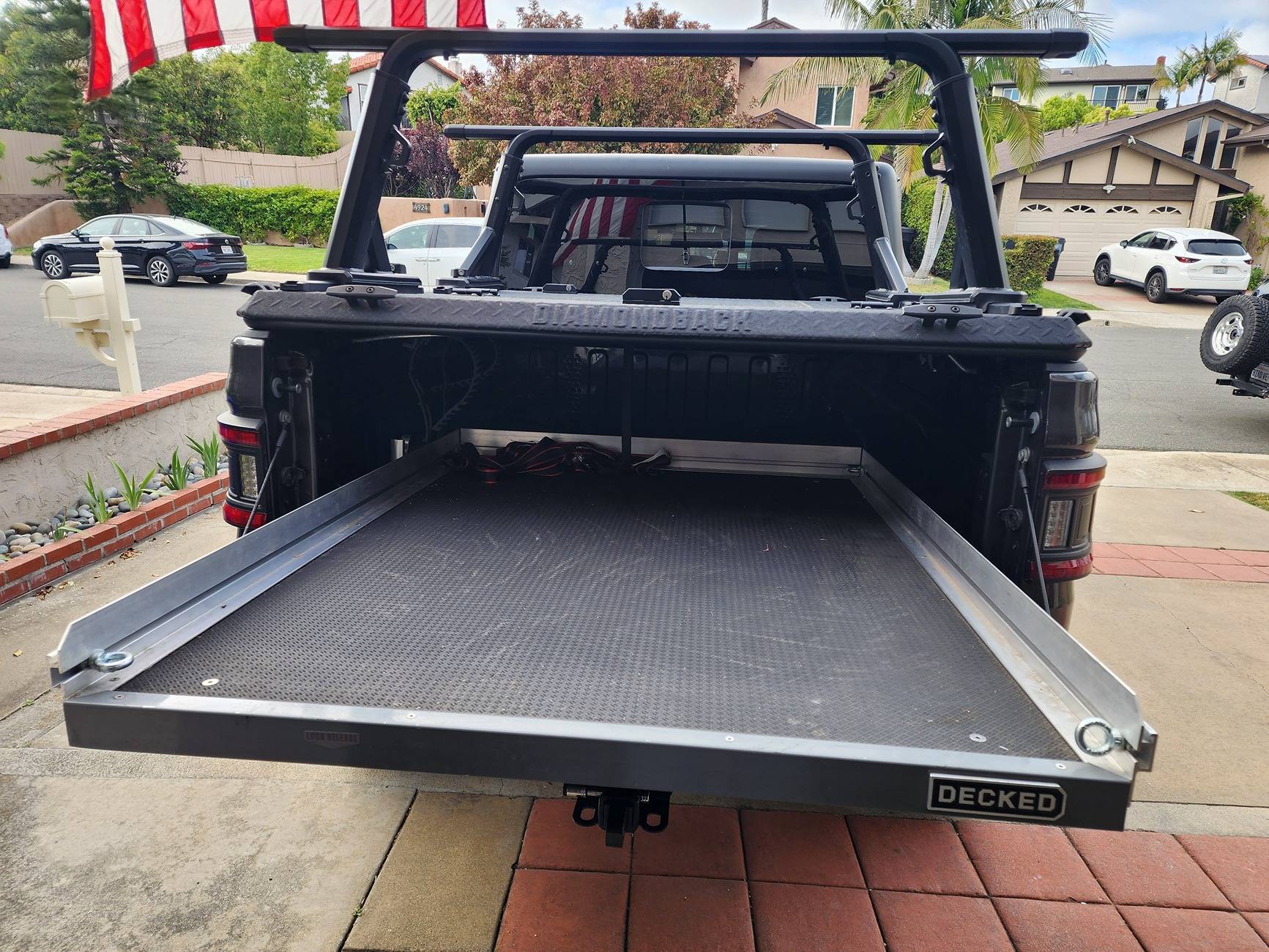

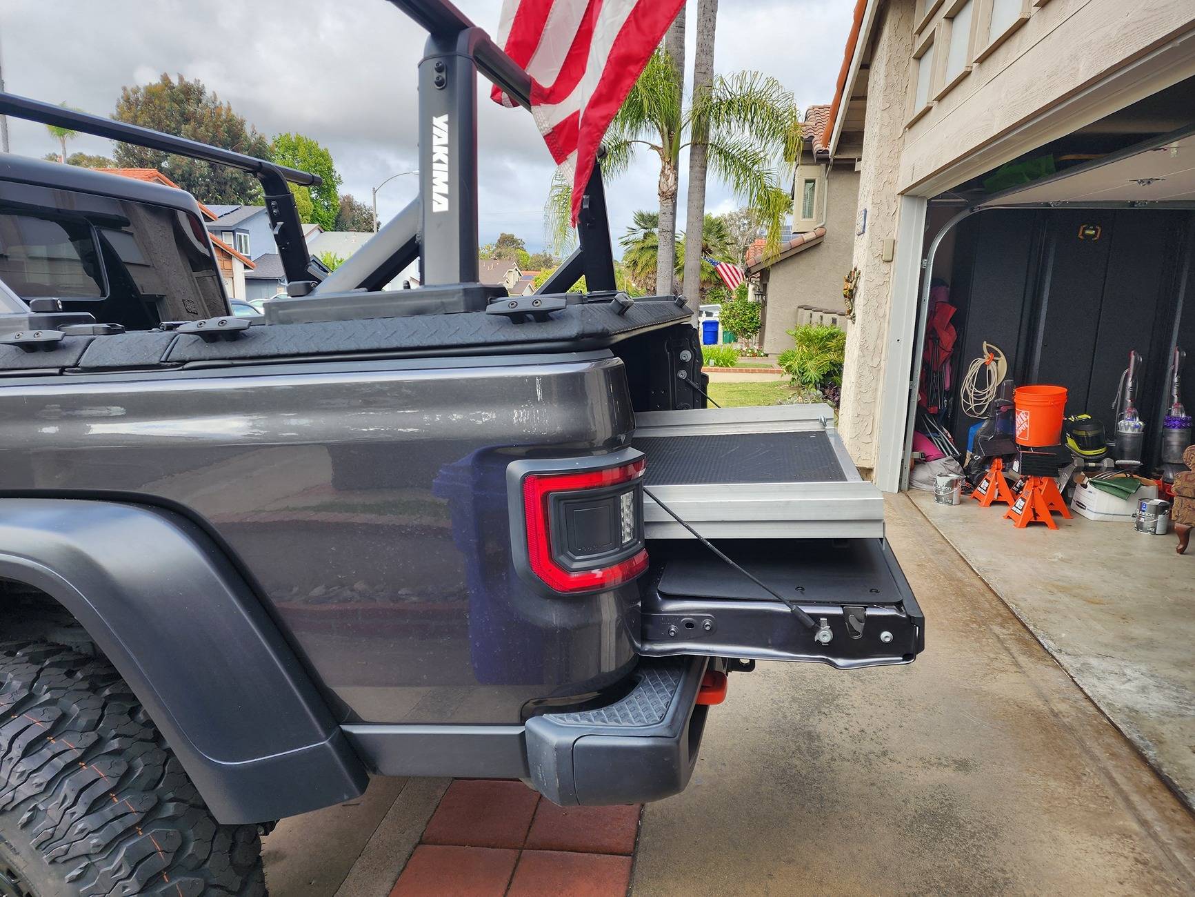

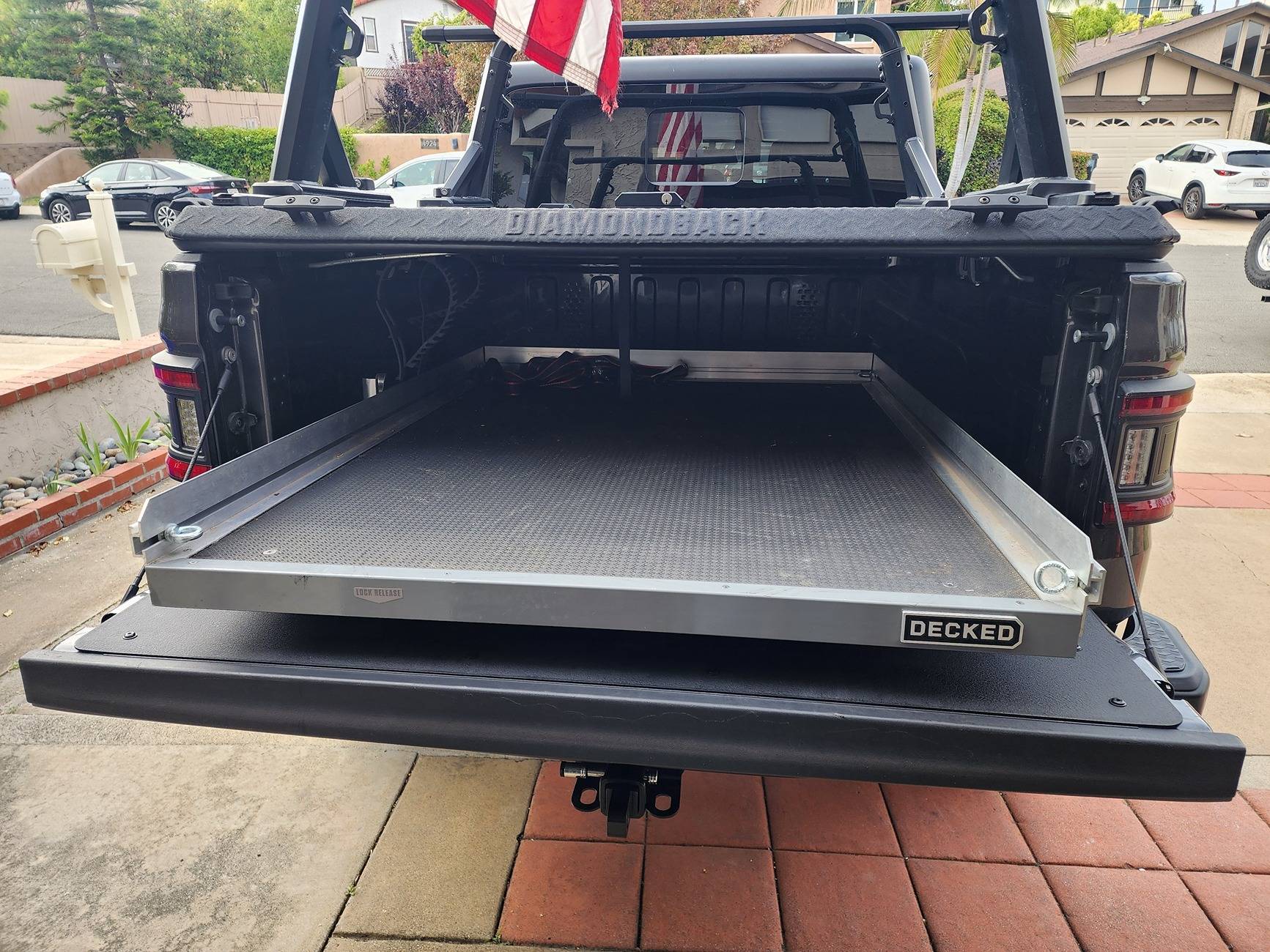

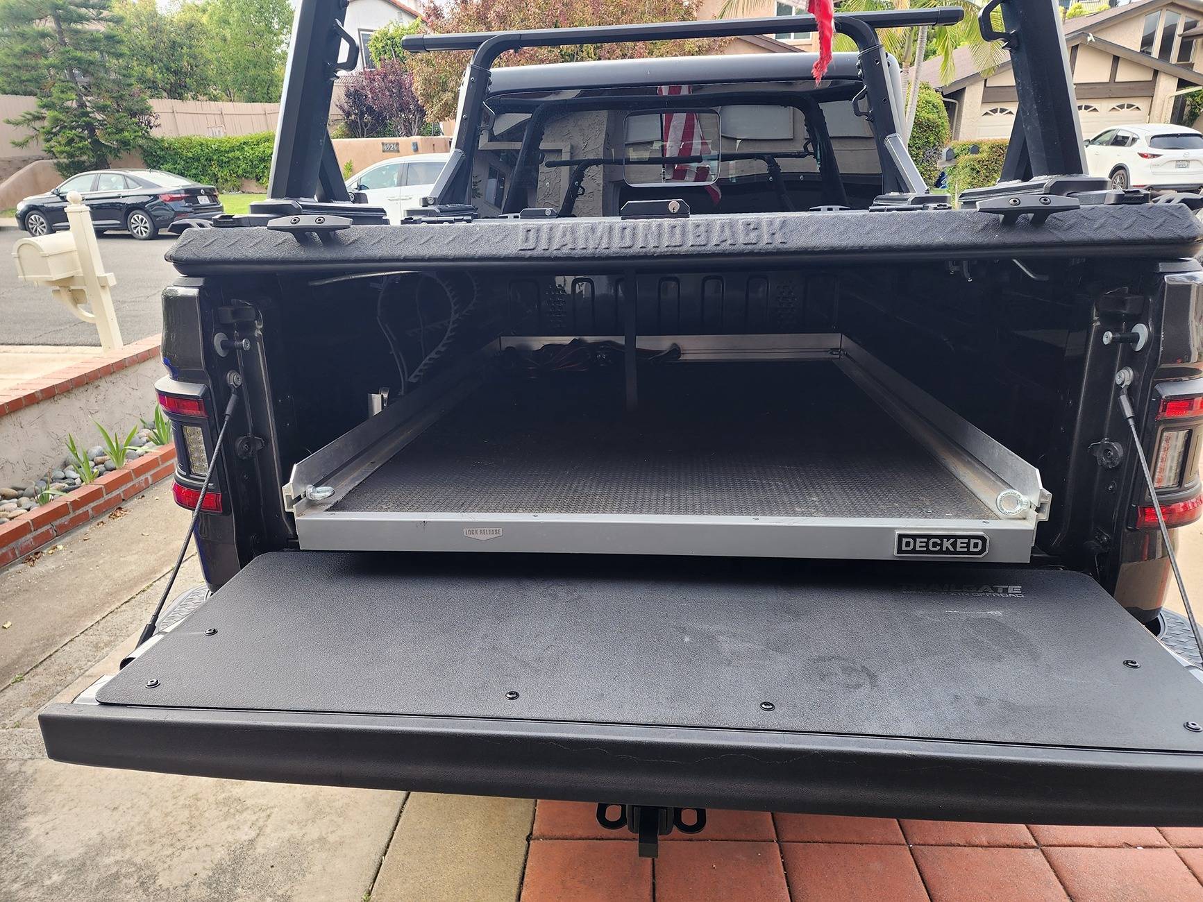

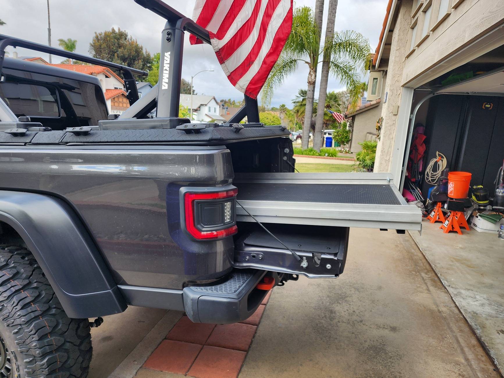

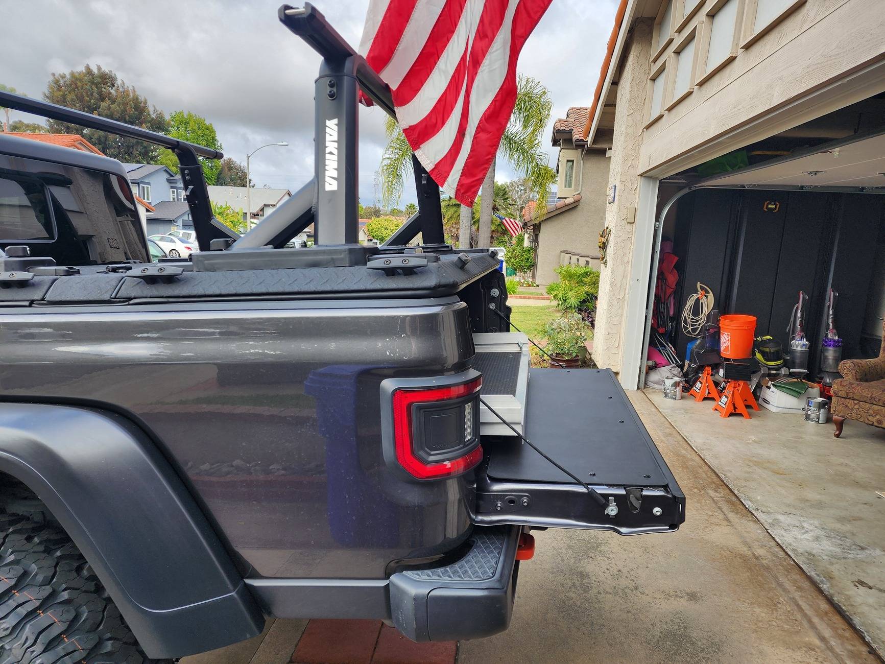

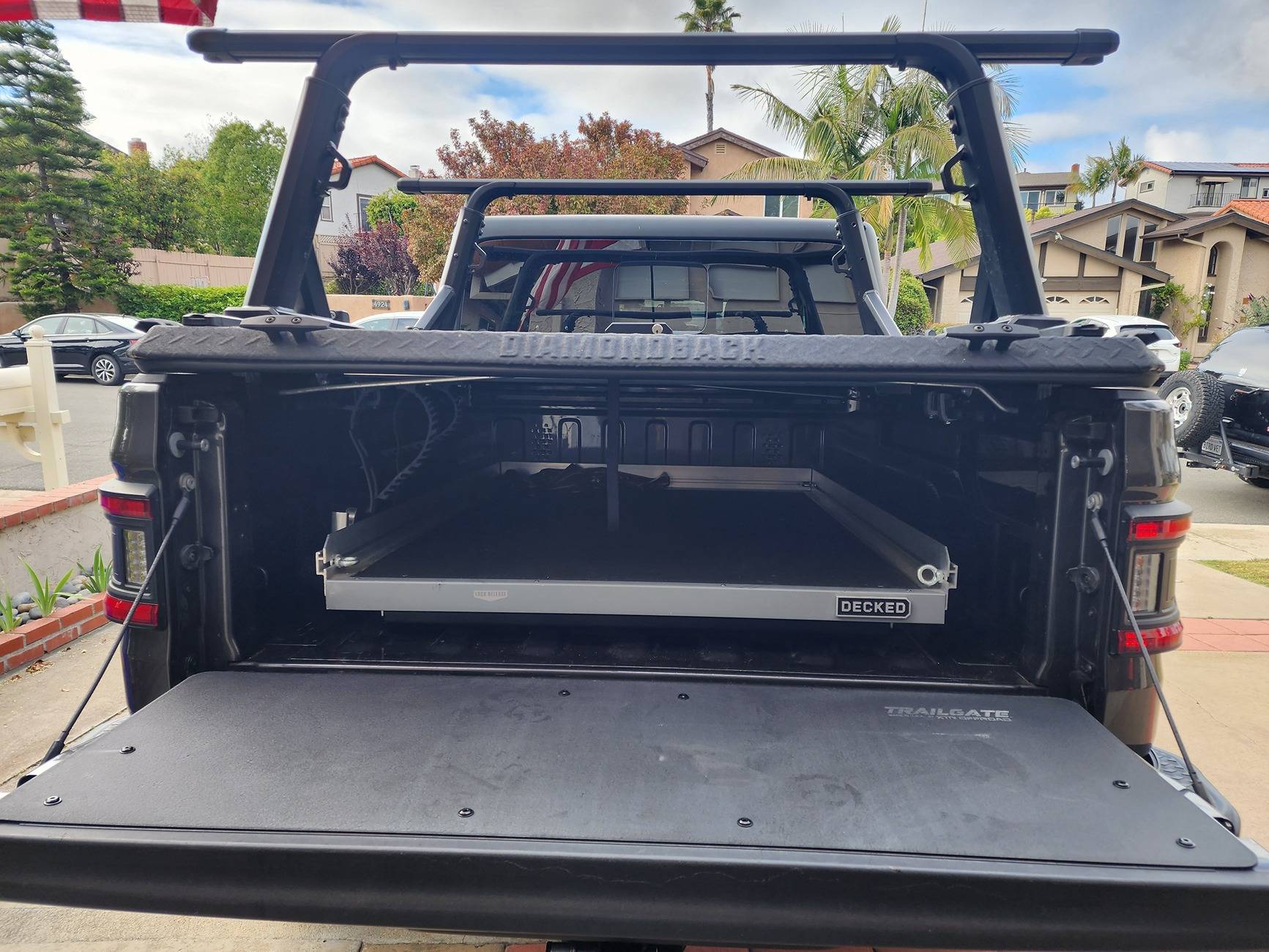

I have a Decked Cargo Glide. I didn't/don't notice the weight but I miss the verticle height under my DiamondBack. I really liked the price!
It has 3 stop locations and the deck is 5 inches above the bed.
That looks nice, thanks! I'm considering a slider now that I'm getting a full hard bed cap, since that makes it harder to get to stuff in the back. (I'm currently leaning toward a Venurous Ozark) I applaud you for it, but as you say, there's no way I'd lose that much height in an already ultra-low truck bed if I just had my tonneau cover. I have an ultra-low-profile slider that juuuuuuust barely fits my fridge under my tonneau cover, but I want the easy of storing full-height objects, and my bed rack doesn't make that easy.
