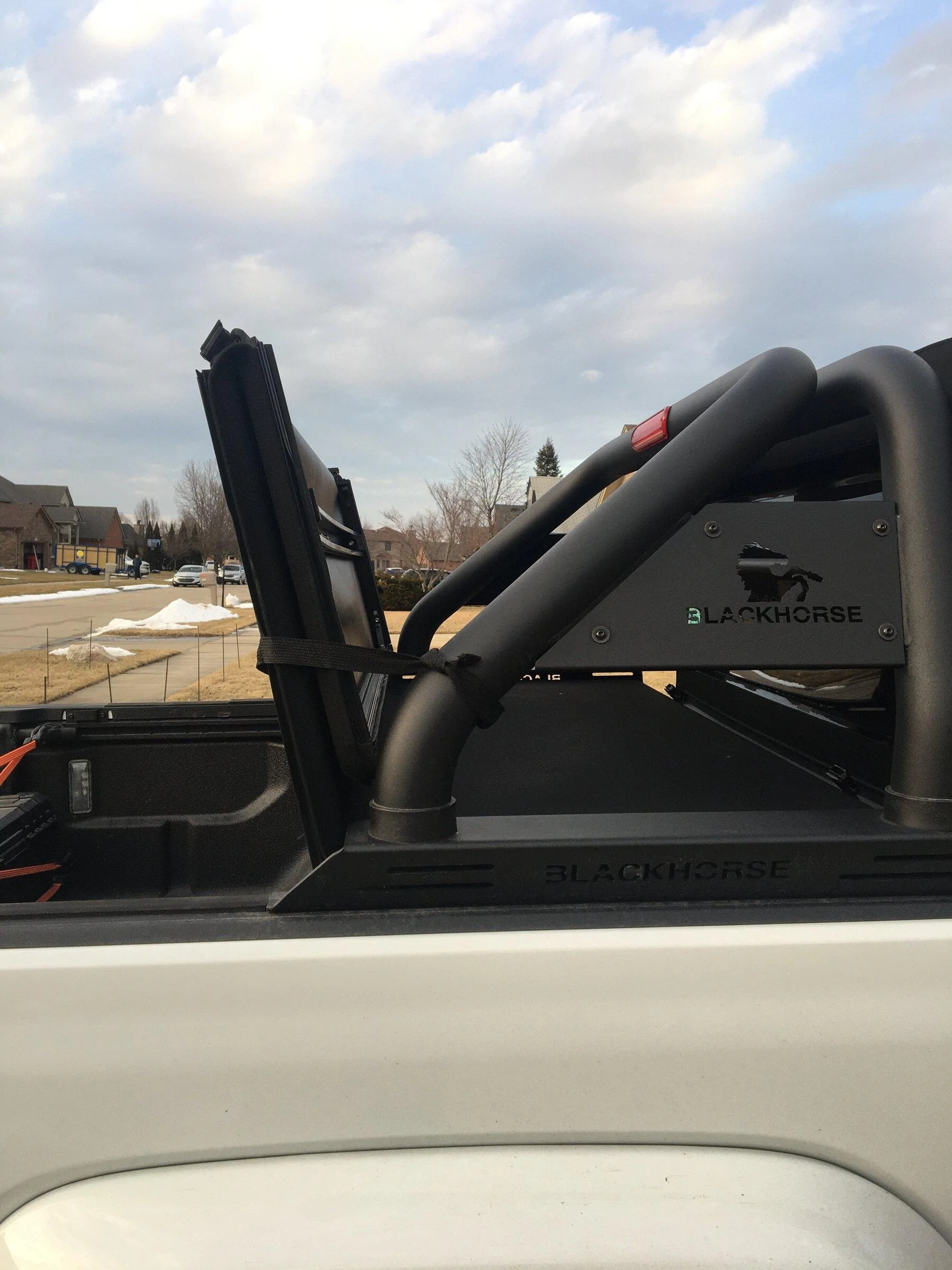

Sorry for the delay. Here you go. And yes, that's the one. Holy cow they have gotten expensive. I got mine on Amazon for I think either $459 or $499 back in Oct 2020.
Todd
Jeep Gladiator Black Horse Roll Bar Installed Tonneau cover folded up 1
Jeep Gladiator Black Horse Roll Bar Installed Tonneau cover folded up 2
Todd
No worries! Thanks for taking the time to get some pictures for us.

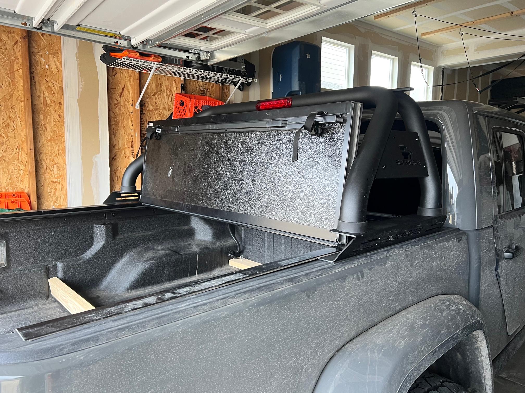

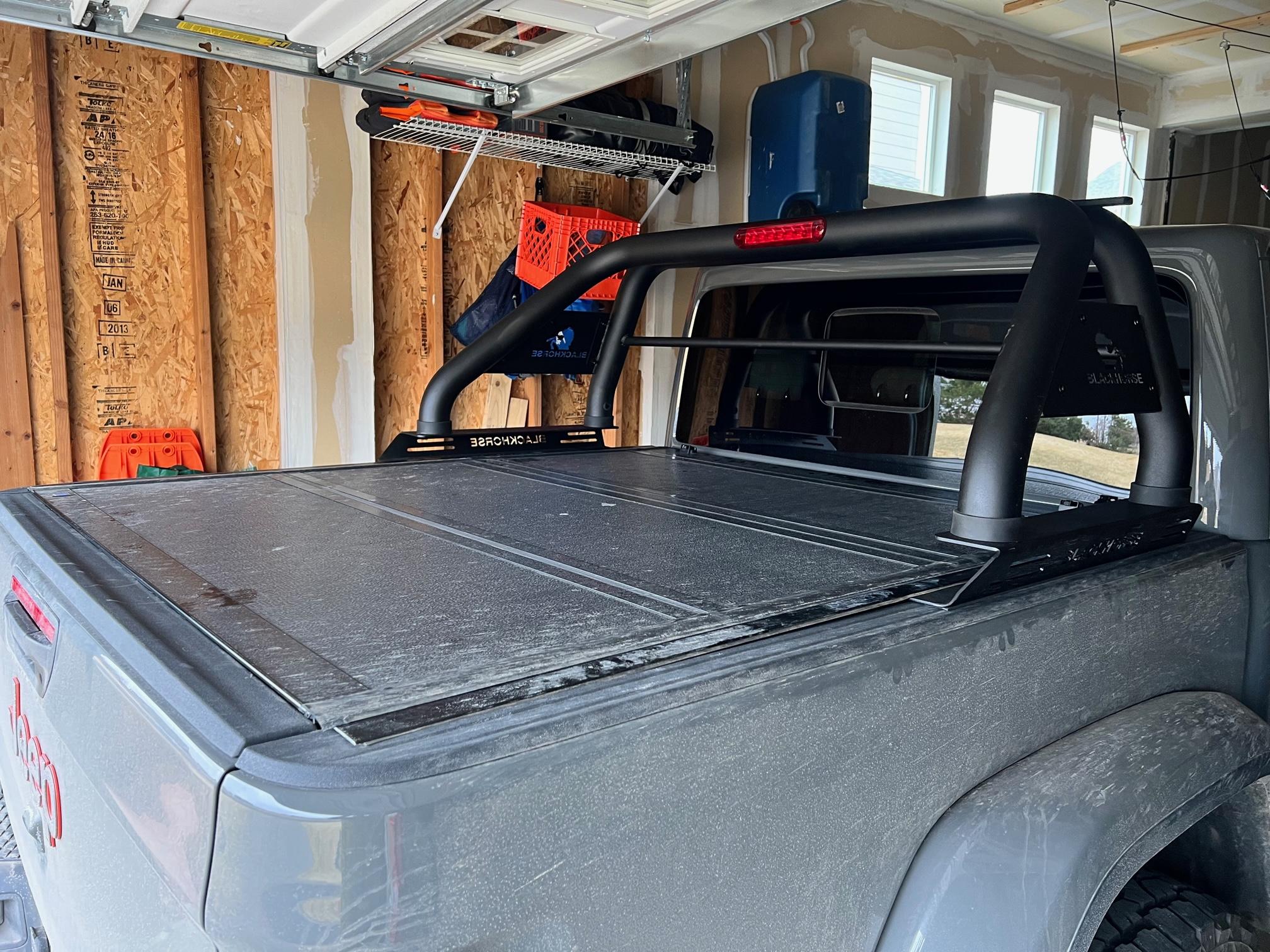

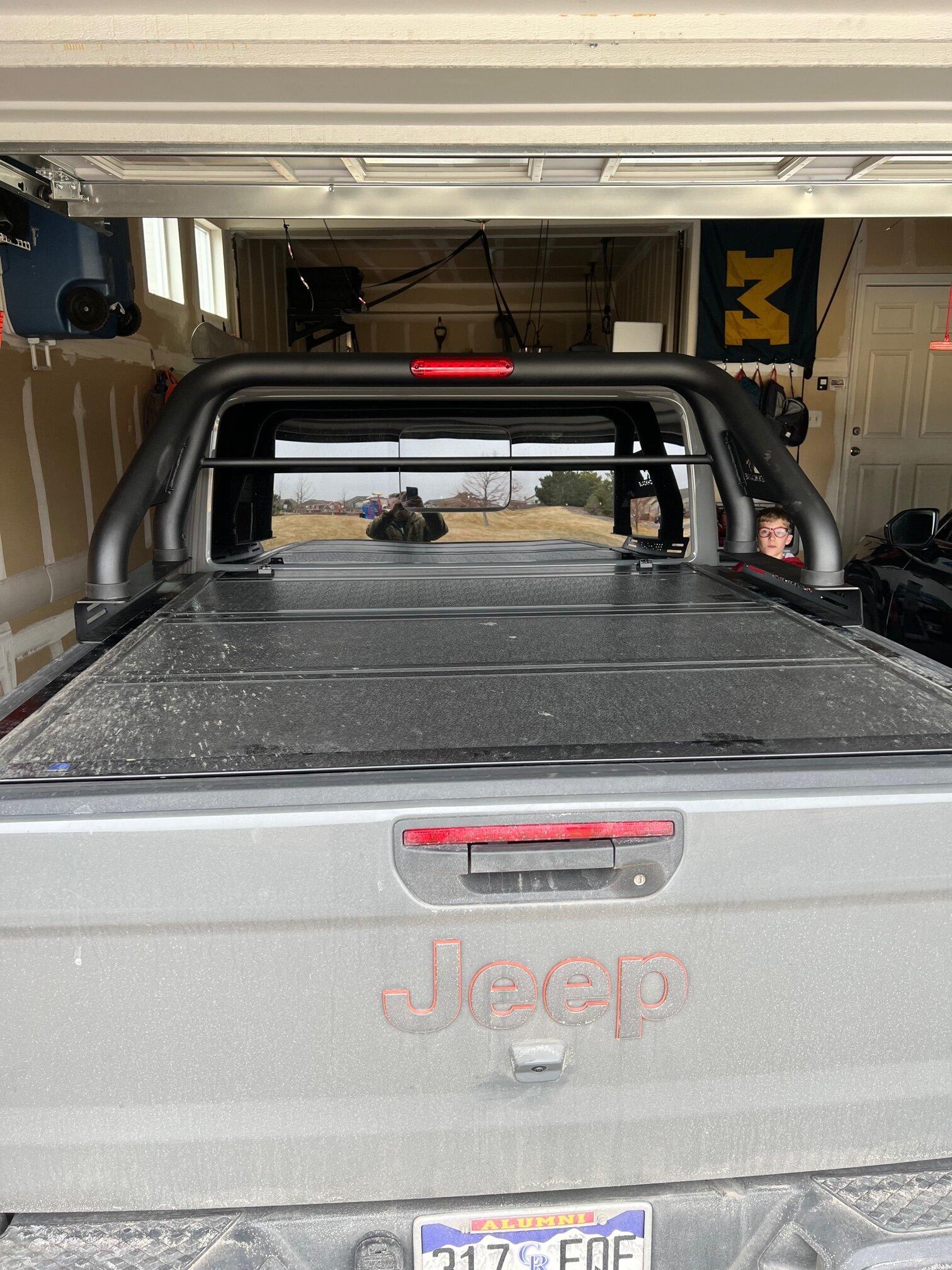

Update, I I have the Mopar tonneau cover on with the Black Horse roll bar. Getting the frame to fit over the roll bar brackets was dicey, but ultimately fine. Getting the tonneau on to the brackets was another story. It was pretty difficult to get it pushed all the way up through/past the roll bars. I'll post some pictures of what it looks like both open and closed.

Looks great!

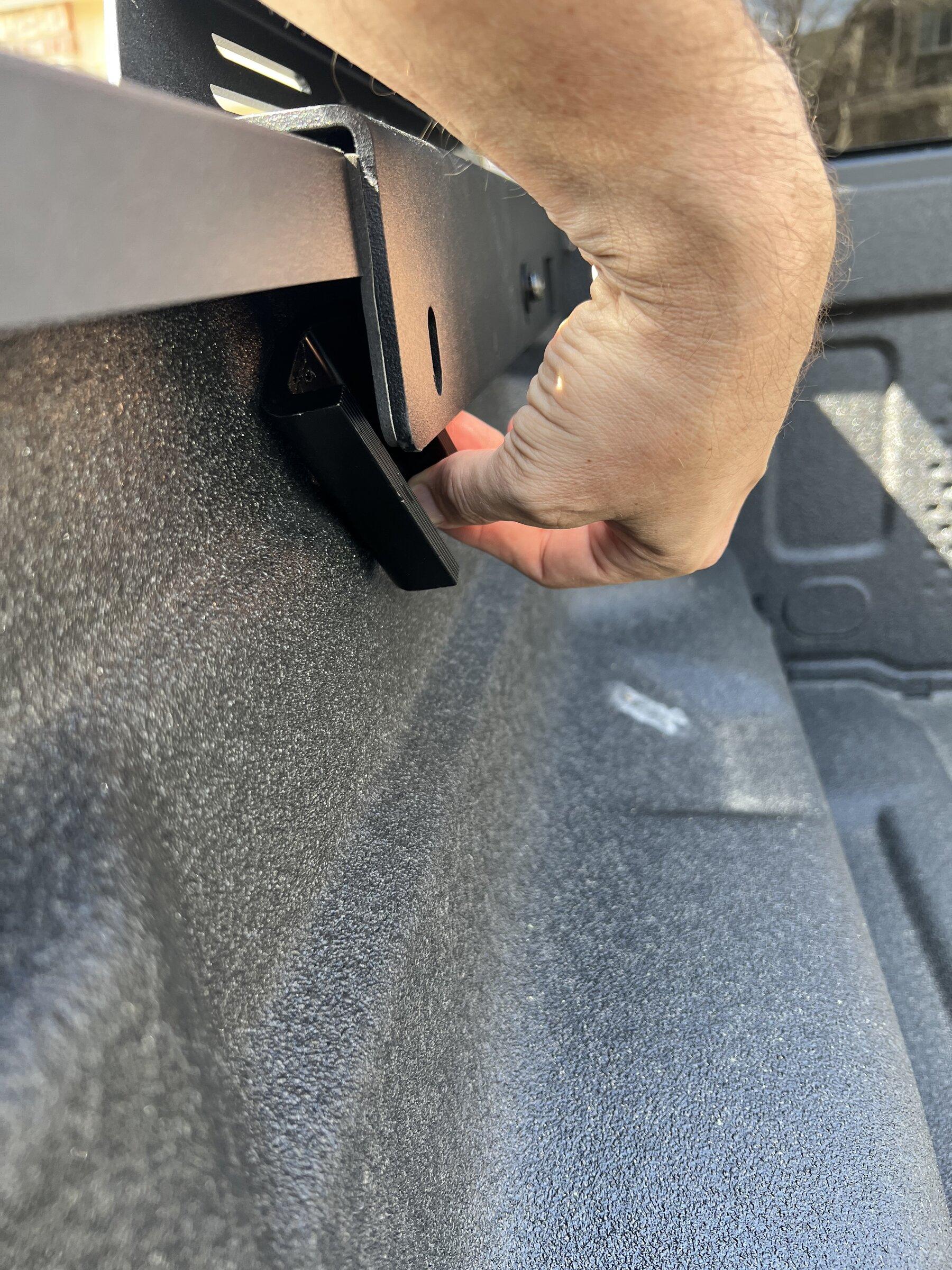

Can someone please tell me how they actually connected this to their bed?? The instructions say, “Assemble roll bar with base on the truck with standard parts 15,16,18, and 31”. This is the C clamps. Is this really just a messy matter of cramming these things up under the lip and cramping it dow??
Jeep Gladiator Black Horse Roll Bar Installed AA425ADA-B112-4C43-9A8A-E96ECDC56212
Completely agree, I would love some more pictures of the install and wiring of this rack. I love the way it looks, but the instructions are seriously lacking. This will be my first mod to my gladiator and I admittedly need a hand up.
