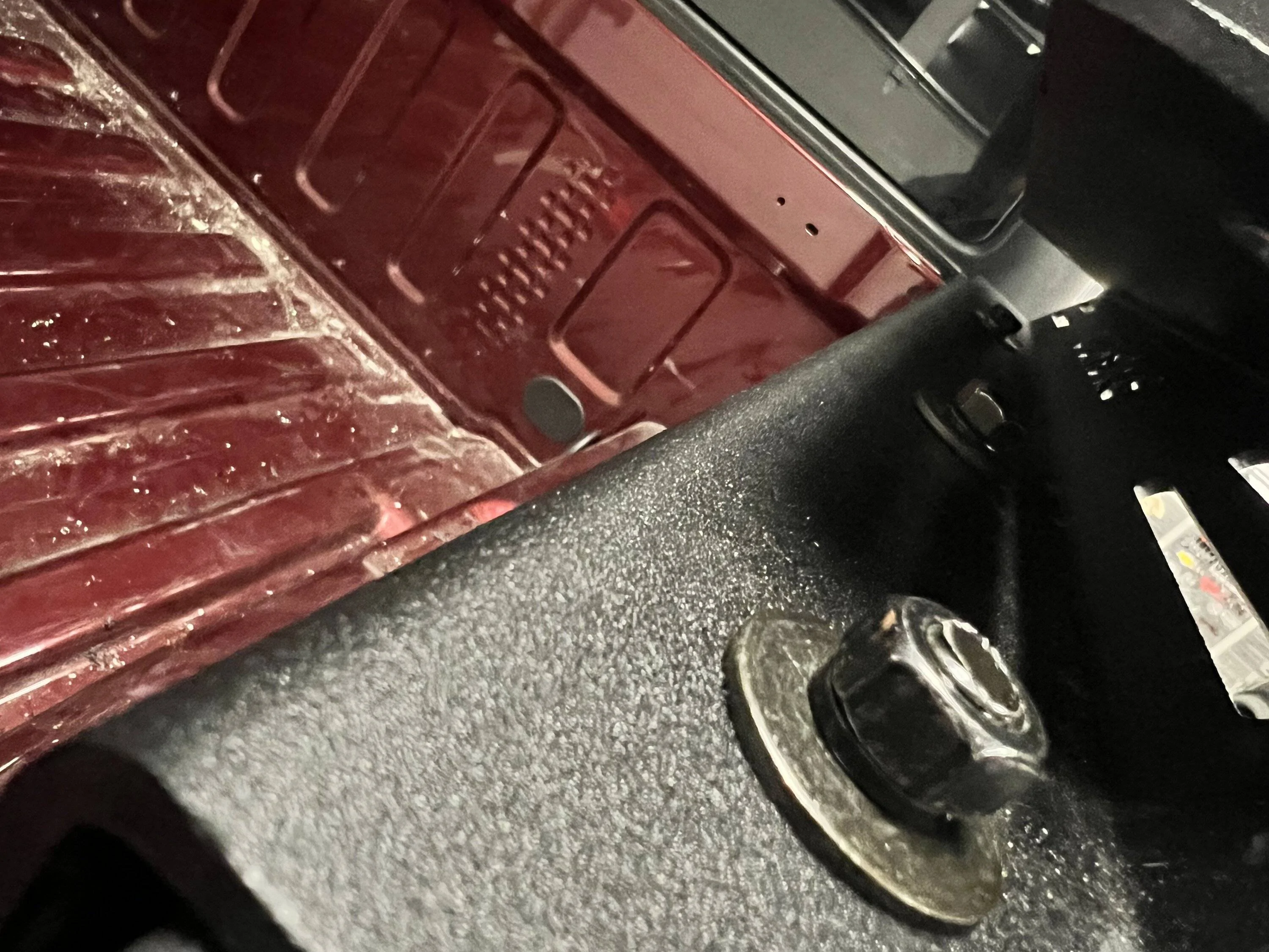

Alright guys, my method works pretty well for everyone who doesn’t trust the clamps..
First I drilled out 1/2” holes through the plastic bed rail cap down through the clips. It ended up being 3 clips in that area to go through in the back of the bed.
second I set the brackets down on top of the bed rail where I wanted the bar to go. I reached underneath where the plastic clips used to be and used a red sharpie to mark the holes on the underside of the brackets.
Third, I took the brackets back off, turned them upside down and found the red marks and drilled holes there using a 1/2” metal stepper bit.
fourth, I put the rails back on, used the t-bolts that were for the trail rail system, pushed them up through the bottom, put a washer, lock washer and then nut on the top and loosely hand tightened them. The T-bolts work good under the bed rail to keep you from having to hold both ends to tighten the nut.
fifth, I put the bar back on top and connected it to the brackets, again loosely.
Lastly i moved everything around to where I wanted it to be as much as tolerances would allow, then tightened everything up. Like I said, it’s nice using the t bolts because you don’t have to fumble around blindly looking for the other side with some cursed Allen wrench to hold the thing to tighten it.
you can even put the clamps back, and tighten those if you want even more security.(I did) You can only use the middle and cab side slots though. The front is obstructed by the T bolt.
the only problem is that this would interfere with a cover due to the bolts on the rail. Mine goes on ok, but eventually I’m going to get some low profile hardware so it functions better.
Jeep Gladiator Black Horse Roll Bar Installed 6D949631-BAF0-47E2-A3E7-09232C411F3A
edit: I forgot to mention to be very careful tightening these down. If you hulk out on them, you can bust the plastic Bed rail cover that’s sandwiched in there.

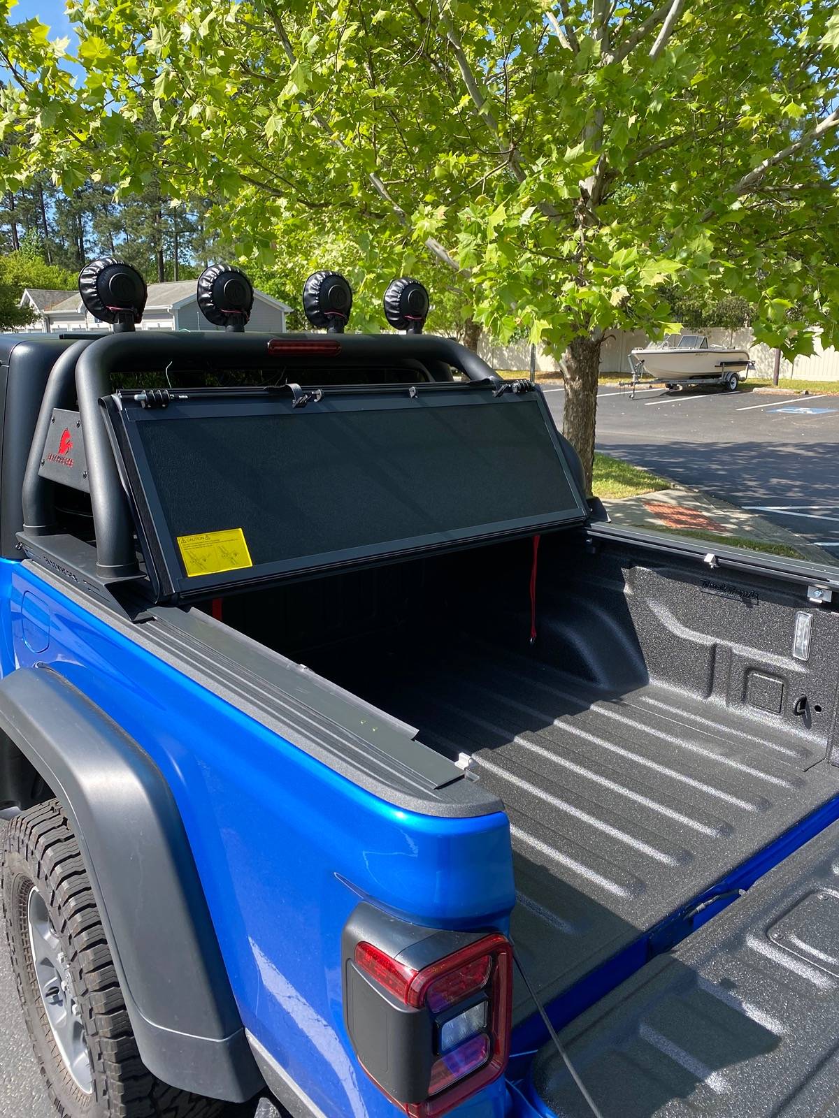

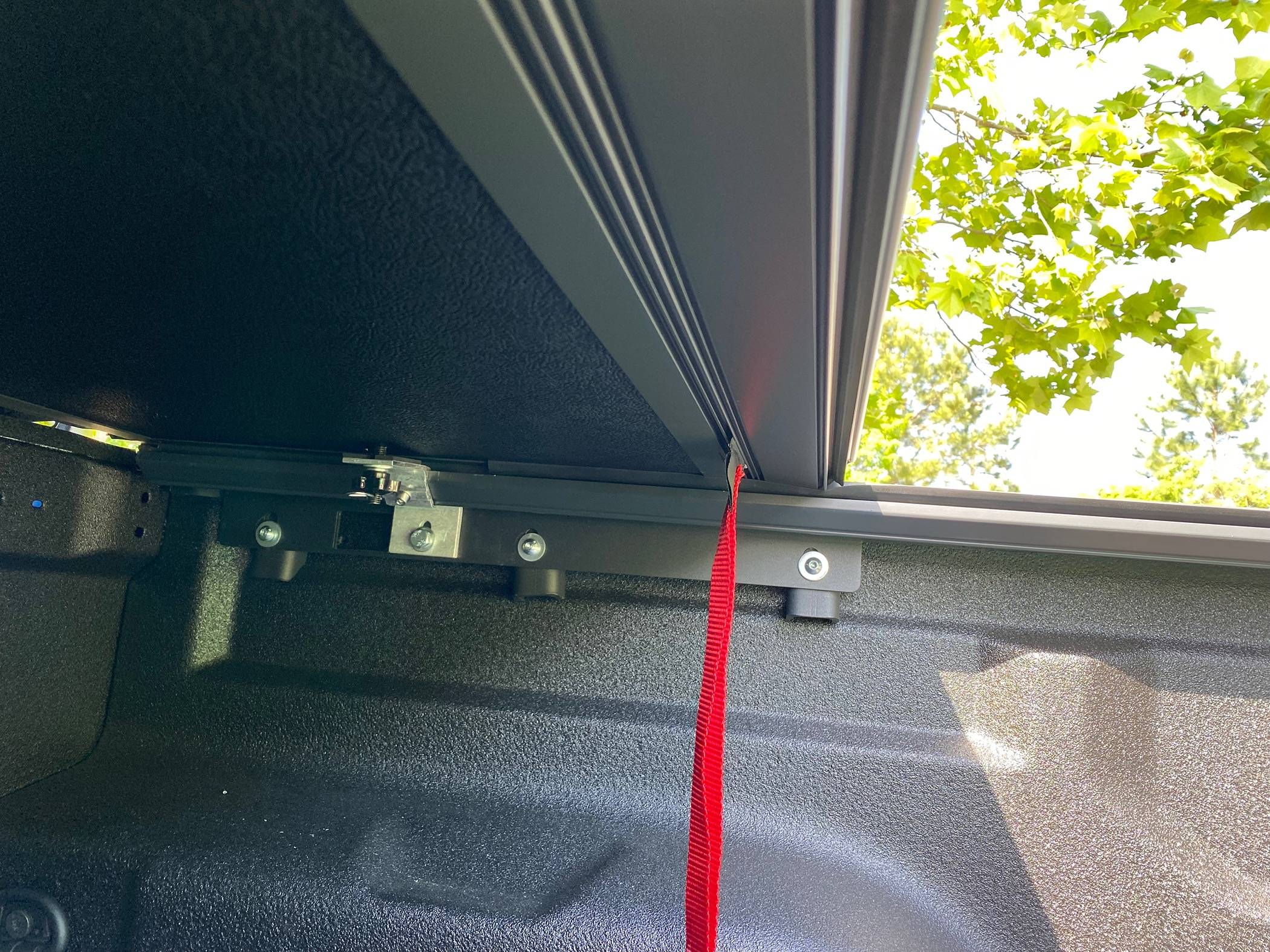

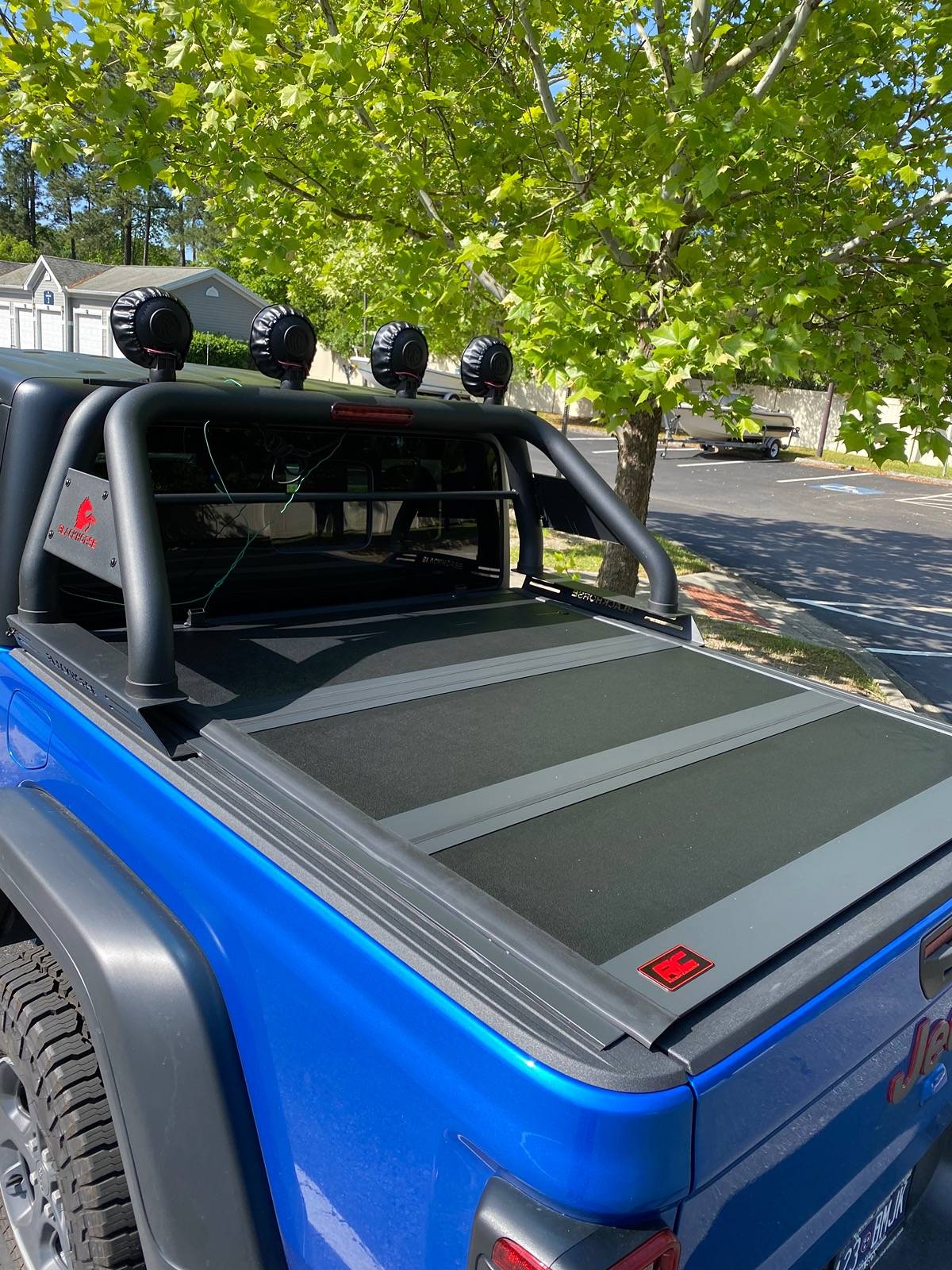

For the front bracket on the roll bar; I chamfered the lower corner to clear gas filler bulge. I installed the Rough Country low profile hard trifold cover. For the cover; I drill into the roll bar base to get the front two brackets installed. Had to add extra weather strip on the front of the bed.
