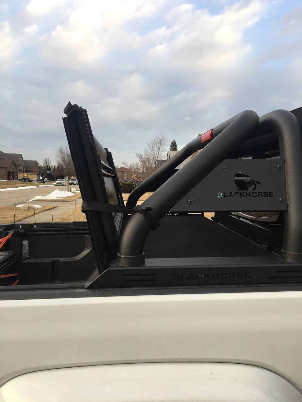

I would have to imagine anything similar in size / thickness to a soft tri-fold will work. I have the blackhorse original light bar and a rugged ridge tri-fold soft cover that works just fine. If I were to do it again, I'd go with a roll up cover. The tri-fold is nice, but the 2nd fold you have to tie up to the light bar because the light bar base interferes with the cover.

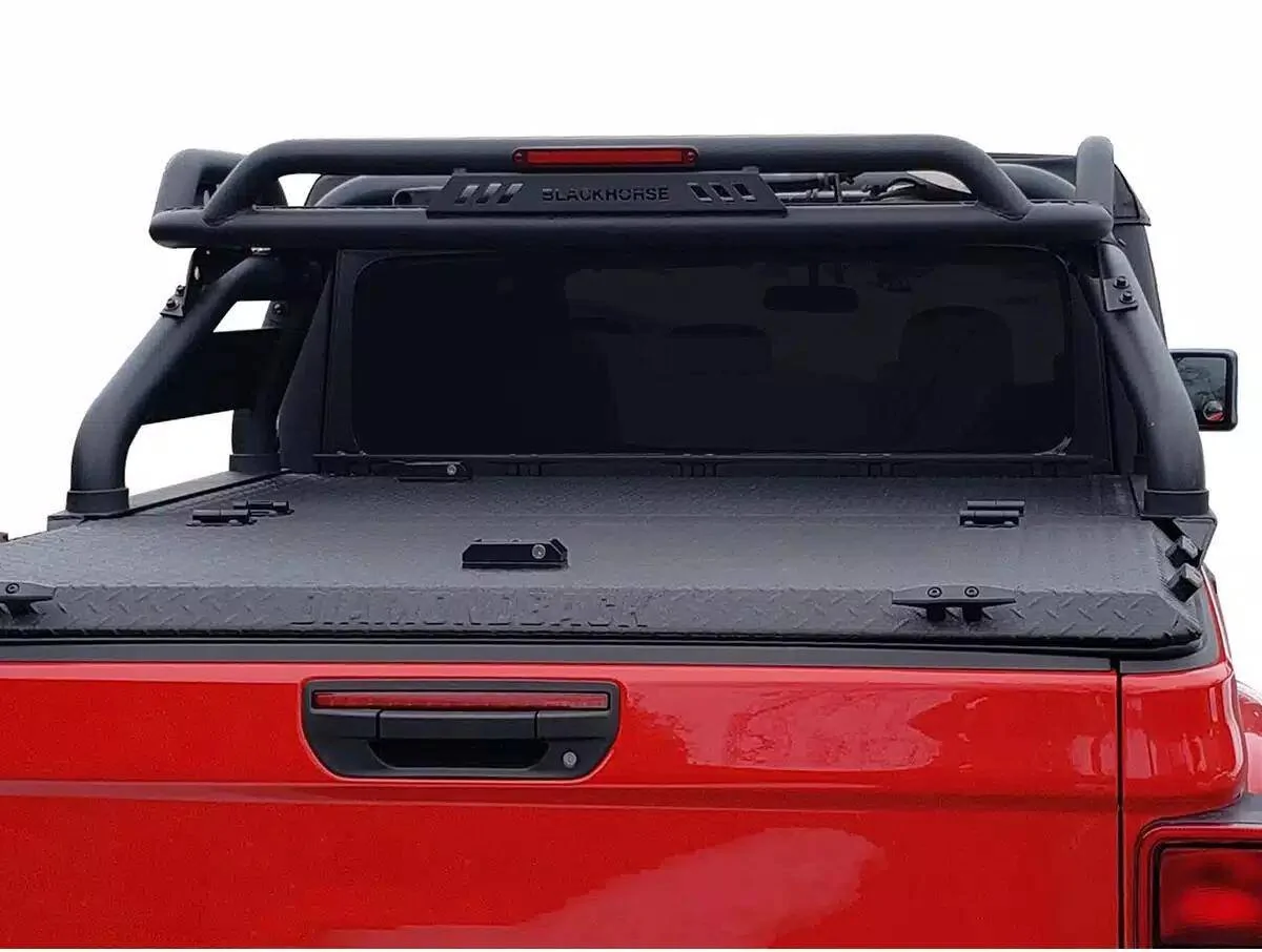

Black Horse states that the ATLAS is compatible with any tonneau cover. However, like you mentioned, a cover that allows for full bed access may still be impeded by that top rack on the roll bar, and the C-channels you mentioned would keep that first panel in place as well. They feature a DiamondBack Cover with the ATLAS, so it's a safe bet that they work together.

I can only fold 2 sections up on my tri fold cover and that's with the Black Horse classic roll bar. I then have to use the straps to tie it to the light bar.

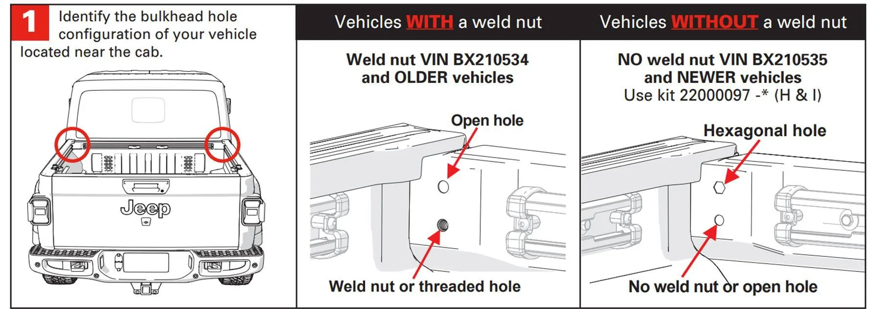

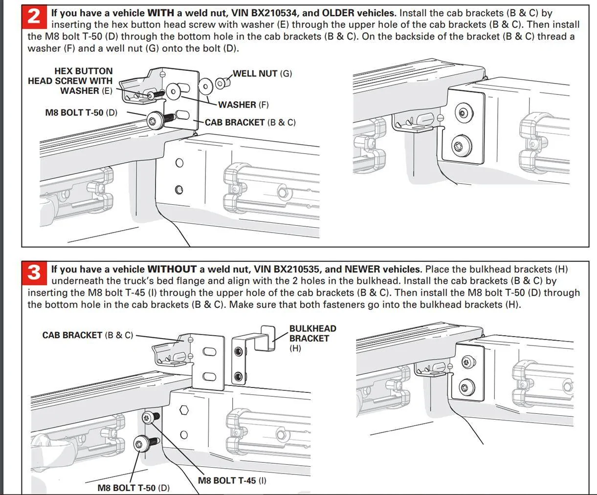

My bed cover (which I have to think is like most of the others) clamps down on the front of bed at each corner. You may have to put a "L" bracket between the bed and cab depending if you have the weld nut or not. Mines a 21 (built in Aug or Sept of 2020) and I had to get the brackets from Xtang (my Rugged Ridge didn't come with them). Xtang is the parent company who makes Rugged Ridge's tonneau covers.
I will say It wasn't fun trying to lay in the bed with the LIght bar installed and having another person try to hold the L brackets in place. while I tried to thread the bolts in.
Hope this helps
Todd
