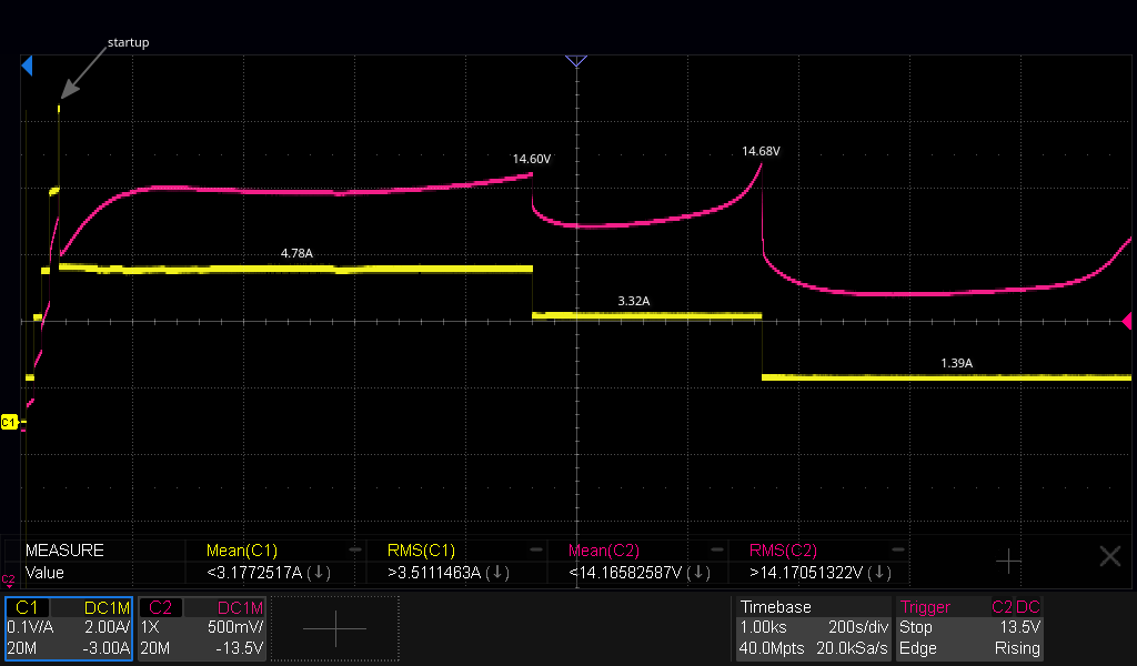

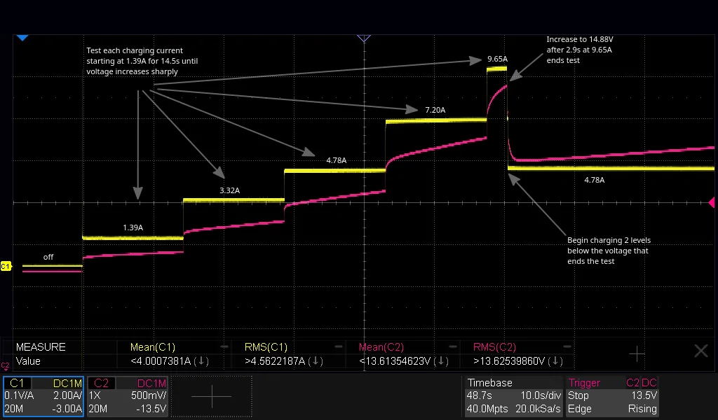

At startup, the NG10 tests currents for 14.5s each, starting with 1.39A and increasing until it sees a sharp rise in voltage. It starts charging about two levels below that. If it gets to its max current without voltage spiking then it stays with that.
The charger undoubtedly uses other factors to determine transitions between currents. Time limits, for one. But that's the general shape of it. Let's see it in action.
The JT sat for 2 days. I turned on the headlights for 8 minutes, waited an hour for it to go into its deepest sleep state and plugged in the NG10. The first 100 seconds shows the startup sequence.
Jeep Gladiator Charger pr0n: NOCO Genius10 battery - measured data & review T0_1a
This was actually the start of a 2000-second capture.

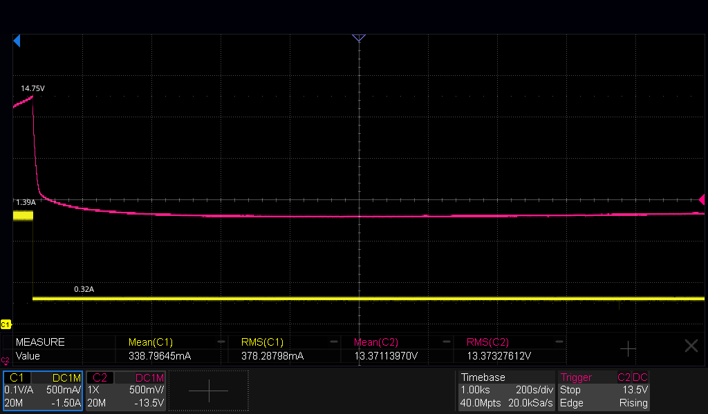

I barely caught the next step down, to 0.32A at 14.75V.
Jeep Gladiator Charger pr0n: NOCO Genius10 battery - measured data & review T1a

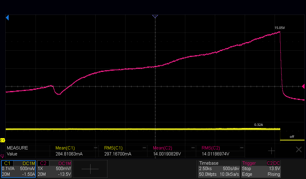

It took another 5000s at 0.32A to finish, at 15.05V.
Jeep Gladiator Charger pr0n: NOCO Genius10 battery - measured data & review T2a

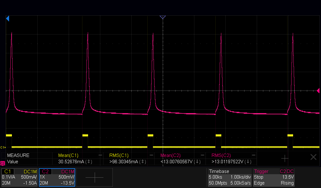

Subsequent re-ups all have the same shape, but they get shorter and more frequent. It takes less time at 0.32A to get to 15.05V, and it remains above 12.875V for a shorter time.
After two days of this, the re-ups are happening every 45 minutes and lasting only about 3 minutes.

  4. The voltage goes higher than I would like, 15.05V at 50-55F. I also observed 14.64V at ~95F and 14.75-14.80V at ~85F. One end of the charger gets hotter than the other so the temperatures involve some guesswork. The OEM battery has a sticker:
    Jeep Gladiator Charger pr0n: NOCO Genius10 battery - measured data & review limit.charge.voltag
    I'm not crazy about a maintainer that pulls my battery up to 15V about 30 times a day.

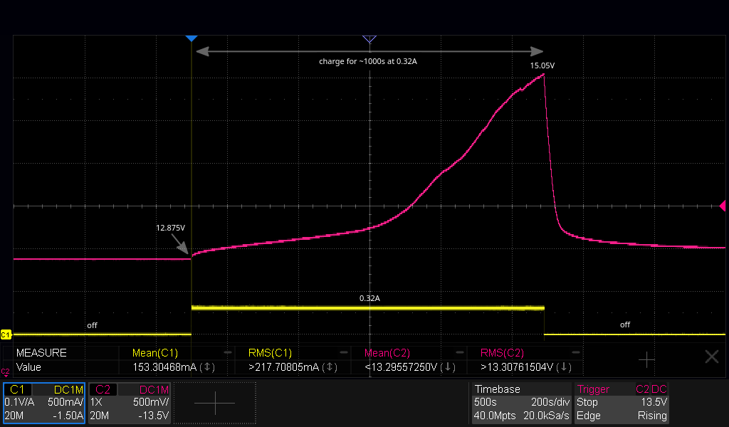

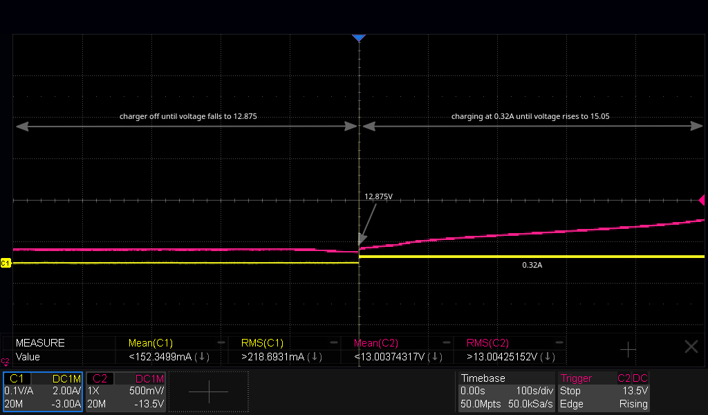

  6. The NG10 has no float stage. It turns off completely until the battery falls below 12.875V at 50-55F. The voltage threshold does not appear to be temperature-compensated.

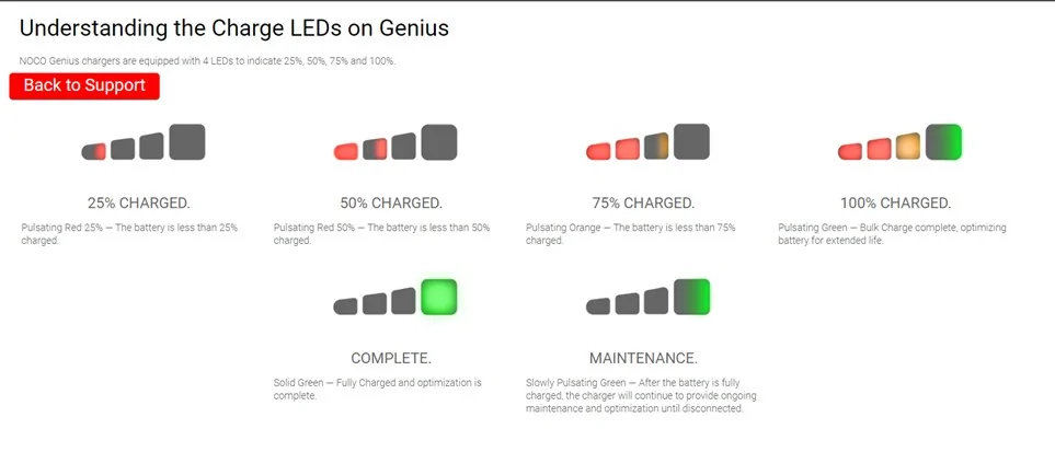

Thanks for your detailed analysis on the NOCO Genius 10. I have a Genius 10 that I do not use often. I find their operating manual to be somewhat confusing regarding what the LED light status is trying to tell you.
I had to dig this out of the support section on the NOCO website to get a better understanding:
Jeep Gladiator Charger pr0n: NOCO Genius10 battery - measured data & review Charging Lights
I have never seen the Genius 10 "Complete" a charge, although I have seen the "maintenance" mode. I have to assume that the Genius 10 completed the charge and immediately switched into maintenance mode.
