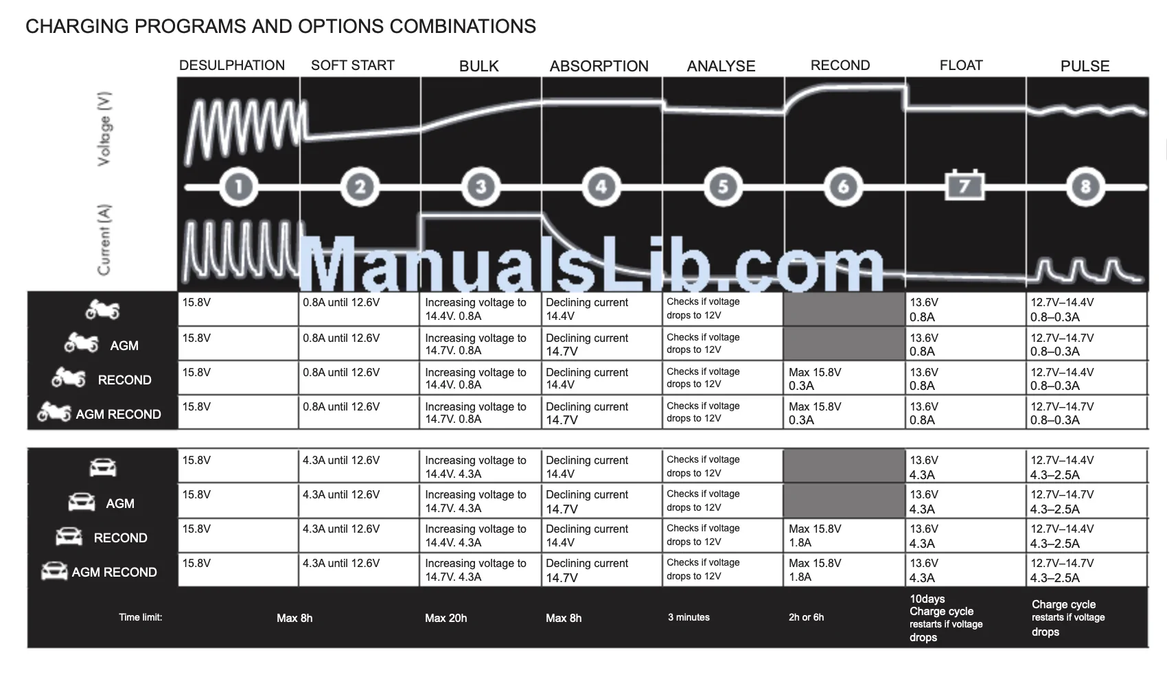

I was looking at the CTEK MXS 5.0. Two things I was wondering about:
1) The desulfation voltage/process. It spikes it up to 15.8 volts at "high" frequency. For the experts out there, is this process okay for the Jeep electronics when charging with the battery connected?
2) I wonder which mode to charge with. AGM mode charges to 14.7V. The standard battery mode charges to 14.4V. Seems wrong to choose "standard" when it is an AGM battery but the battery says right on it to not charge past 14.4V.
I plan to use this charger mainly to keep the batteries in my TJ and Ram topped up, topping them up once a month or so depending on how much they get driven, but I also want it for my Gladiator for if/when it needs it. It is in my shopping cart and I'm close to clicking "check out".
AGM mode. Even the Jeep goes well over 14.4
I've seen 14.9 to 15 before.
Thanks. What do you think of the desulfation mode and 15.8V spikes at some unknown frequency?
I've never had a battery damaged and very short spikes don't heat it up like long stints at high voltage.

I am more concerned about what the Jeep electronics might think of it when charging with the battery connected. It is probably not a concern or else CTEK would have dire warnings in the user manual, but automobile electronics seem to be more finicky and fragile than they used to be.
They should be regulated..... they'll never internally see the system voltage.
