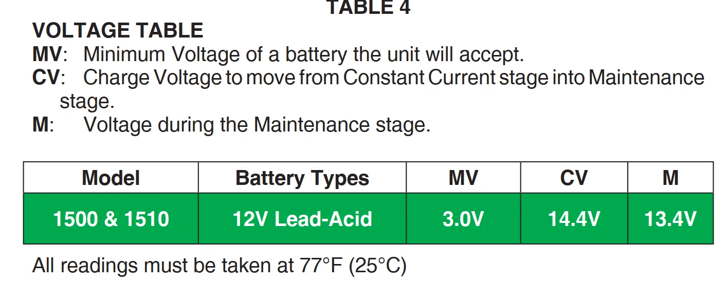

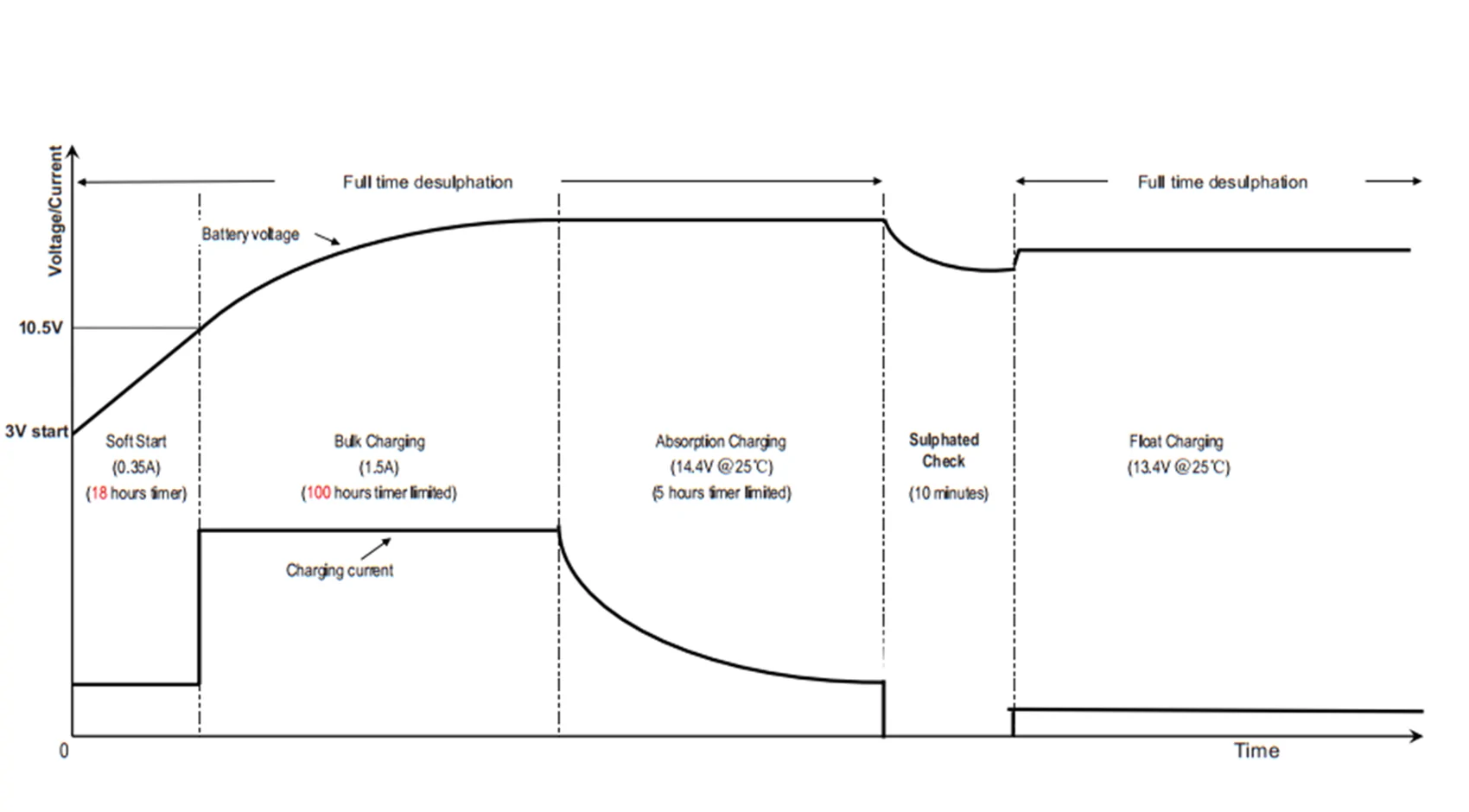

for normal routine used to keep mine topped up, the BatteryMinder 1500 works well (1.5 amps but if it's really low, it can take a day or two, depending on battery)
It also tops off at 14.4 volts and is not for lithium batteries.

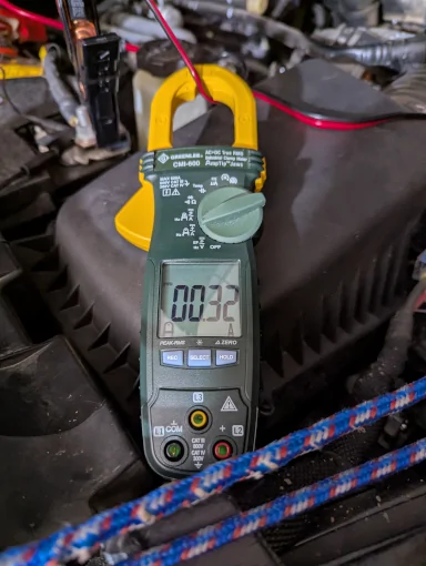

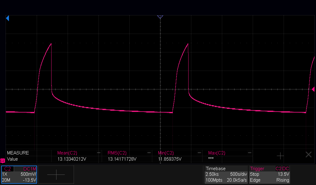

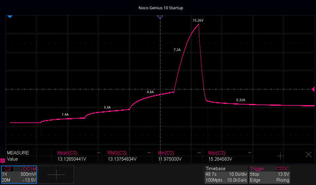

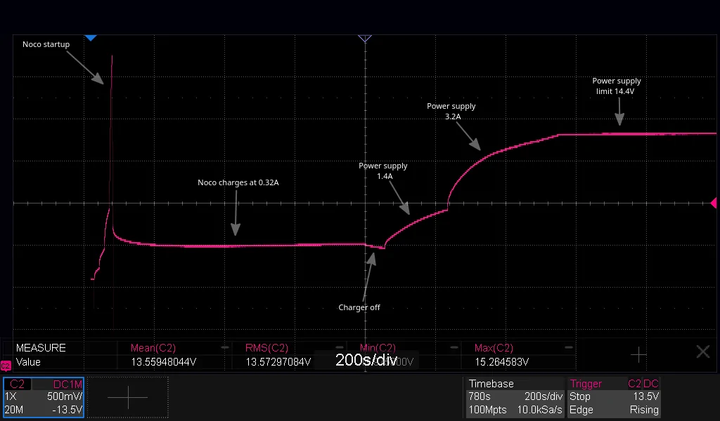

I gave the Noco Genius 10 another shot, hoping to see it output more than 3.2% of its rated current in my normal use. Spoiler: It didn't.
This time the JT had been parked for 8 full days since last driven, untouched except to open the hood on day 5. I expected the Noco would charge at 3.3A or higher for a few minutes, then spend quite awhile at 1.4A before dropping to 0.32A maintenance.
The Noco tested currents up to 7.2A but settled on 0.32A.
Jeep Gladiator Charger pr0n: NOCO Genius10 battery - measured data & review T0_1a
Jeep Gladiator Charger pr0n: NOCO Genius10 battery - measured data & review 320mA
I turned it off in disgust after 13 minutes and charged it with a power supply. When the power supply takes over, it's evident that the Genius 10 missed the chance to charge effectively.
Jeep Gladiator Charger pr0n: NOCO Genius10 battery - measured data & review T0_4a

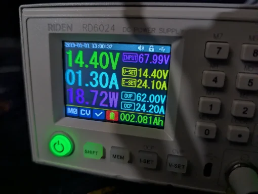

The battery accepted 2.0Ah in the first hour, without going over 14.4V.
Jeep Gladiator Charger pr0n: NOCO Genius10 battery - measured data & review 2Ah
The Noco Genius 10 would have taken 6 hours to deliver that charge.

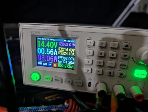

After 2 hours, without ever exceeding 3.2A or 14.40V, the power supply has put nearly 3Ah through the battery.
Jeep Gladiator Charger pr0n: NOCO Genius10 battery - measured data & review 3Ah
That would be 9 bowls of your cereal hours of charging for the Noco Genius 10.

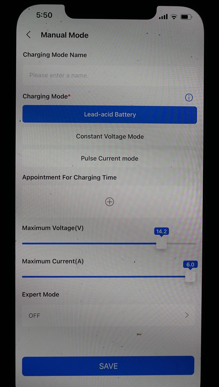

Smart charger with manual mode.

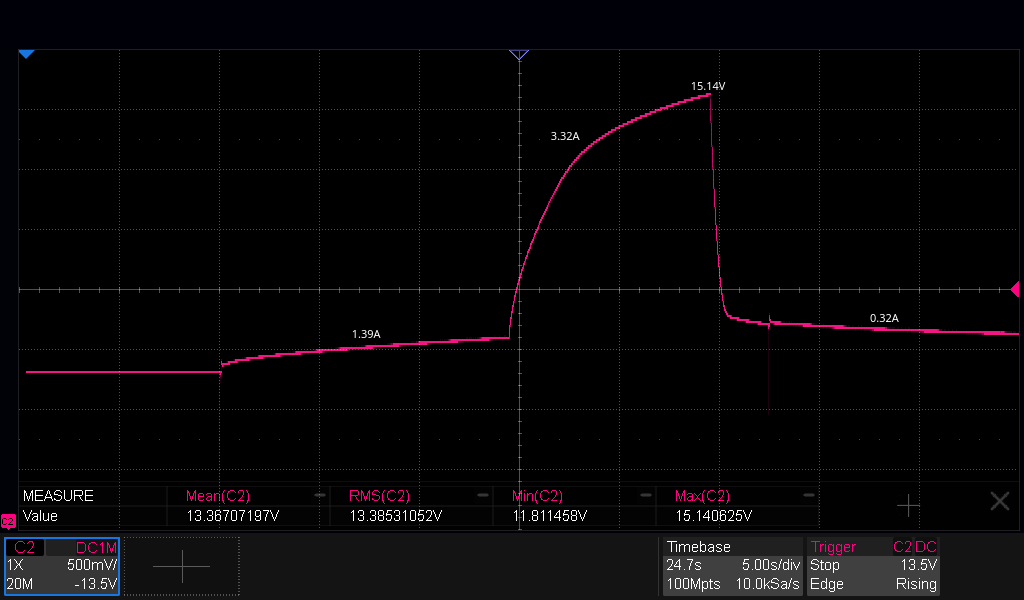

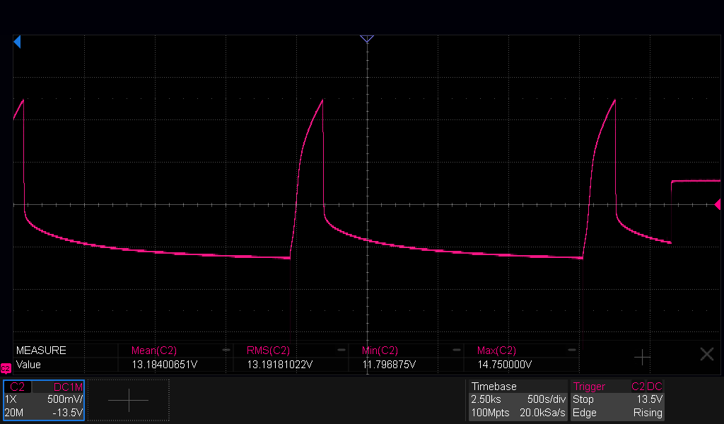

Can the Noco Genius 10, with its 0.32A minimum charging current, every fully charge a smaller aging battery? I'm used to seeing current taper down to one-tenth of that, 0.03A, or lower, in constant voltage charging.
With that question in mind, I gave the Noco Genius 10 one more chance before returning it to its owner. This is a 2013 Honda with a 5-year-old maintenance-free flooded lead acid battery. It's a small battery, about 30Ah.
The Hondas of that era have two alternator modes. Low is around 12.6V and high is ~14.4V. It seems to use the low setting most of the time, except for the first few minutes after starting or when there's a significant electrical load. Consequently, the 2013 tends to undercharge, and the battery takes 3-4Ah of charge every few weeks, when I remember to charge it.
The car had been driven normally since last charged two weeks before and was warm from just being driven. The Noco was at room temperature and set for regular 12V.
The Noco Genius 10 again settled on 0.32A.
As in the prior cases, the battery clearly would have accepted 1.33A for awhile. Noco has taken a conservative approach. Who buys a 10A charger expecting it to behave like a one-third amp trickle charger?

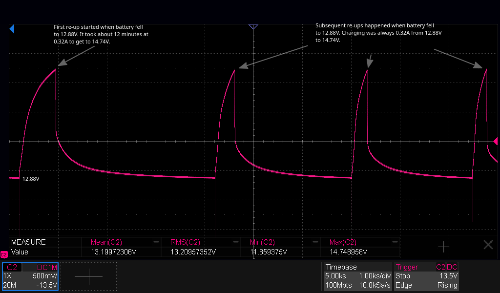

The cycle finally completed after about 8 hours.
Jeep Gladiator Charger pr0n: NOCO Genius10 battery - measured data & review T1a
The first re-up was about 2 hours later, followed by three more at shrinking intervals.
Jeep Gladiator Charger pr0n: NOCO Genius10 battery - measured data & review T2a
Four more re-ups. Note the different time scale.
Jeep Gladiator Charger pr0n: NOCO Genius10 battery - measured data & review T2_2
Jeep Gladiator Charger pr0n: NOCO Genius10 battery - measured data & review T2_3
After 20 hours and 8 re-ups, the Noco had still not charged the battery completely. It claimed to. The light was solid green when I disconnected it.

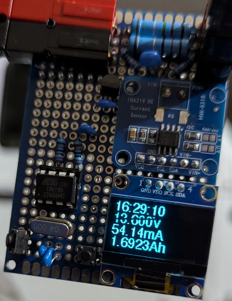

16 hours with a Victron Blue Smart IP22 in power supply mode at 13.6V put another 1.6Ah through it. Maybe half of that is net charge to the battery, but it's still 2-3% of capacity.
Jeep Gladiator Charger pr0n: NOCO Genius10 battery - measured data & review 1.6Ah
Not only did the Noco Genius 10 fail to fully charge the battery, it was not on a pace to ever get there. The average charging current after the light first went solid green was around 33mA (cycling on for 4 minutes at 0.32A and off for 35). The quiescent draw with the hood latch open is 28mA.
