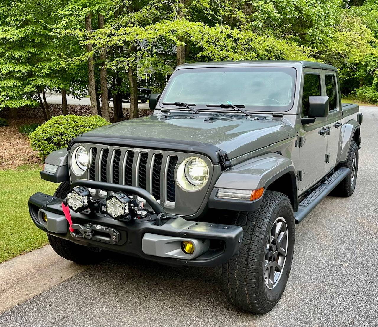

Clay bars are an abrasive - there are various grades, but they are all abrasive. Some of the detailing forums will have something to say LOL
It's not supposed to be a fix before a final coat.
From one forum -
While the clay bar removes contaminants, it does not remove scratches or imperfections in the paint. Polishing is a separate step that uses abrasive compounds to smooth out the paint's surface.
But I see so many that use it as the final step before something like a ceramic wipe or whatever.
I wasn't doing it for scratches only embedded debris/dirt that made the surface rough. Paint itself is nearly mint condition. Had some sort of over spray from a truck going down the road.

I always thought it was clay bar, then polish, glaze, wax. Thought the clay bar was to remove contaminents so they didn't get rubbing in when polishing. Either way, looks great. Need to do mine now that spring has arrived.
That's what is talked about in the detailing forums - the clay bar is abrasive, various levels like there are various levels of sandpaper - but the main purpose is to remove contamination from the surface of the paint so it can be polished then sealed.
That's my understanding from digging into the detailing forums, anyway, while trying to decide what to do with mine.
I may see about clay bar for my Eagle, then go from there. Need to make it last even though I'm done with the judged shows with it.

Good for you, If you want to test the effectiveness, do a section with clay - then take the clear wrap off a cigarette pack put over your fingers and feel each section; you will be shocked at how rough the not clay section is.. I've clayed my vehicles for over a decade prior to any wax; now I use Meguiar's Hybrid Ceramic Wax. After the 1st year usually just wash & re-apply the Meguiar's.
That’s correct. Although, contaminants don’t really hurt the paint when polishing. It’s just good to remove them and your paint will look better. I also don’t know what you mean by glazing.

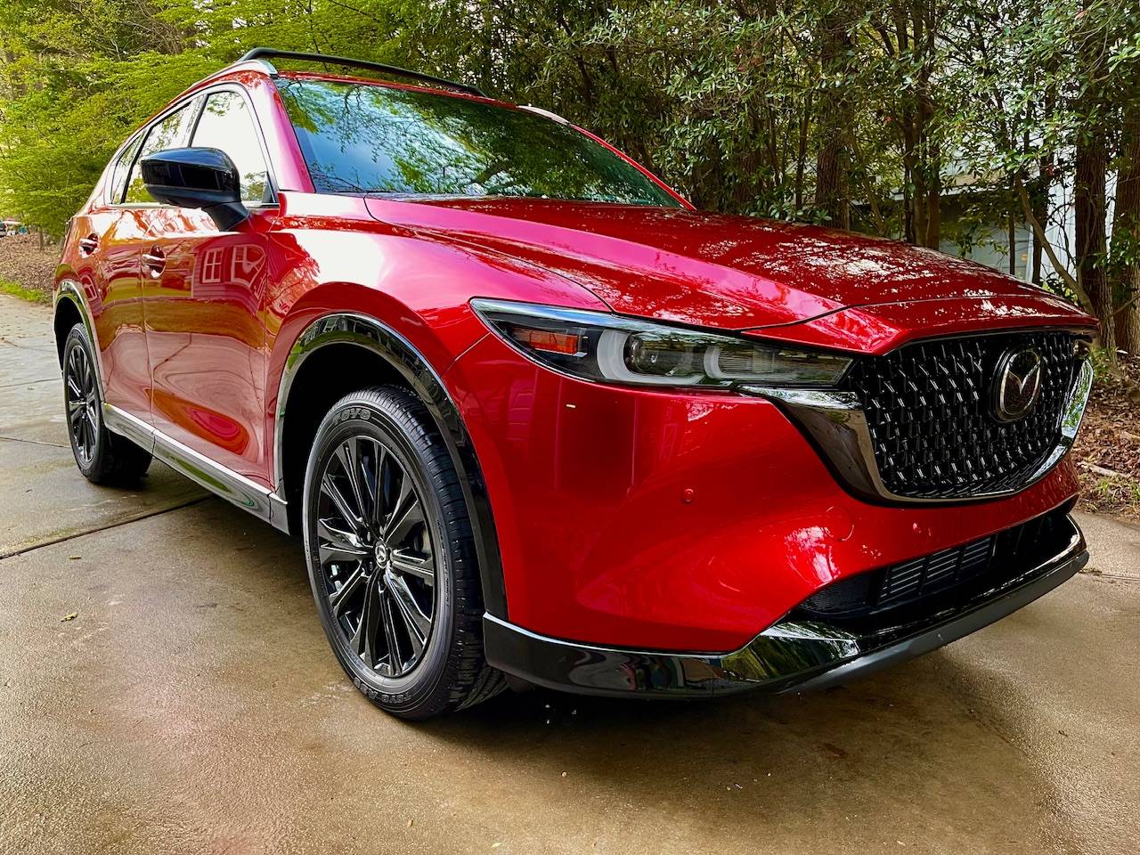

This is clay bar then some light wet sanding, a few different levels of compounds and then polish. I used old school hand applied paste wax over it because I swear it lasts longer than anything I’ve used. I think put spray ceramic on it because it helps to keep dust off of it. I had to do all of that because it’s always loved outside, it’s 5.5 yrs old, I use it as a work truck, and it’s been over three years since it’s had anything more than a wash every few months. That’s about as good as you can make Sting Gray shine. I love the color of my Jeep, but it’s just not that type of a color. Now the Soul Red on the girlfriend’s car is a different story. It’s fun to polish. It glows. Pics don’t do it justice.
