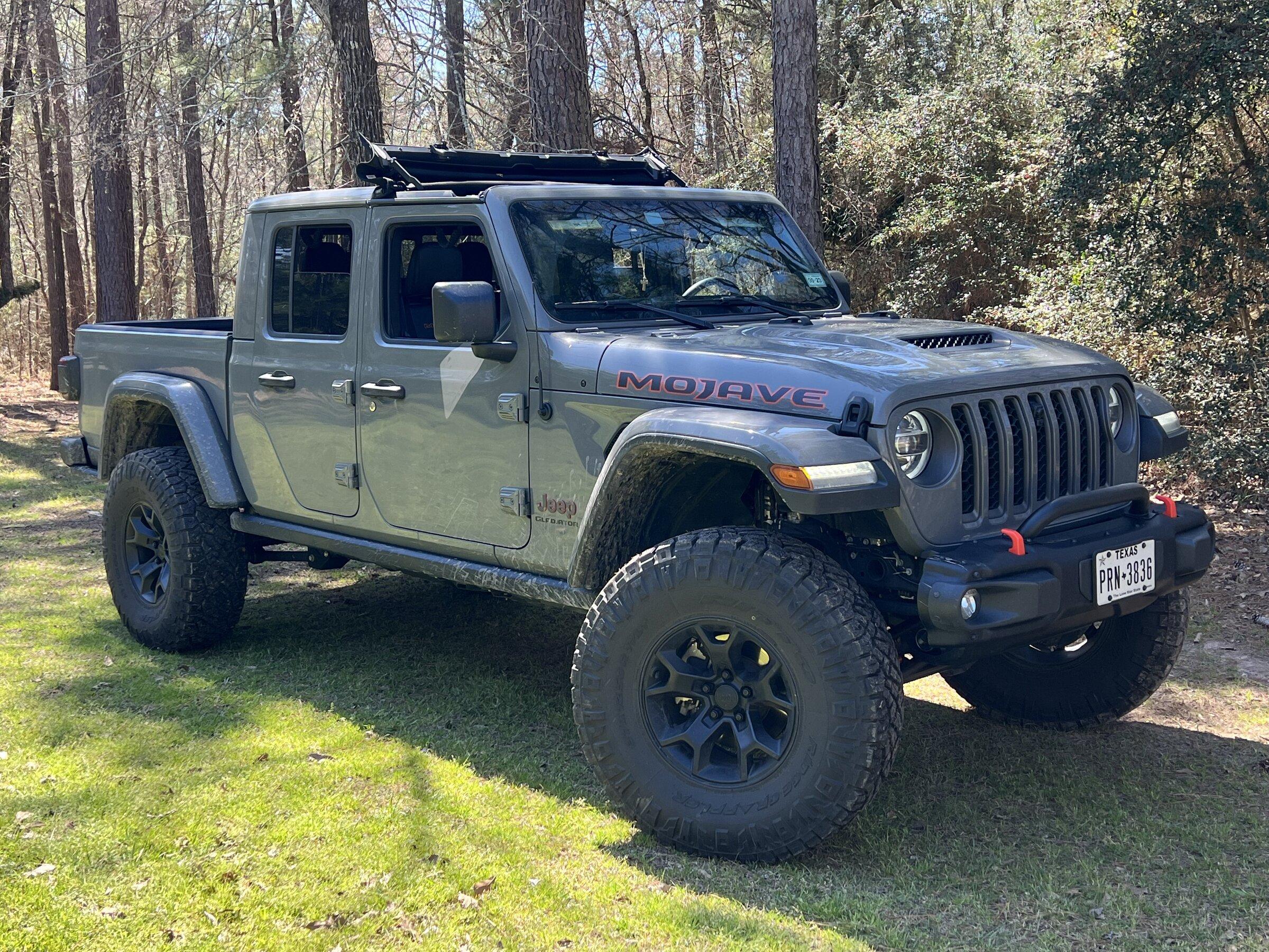

Installed mine a few days ago. Install was pretty easy, just took some time. I recruited my kiddos to help me install the springs. Entire install took me about 11-12 hours, but I took a lot of old fat man breaks! I added the adjustable front lower control arms and Claytons bump stops. Zero issues for the last 500 miles. I had my alignment checked and the only adjustment I needed was my right front toe.

Looks great! What size tires are you running?
