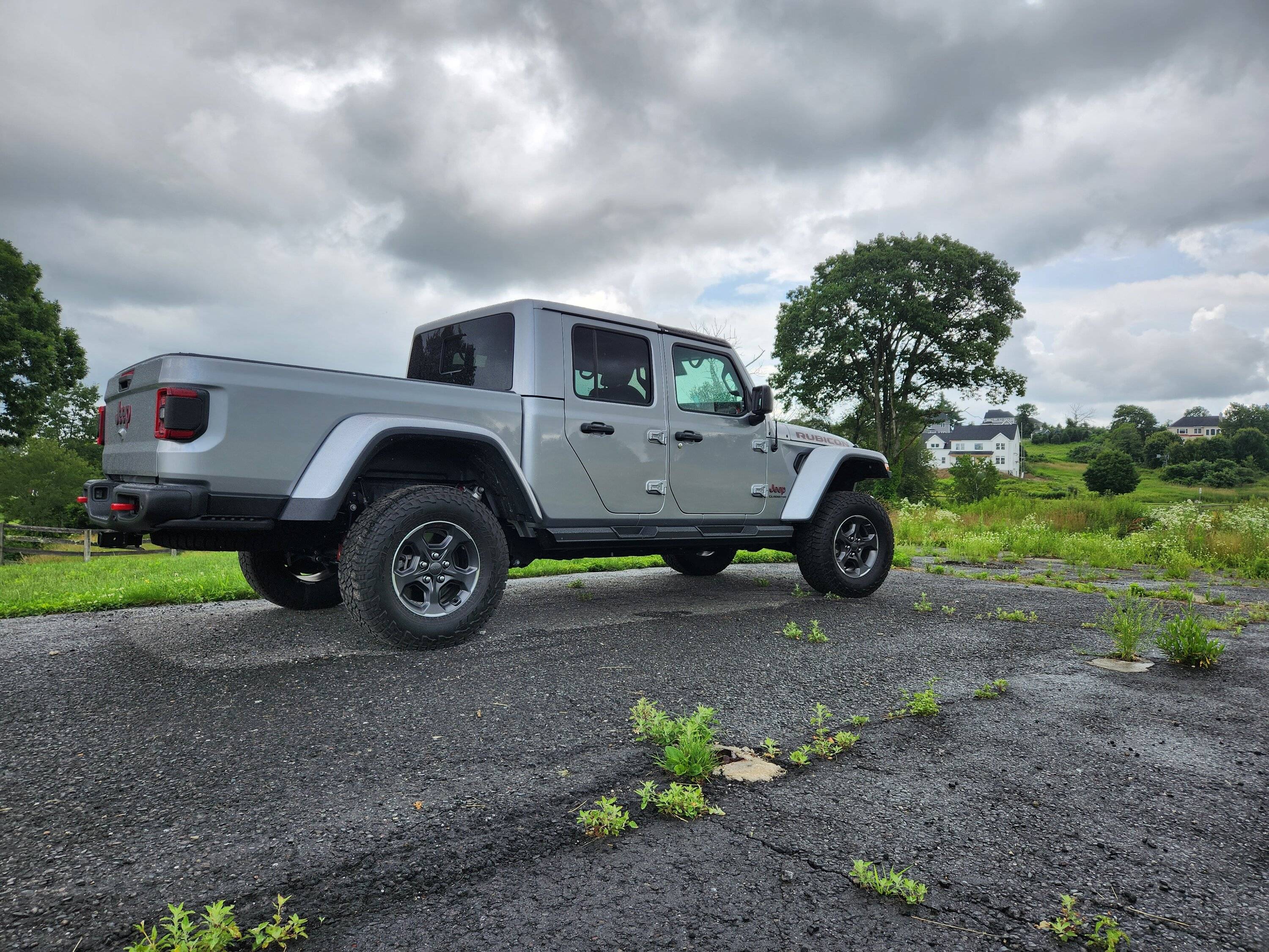

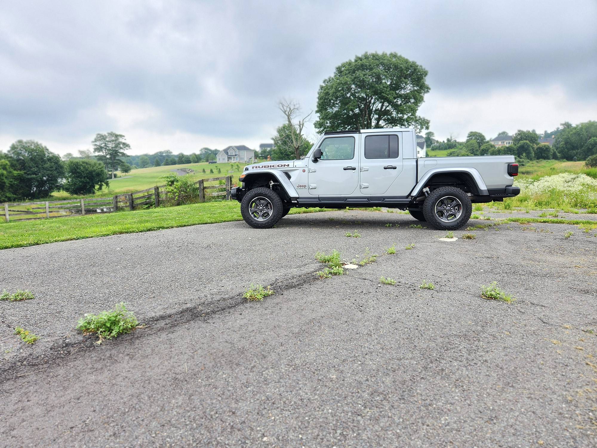

Jeep Gladiator Clayton Off Road JT Suspension Systems 20230704_120016
Jeep Gladiator Clayton Off Road JT Suspension Systems 20230709_104352(0) fixed

Full 1.5" systems are now available for the JT! This includes our popular Overland Plus kits, Premium, and Ride Right. This is the perfect height for any Sport owners looking to run 33" tires, or Rubicons looking to run 35s!
If you already have one of our 1.5" leveling kits and wish to complete the lift to gain a little bit of height in the back, you can also purchase the rear components individually!
1.5" kits are also available in our Performance Packages for anyone looking to save a little bit on a bundle including shocks and steering :like:
https://www.claytonoffroad.com/products/vehicle/jt-gladiator-20
Dope! Ordering mine at the end of the month. Are the front springs on this kit 2.5” and rear springs 1.5”? Same as your others lifts with an inch more upfront?
So pretty much just like our other kits, you'll get about 1/2" over advertised height in the rear, and then in the front we remove 1" of factory rake, so this kit would sit at about 2" in the back and around 3" up front, but again this is just where that factory rake was removed so it sits a little bit more level!
Best thing to go by is desired tire size, so a Sport/Overland model would work best with this kit if they only wanted to run 33s, while a Rubicon would work best with 35s, hope this helps!

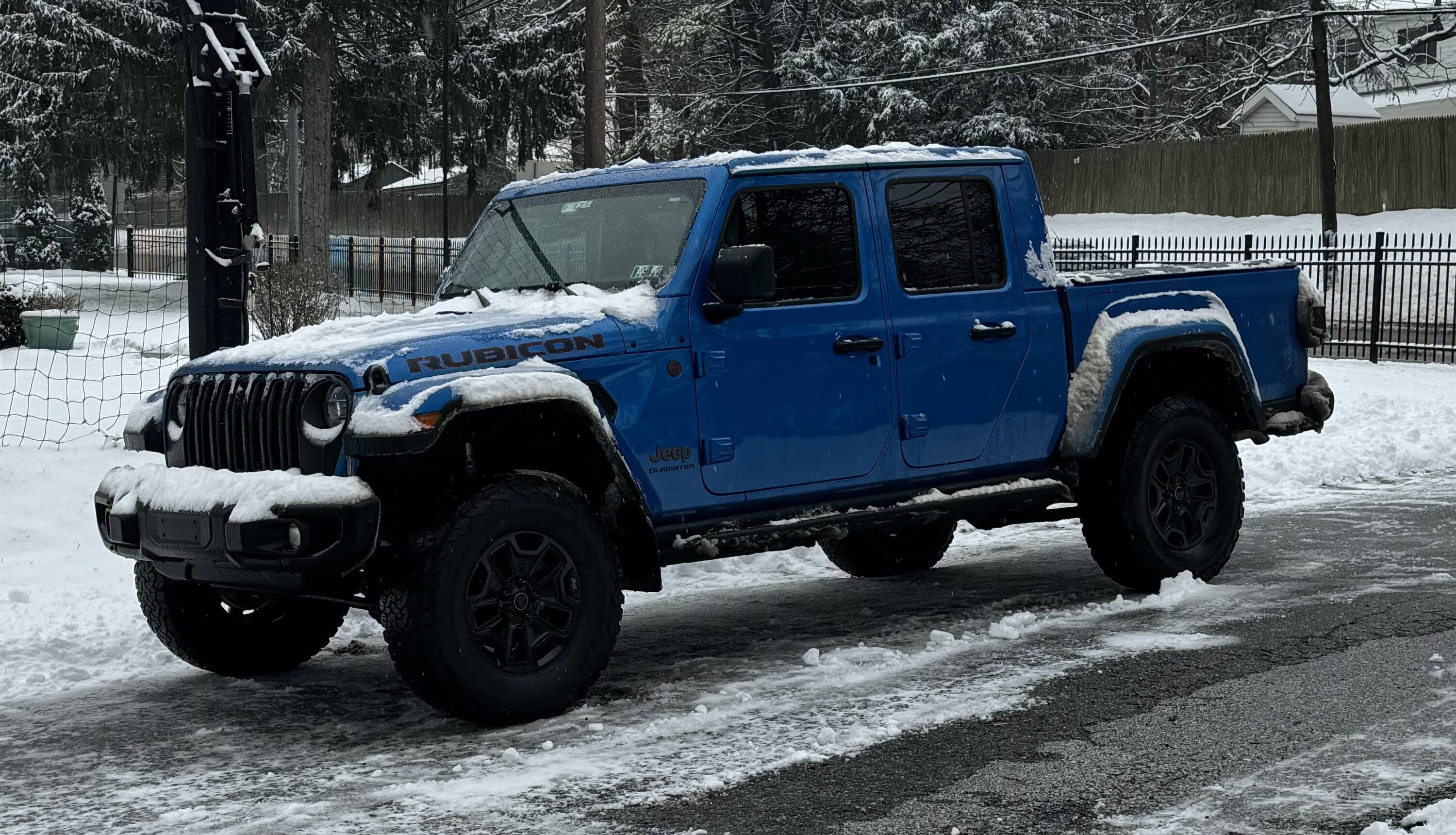

Main Line Willys
Ben
Feb 8, 2023
245
355
Wayne, PA
2022 JTR
Jeep Gladiator Clayton Off Road JT Suspension Systems IMG_0024
It’s not the best pic…
1.5 ride rite on BFG 285 75 17
