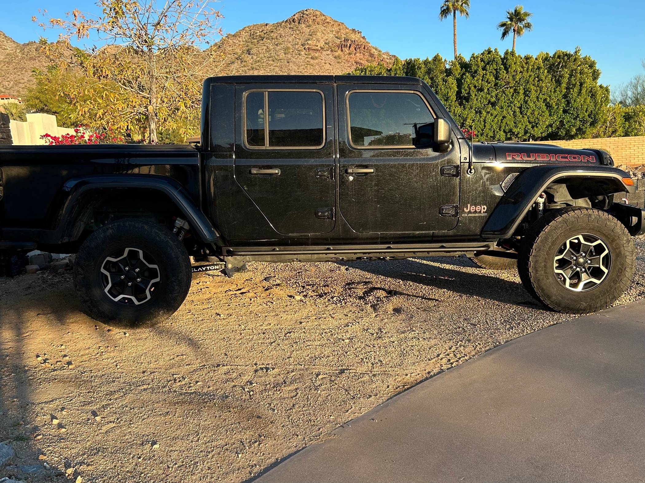

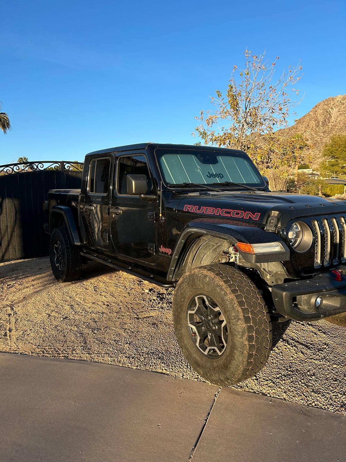

I can't help with the 1.5" Overland Plus kit and 35x11.50R17s but here is mine with the full 2.5" Overland Plus kit and 35x10.50R17s on OEM 392 JL wheels

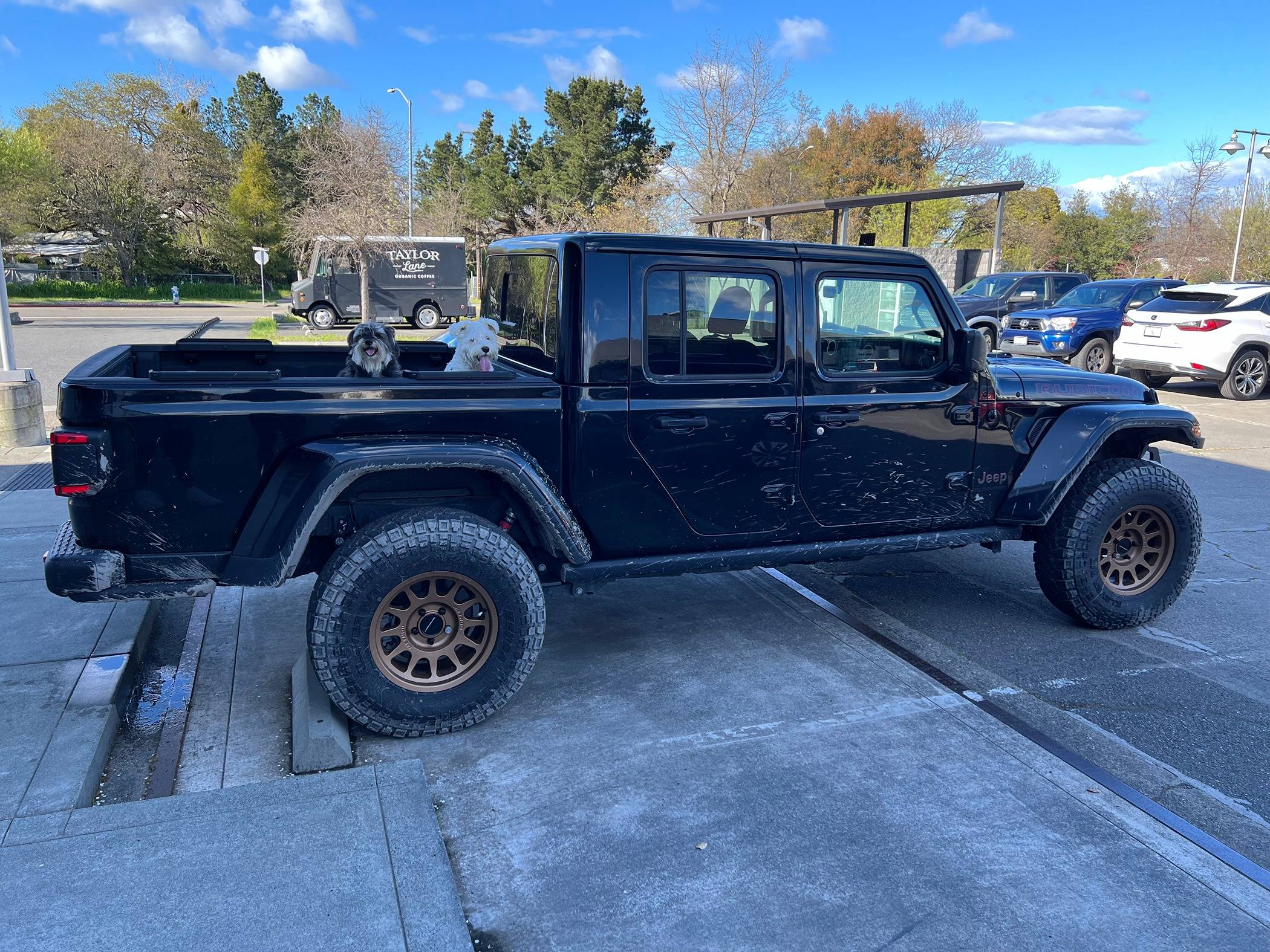

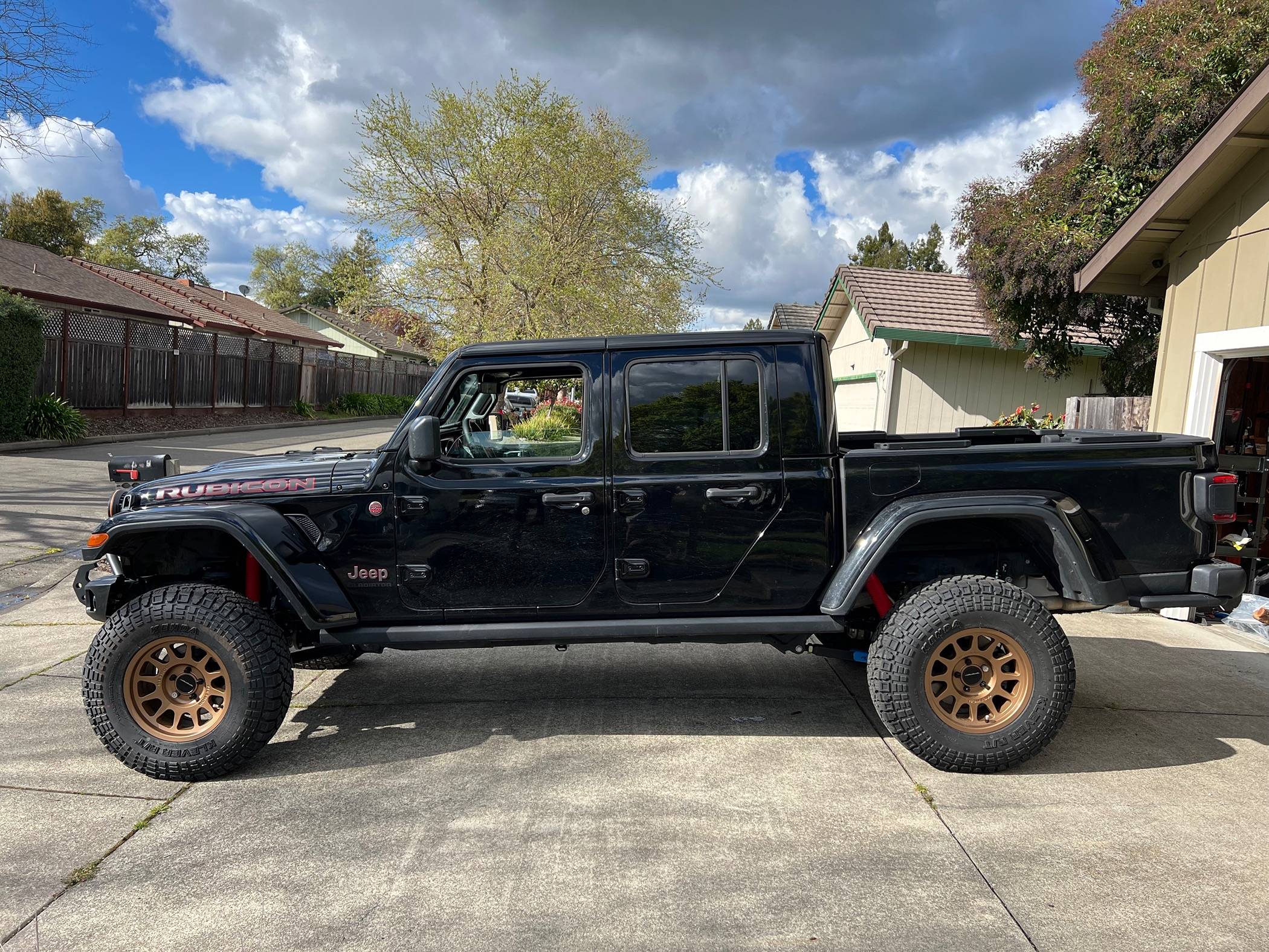

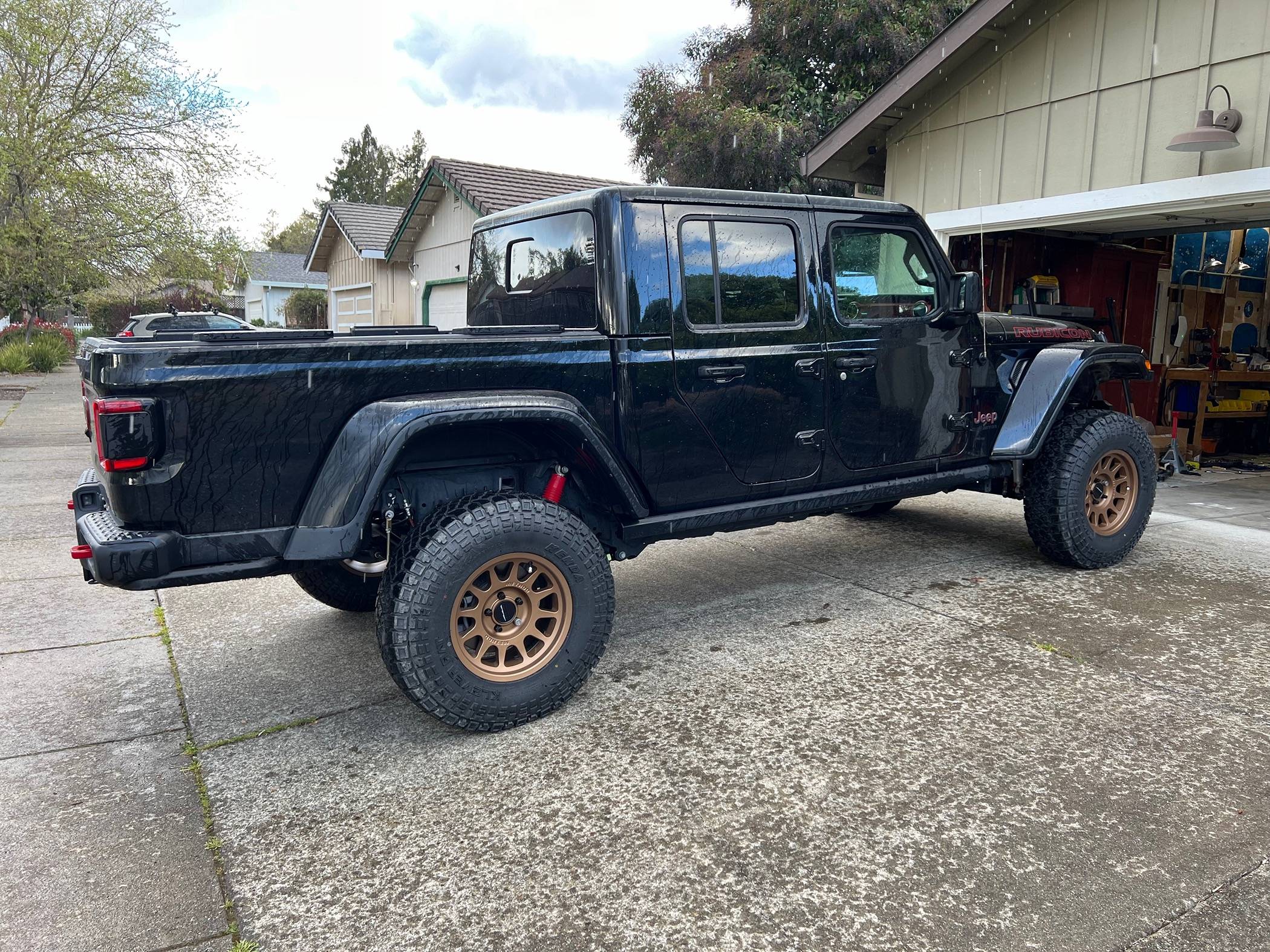

3.5inch OL+ and 35s for anyone wondering what this combo would look like. I like it and I’ll be running it for a while. Ultimate plan is 5.13s and 37s or 38s.
I’ve only driven it for about 30mins. Love the quality of the Clayton lift, super beefy stuff. And impressed the with the bang for buck you get with Rancho XL9000s. Very much an upgrade over factory. Combo was super smooth on the freeway at and above 70s.
and btw, took me about 10 hours today. Started at around 6:30am finished at about 4:30pm.

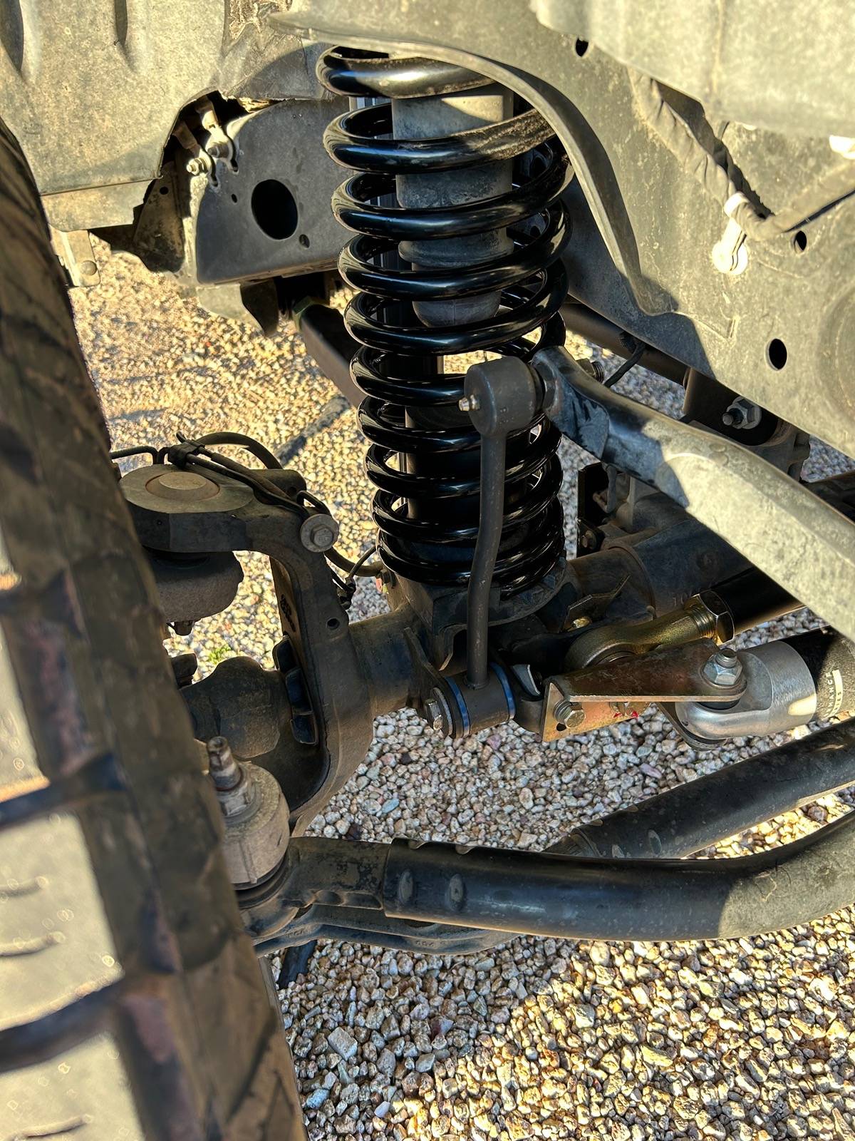

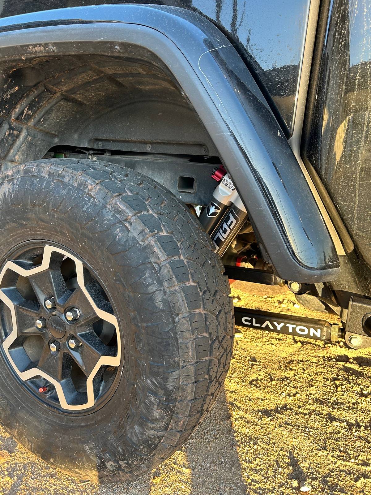

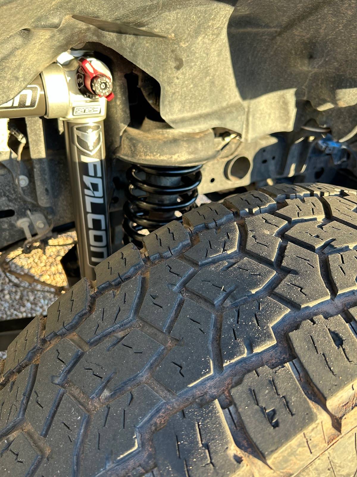

I did the 2.5” OL+ with Falcon shocks by myself in my driveway on jacks and stands a couple months back and it took me about 14 hours total spread out over the weekend (not counting time I spent to pre-adjust everything).
This was my first lift install and so that may have added to my time, though I’m comfortable working on cars. I had the most difficulty getting the rear springs in (taking the calipers off helped but was still tight) and as you mentioned getting the pinion angle and getting the axles centered (I used ratchet straps and multiple jacks to help). Installing the front bump stops was a pain too, just not much clearance to get the nut in underneath and I’ve got big hands.
I added some skids while I was down there - Clayton FAD skid, Rockhard 4x4 lower control arm and shock skids (had to cut the front passenger LCA skid slightly as made contact with the FAD skid). I also installed Metal Cloak’s rear sway bar end link reinforcement brackets. I wasn’t a fan of the Clayton sway bar end links so went with Rancho’s. Lastly, I added the RockJock carrier bearing spacer. I also spent a bit of extra time making sure everything was correctly torqued once back on its weight and used a torque marker on all the nuts to visibly check periodically.
I have not taken the Jeep for an alignment yet other than basic things I did myself. It drives fantastic and I used Clayton’s measurements for everything to start with subtle adjustments on the fly as needed.
I’m super happy with the Clayton Overland Plus lift and the Falcon adjustable shocks and have already hit up a few trails.

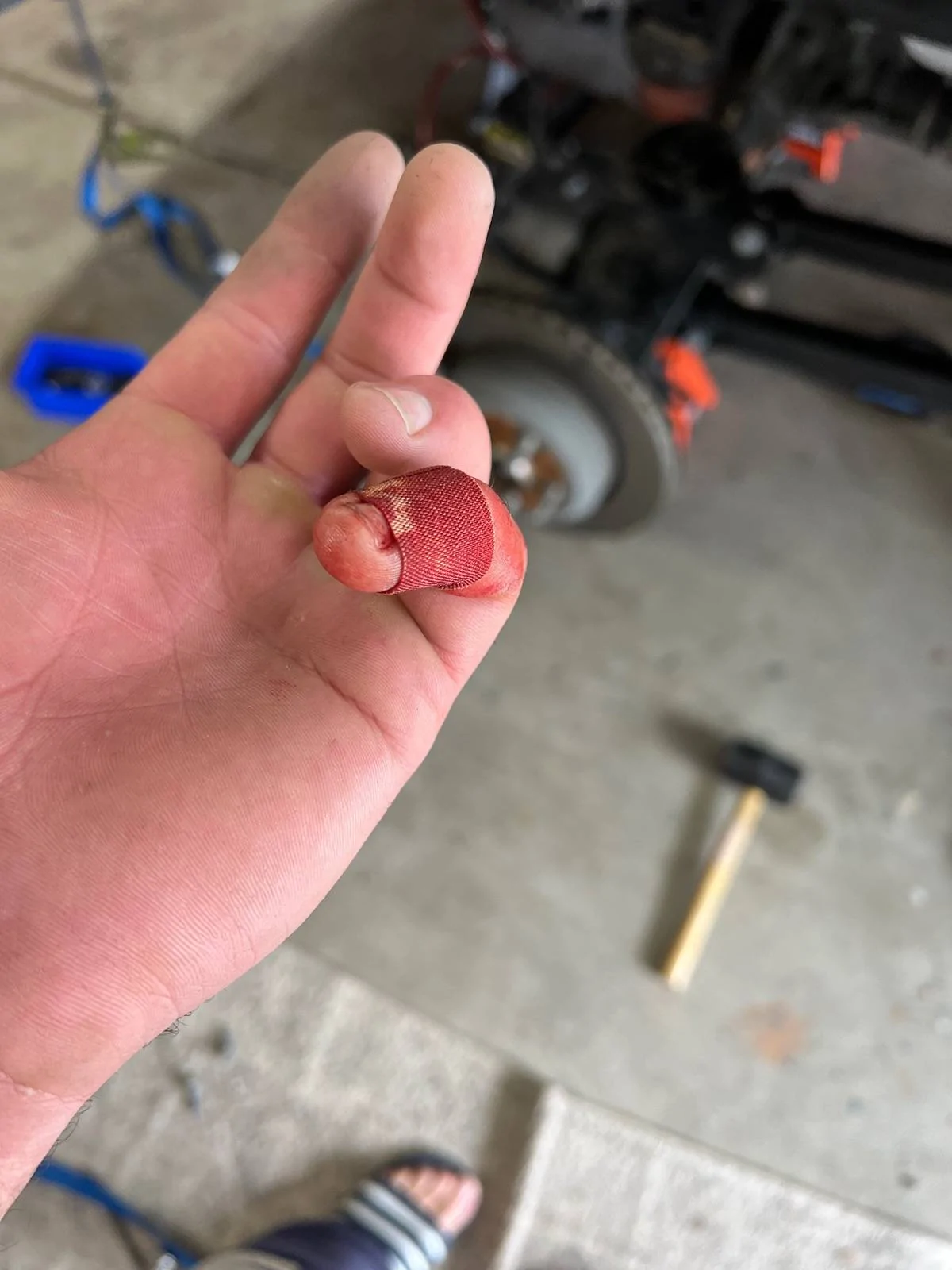

This is my first Jeep and I’ve fallen in the love with them because theyre like Legos (but with bigger consequences ?)
Jeep Gladiator Clayton Off Road JT Suspension Systems IMG_2324

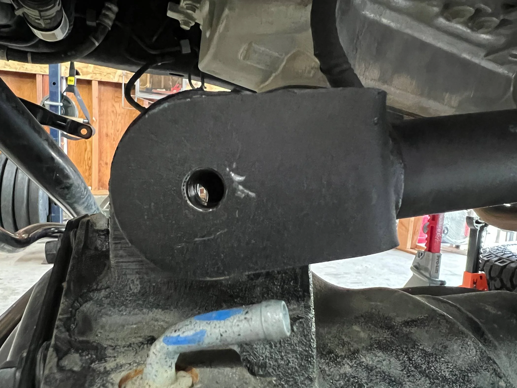

The springs were definitely a bi*ch. Getting them in wasn’t terrible, but keeping that stupid rubber bushing aligned while muscling the spring over the “bucket” was awful. I feel ya.
My front pinion angle looks great, the rear not so much, but have the RockJock arriving today so we will see.
The install took me about 10 hours, but I had everything pre sized and cut. I’d already installed the extended brake lines too.
I had a hell of a time with the drivers side upper control arm. I did the lower driver side first and then the upper. It was cock-eyed. The distance was correct, but the axle side tabs on the control arm seemed to have a different angle than the axles bushing. I was questioning if I was sent two passenger side arms despite it clearly being labeled driver side. Anyway, I left it unbolted and kept moving. Replaced all the other control arms and track bar without a problem. It was a lot closer after, but still off. I had to ratchet strap the driver side axle to my bumper to rotate it forward. In the end I got it lined up but completely screwed up my alignment. It was so bad I got the “Service Tractions System” alert. My steering wheel was at 2 o’clock to drive strait and one wheel was strait while the other was tow in a couple of degrees. No biggie I’m only a mile or so from the alignment shop. It took them about 30mins to get it strait.
Besides my body being destroyed from 190 Ft/lbs (I was so demoralized when I saw both upper and lowers in rear all called for 190) I’m very happy with the lift.
Yea I definitely had my share of cuts, scrapes and a gnarly bruise on my left forearm for 2 weeks (not exactly sure what I did to cause that!).
My steering wheel was definitely way off but a quick drag link adjustment fixed that. My toe did not appreciable change though.
190 ft/lbs was a bear for sure and some very awkward angles to try and get it, thought I would give myself a hernia at times!
Glad you’re enjoying the lift, mine has been amazing as well. On to the next mod (thinking about RockHard 4x4 full belly skids) and see ya folks out on the trails!
