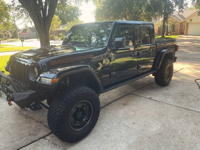

I went with the 1.5” overland plus kit and kept the factory shocks as the springs were compressed and it put it back in that factory spot in the shock and it rides great
I attached a picture of the stance now

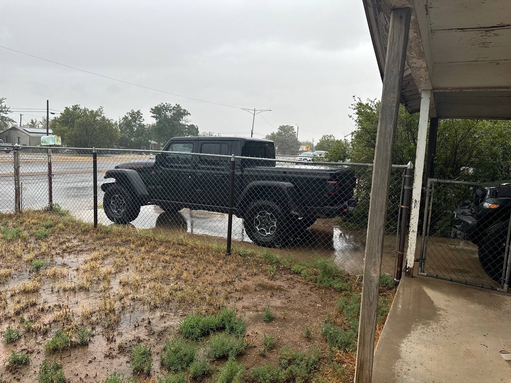

Love that. I have the AEV 2" with 35's. I want to go 37's one day.
Jeep Gladiator Clayton Off Road JT Suspension Systems new wheel side
21Mojave24XR
Aug 12, 2024
107
93
Tx
2021 Gladiator Mojave, 2024 Willys XR
Field Diesel Technician
I like your choice in vehicles my friend. I kept my stock wheels because I like them too much and with the 35’s and Clayton suspension I get no rubbing
