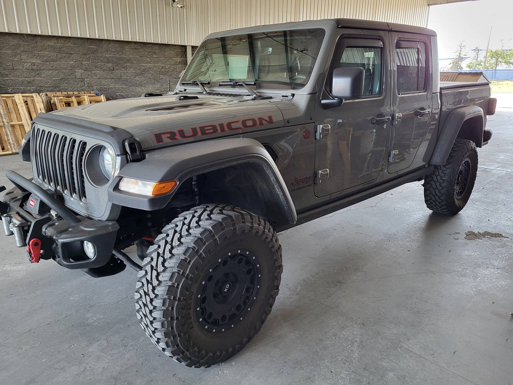

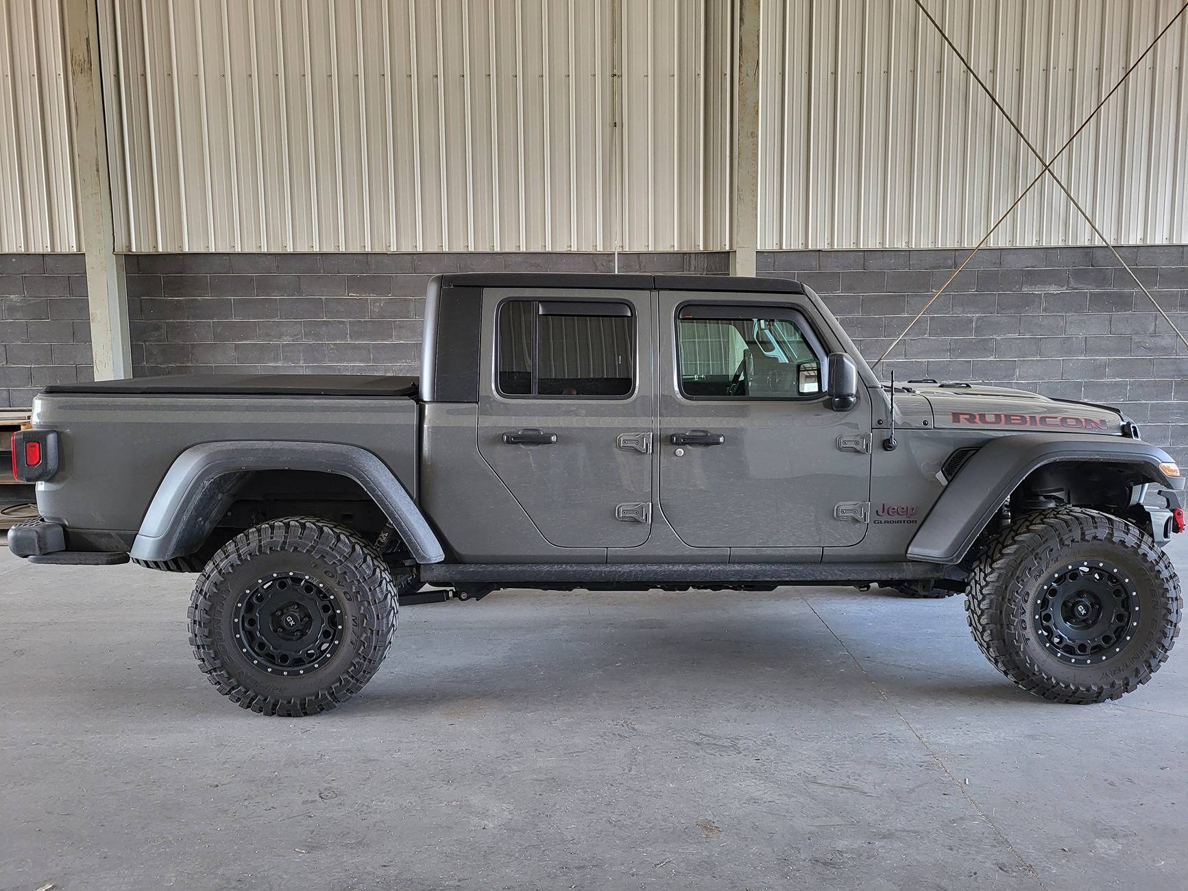

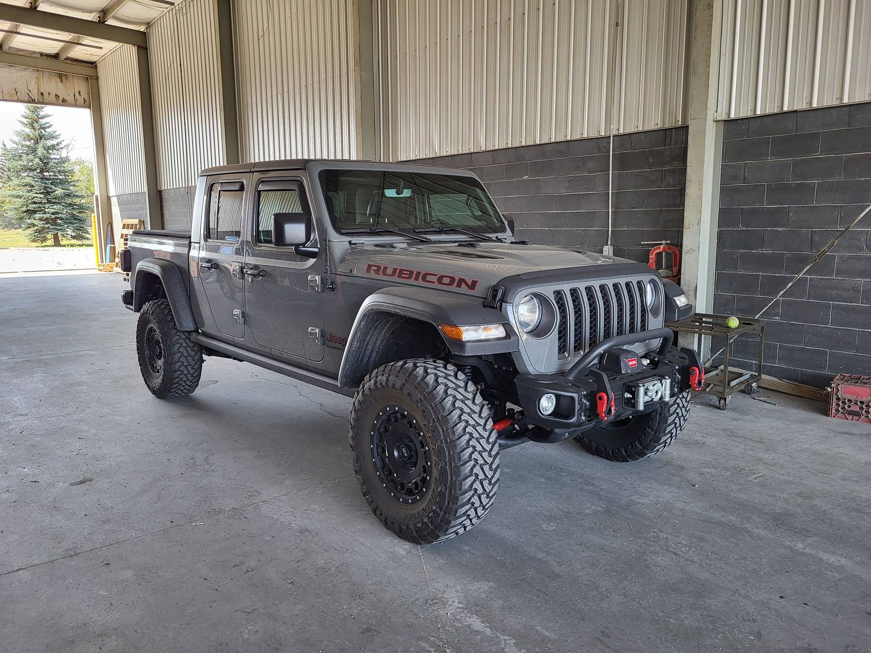

Here is mine with the 2.5" Overland Plus. I have the 315 (fake 35s). There is also a 1" Teraflex spacer in the front. I am not a fan of rake and I like the slight rake that is left. I took the picture in my shop so you can see the level lines on the wall for comparison.
yeah that’s perfect. Exactly the look I’m looking for with a 35. Thanks!

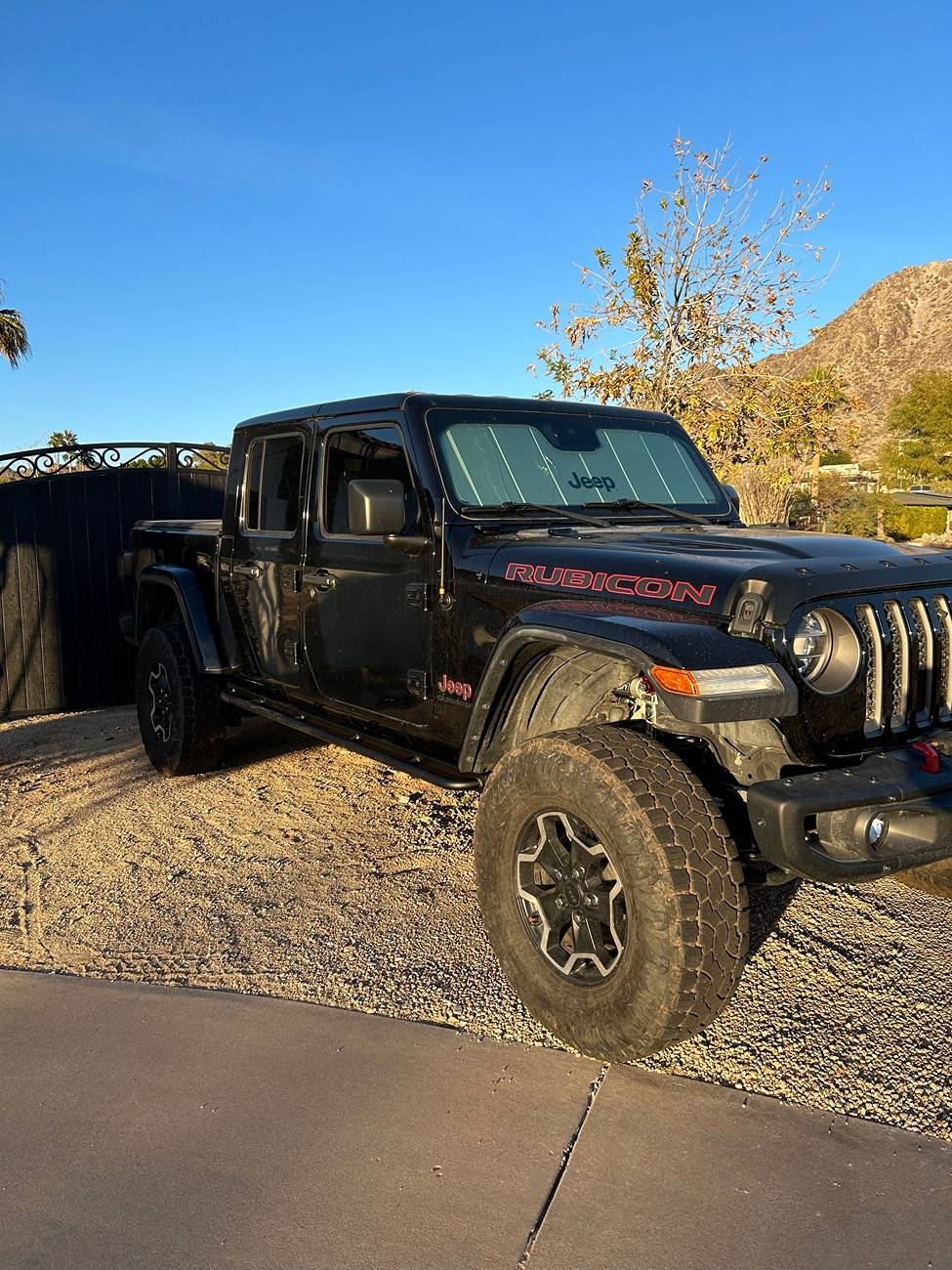

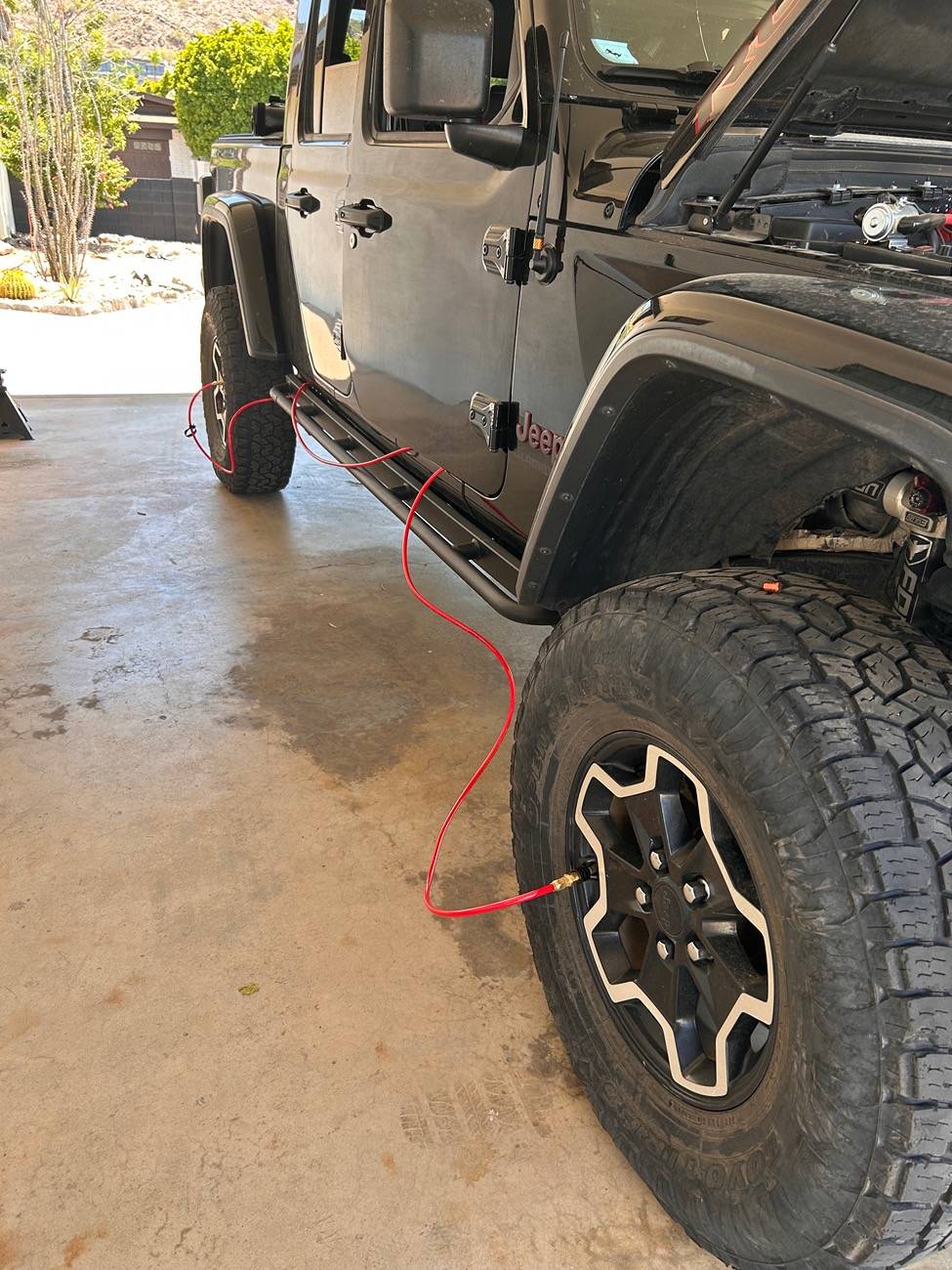

Anyone here have the Clayton 2.5 inch lift with 35x11.5 tires? This is the route I'm planning down the road but would like to see some eye candy if anyone has it. Thanks!

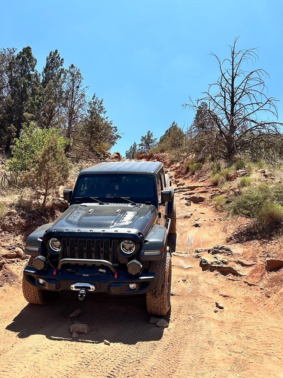

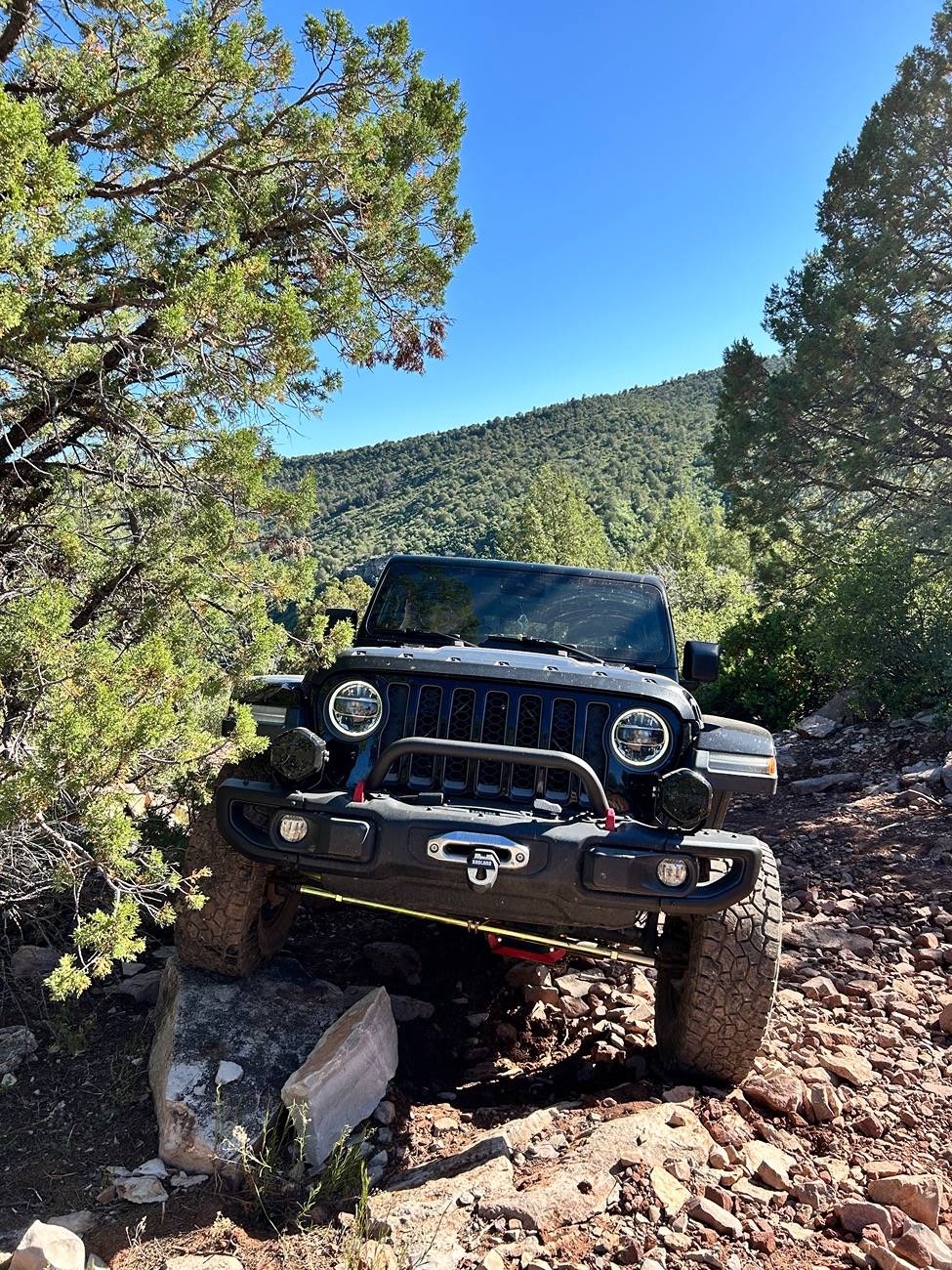

I’m also running Clayton’s Overland+ 2.5” lift with 35 x 11.50 (Toyo ATIII) on stock rims with Spidertrax 1.75” spacers. Here’s a few pics for you. I don’t have anything directly end on at the moment for you to see the poke but hopefully gives you an idea. I personally do plan to upsize to 37s eventually but for now I’m very happy with the look and trail performance of this setup.
