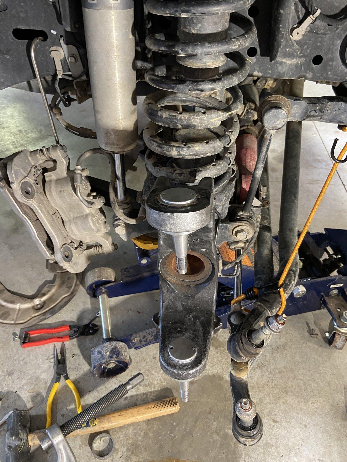

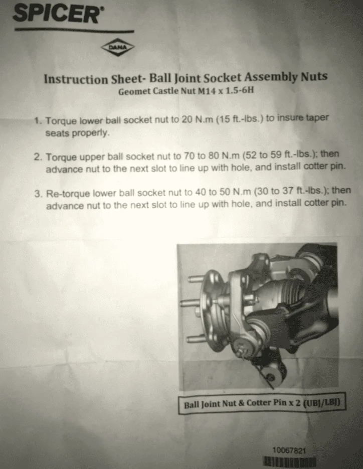

Does anyone happen to know what the torque value is? I plan to knock this out this weekend to get rid of my clicking.

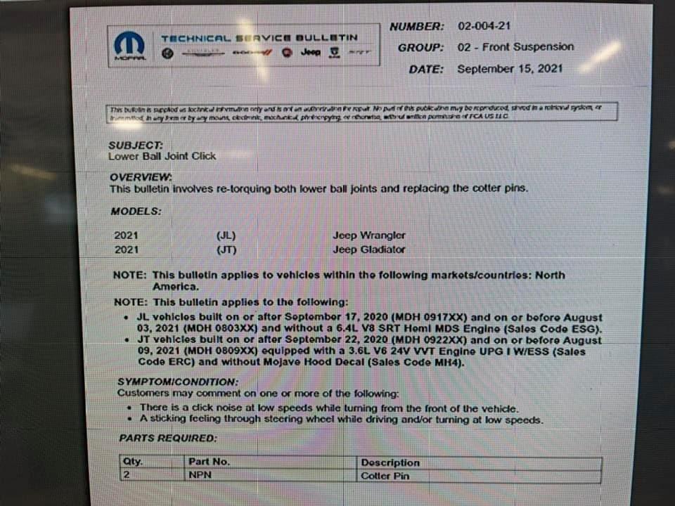

By chance does anyone have a recording of what the “click” sounds like? I’d like to find out if what I’m hearing is the same.
I do occasionally hear a clicking noise
when I’m turning the Gladiator at low speeds. But it never really seemed like an issue - it never impaired performance.
Also:
this tsb is what fixed mine.
Torque lower to 15 ft.lb to set taper
Top ball joint: 52-59 ft. Lbs.
Retorque Bottoms ball joint: 30-37 ft. Lbs. and then advance the nut slot to line up with the cotter pin hole.
Thanks!
