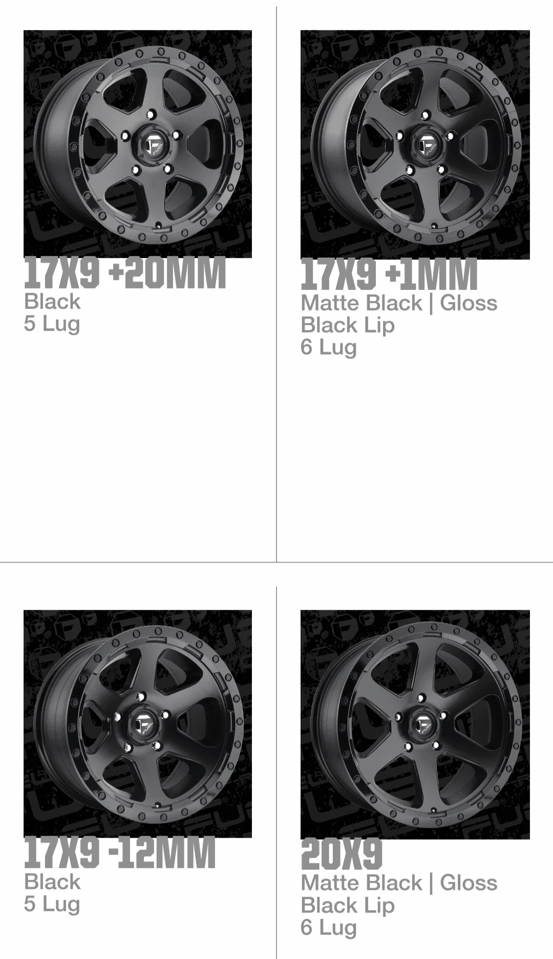

Looks like the 17 Ripper comes in several configurations.
If you're rubbing somewhere you should be able to see the marks on whatever's being rubbed.
Jeep Gladiator Popping or rubbing sound from front end when cornering Screenshot_20220730-154537

I think mine are the -1 offset.

Sorry, +1 offset.
