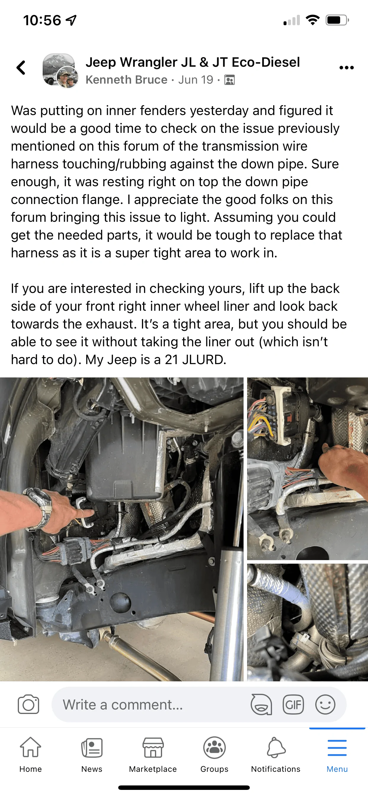

Following up for anyone interested:
Just heard from dealer.. they found a melted wire loom (guess it’s time for an EGT gauge) next to the exhaust way up in the harness. One wire in it was chafed from rubbing on the exhaust. They used a flat 2 ft long light with a mirror to find it.
They repaired the harness and secured it out of the way so it won’t happen again. They said no more codes and it now starts and drives perfectly. I’ll have to pick it up tomorrow as I’m out of town working. I guess this is good news for me, I wonder if they should put out a TSB for this??

That is exactly what they found on my Ram eco after it burned up. Wish I had found it early.

Was it the harness somewhat near the passenger front fender, and was it resting on the downpipe? There was a post on a FB group a few weeks ago about this being common and to check. I did on my 22 JTRD, and yep - the harness was touching the downpipe flange. I pulled it back a bit and zip tied it so there was an air gap. Seems like this is a big issue that should be corrected (and easily) at the factory.
Really wish I would’ve seen this before my trip! It would have save me A LOT of headache! I will confirm once I pick up the gladiator tomorrow with pics if I can get them.

Thankfully nothing caught on fire. I think at some point this corrected this, but depending on build date it’s worth a check for most of us diesel owners.

FWIW - mine was barely touching the flange, and it had a build date of May 2022. Hopefully that wasn't considered "Corrected"! ?
