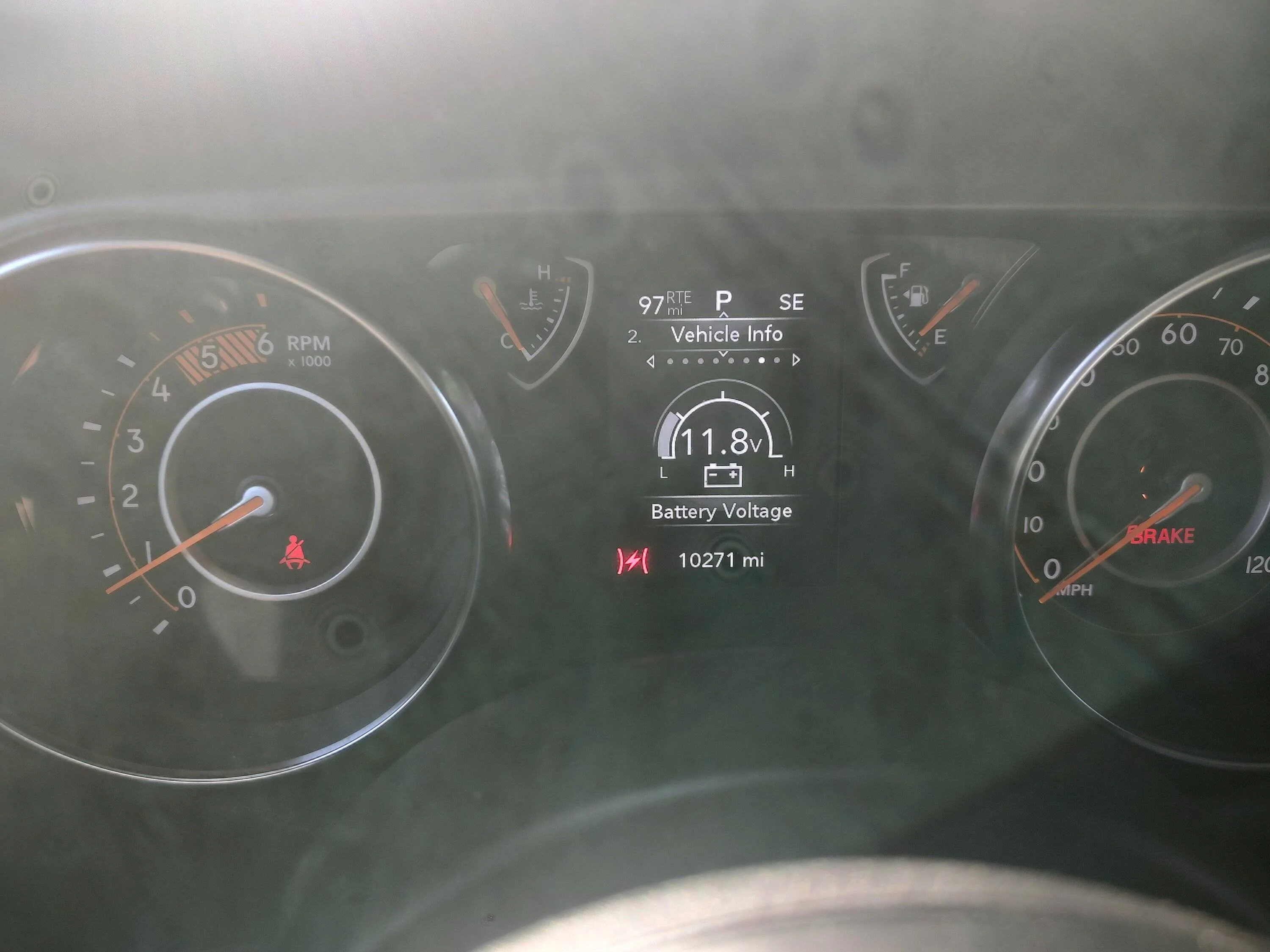

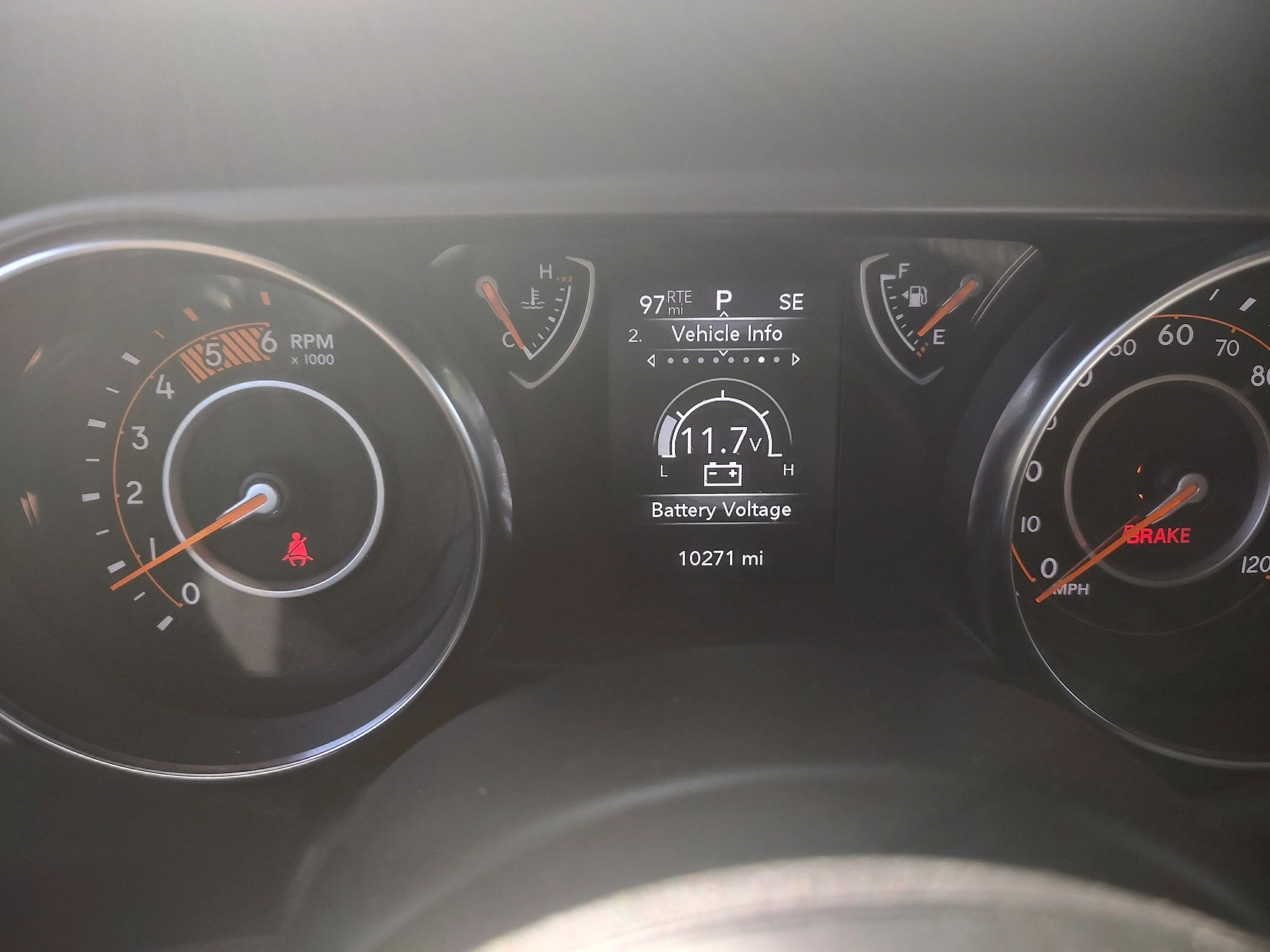

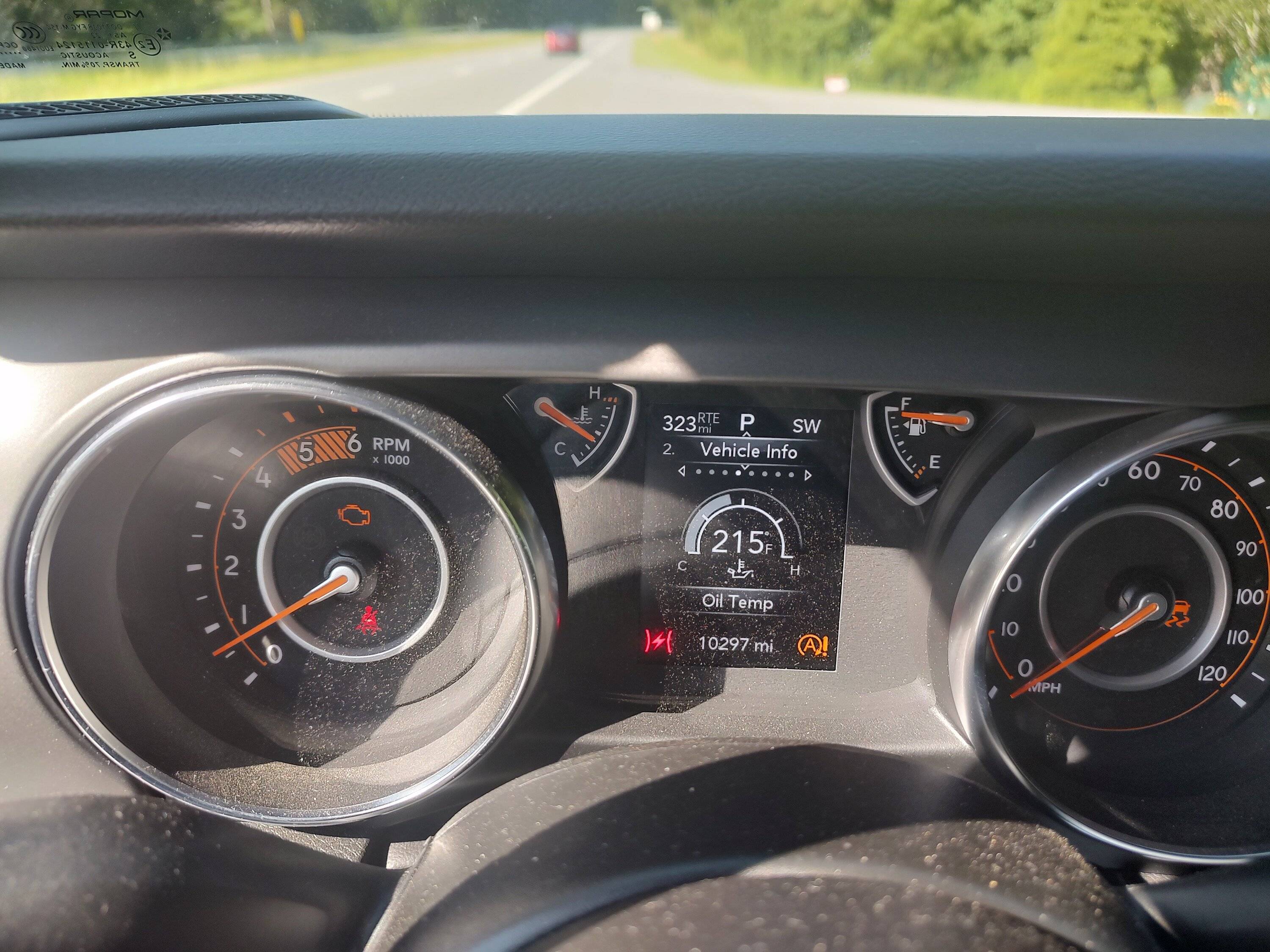

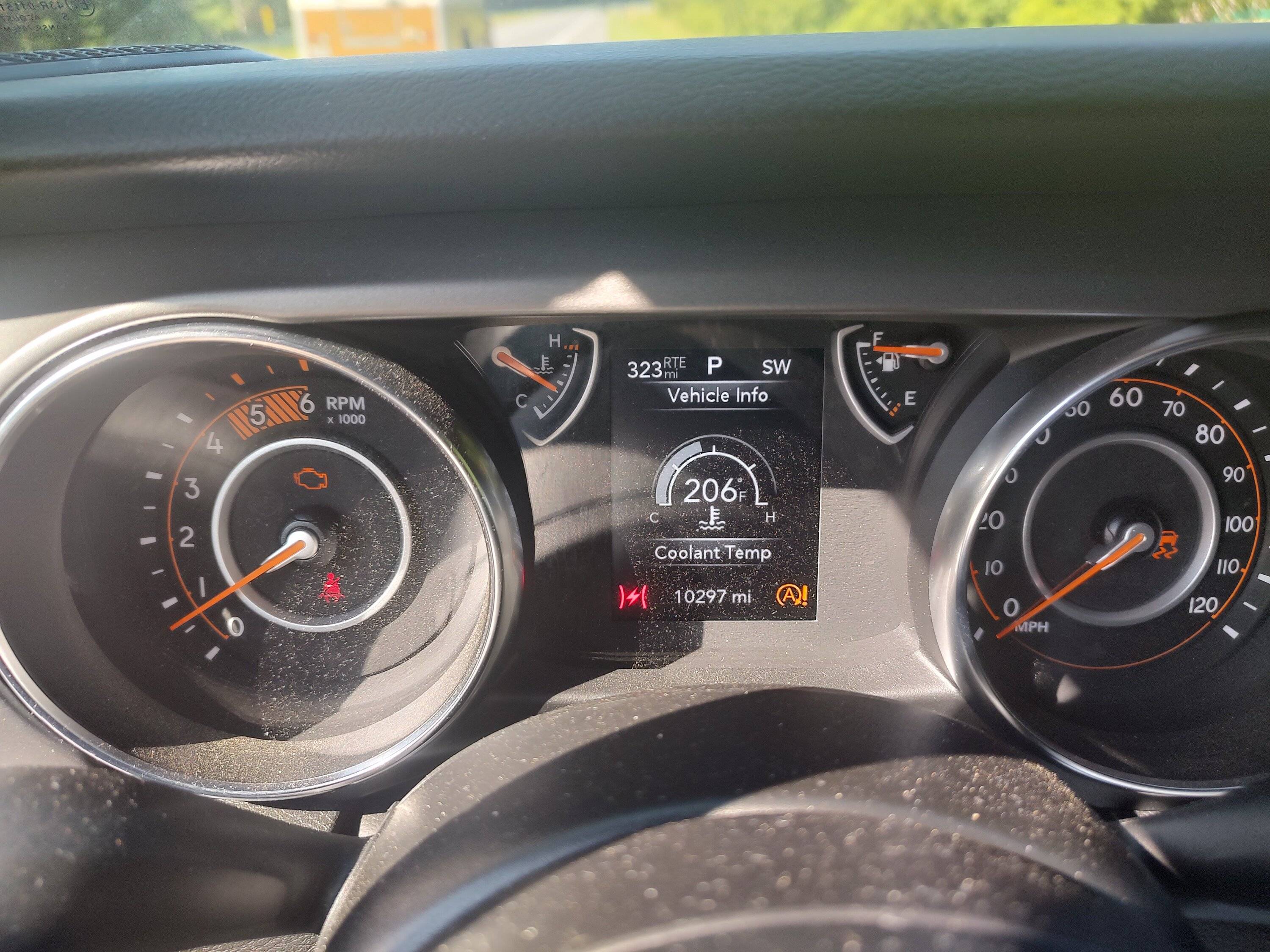

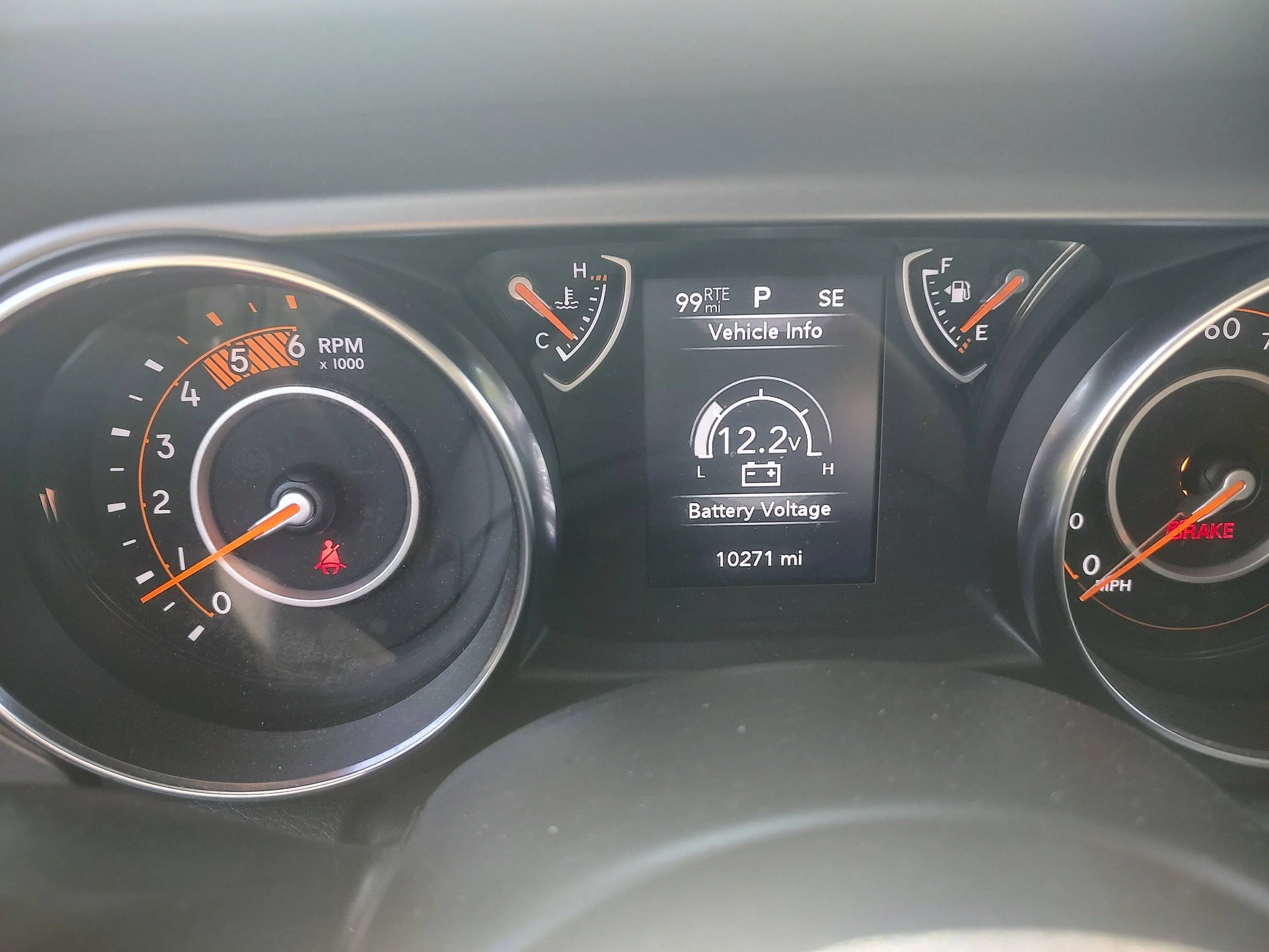

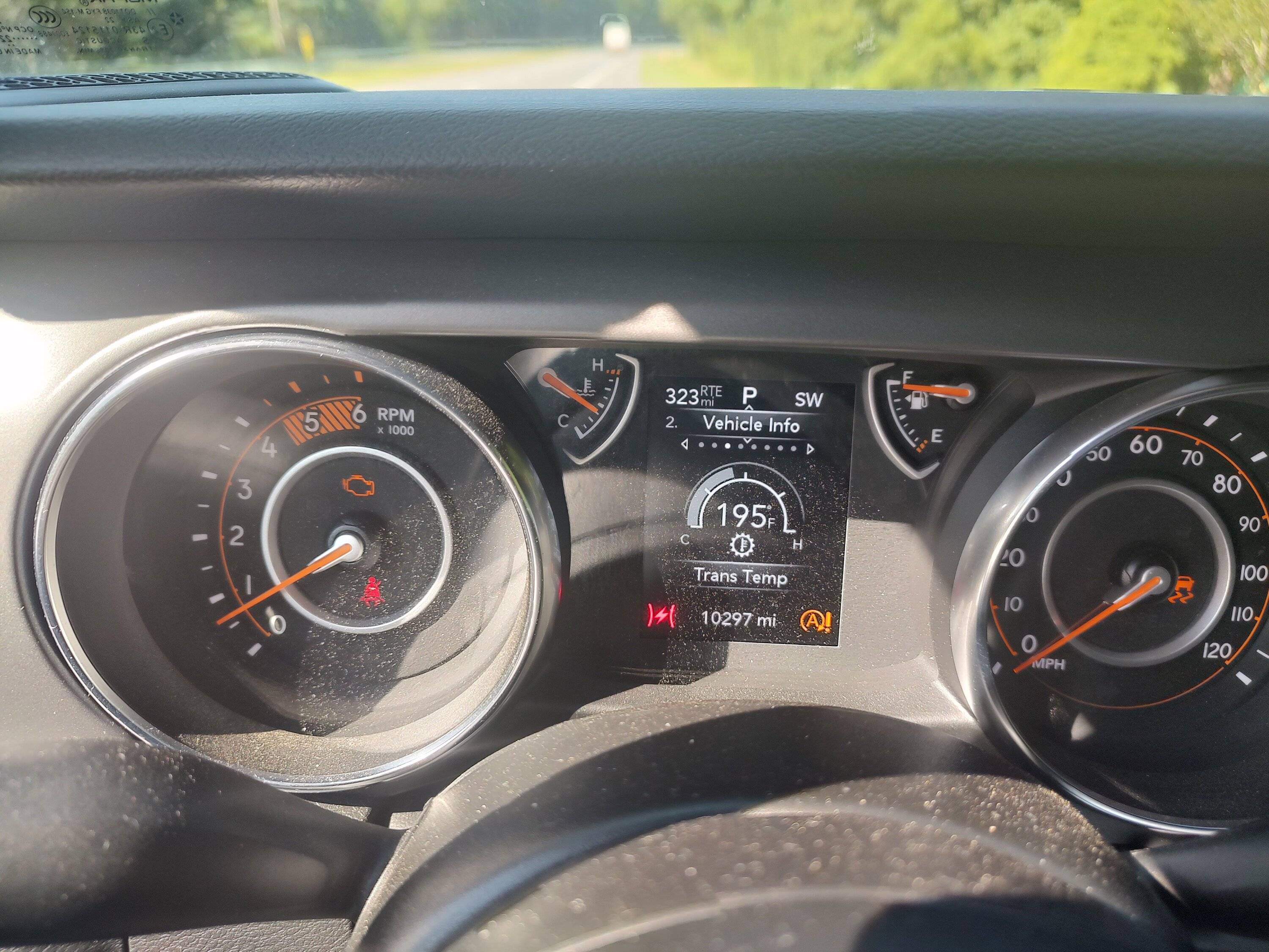

The last few weeks I have been watching everything and documenting when my gladiator goes in limp mode.
I can predict when it will go in limp mode.
I have read threads with others ranging issues, wiring harness which I checked, I went thru complete trouble shooting.
Voltage is one thing I see. it avgs 12.3-12.5 avg.
Highest oil temp I have seen is 239 went in limp mode.
But normally temps are cooler going in limp mode.
It will usually go in limp mode at 2000rpms-2500rpms.
It's always on a hill never in flat areas, towing or empty.
I am thinking it's a voltage issue or sensor.
Another thing auto stop/start. When it shuts off at the light you can watch voltage drop and when it gets to 12.1 it turns back on.
Jeep Gladiator More eco diesel limp mode excitement IMG_20230725_093518711_HDR
Jeep Gladiator More eco diesel limp mode excitement IMG_20230725_093533267_HDR
Jeep Gladiator More eco diesel limp mode excitement IMG_20230725_093534449_HDR

I would be pulling the batteries and have them load tested. That and check if the alternator is being commanded to charge. Making sure all the fuses in the underhood fuse box would not be a bad idea, as well.

I know with turbo being electronic controlled with it spooling going uphill that it pulls voltage more which if it's in minimum now with cooling, oil cooling with drawing voltage I wonder if the turbo puts it over then confuses the computer?
As much trucks and heavy equipment I have usually a bad battery or alternator things go dead quickly but in this case nothing has died yet.
I am always opened to suggestions.

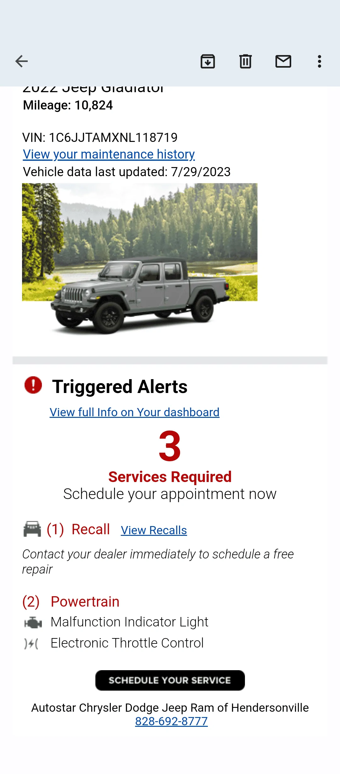

This is what it says everytime
Jeep Gladiator More eco diesel limp mode excitement Screenshot_20230729-214057

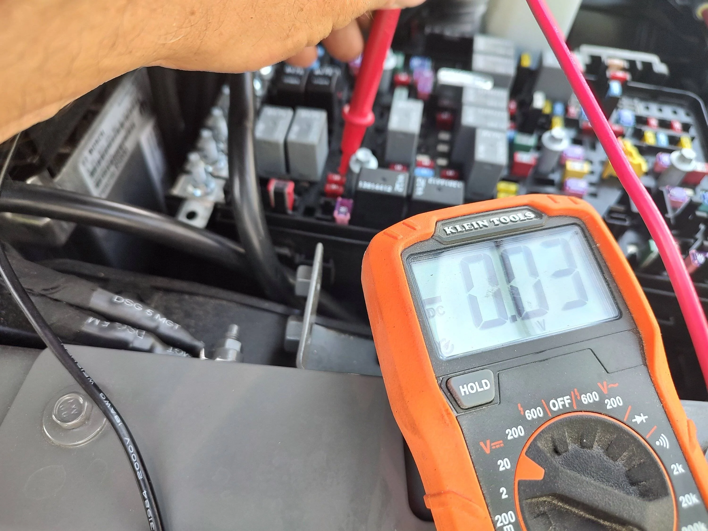

Look what I found on f23 Powertrain Control Module (PCM)/Engine Control Module (ECM)
-03
Jeep Gladiator More eco diesel limp mode excitement IMG_20230730_171005306_HDR

You def have some sort of electrical issue. Your temps are no where near thermal triggers. Did you check the harness by the exhaust ?
Ironman 67
Jul 16, 2023
52
Burnsville
2022 jeep gladiator
Yes I did. It's good. The f23 fuse is -03 volts
