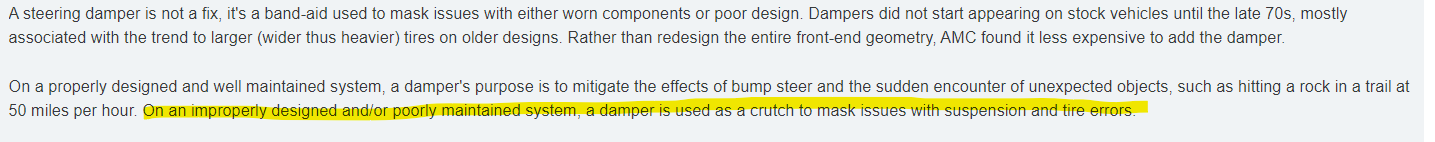

LOL - different terms for the same bloody part.
Not sure why the bold/underline.
That part is a bandaid anyway, not a true fix for true death wobble.
Check all of the posts made over the years here outlining the facts on this.
Further, that bolt issue impacted a limited number of these trucks for a short period of time.
This is probably thread #857 on the DW topic. No news, nothing new in this one, same-o, same-o.

"damper", "stabilizer", all the same part. Different people use different terms based on what they have heard said or read or been told.
. I didnt have any death wobble until after my lift. I doubt its related, but just adding for information purposes.
Sometimes IS related. Wheel changes, moving tires outward, taller tires, etc. - can especially impact it when it's caused by braking as you have made changes to the scrub radius and one symptom is - nasty stuff happening under heavy braking.
