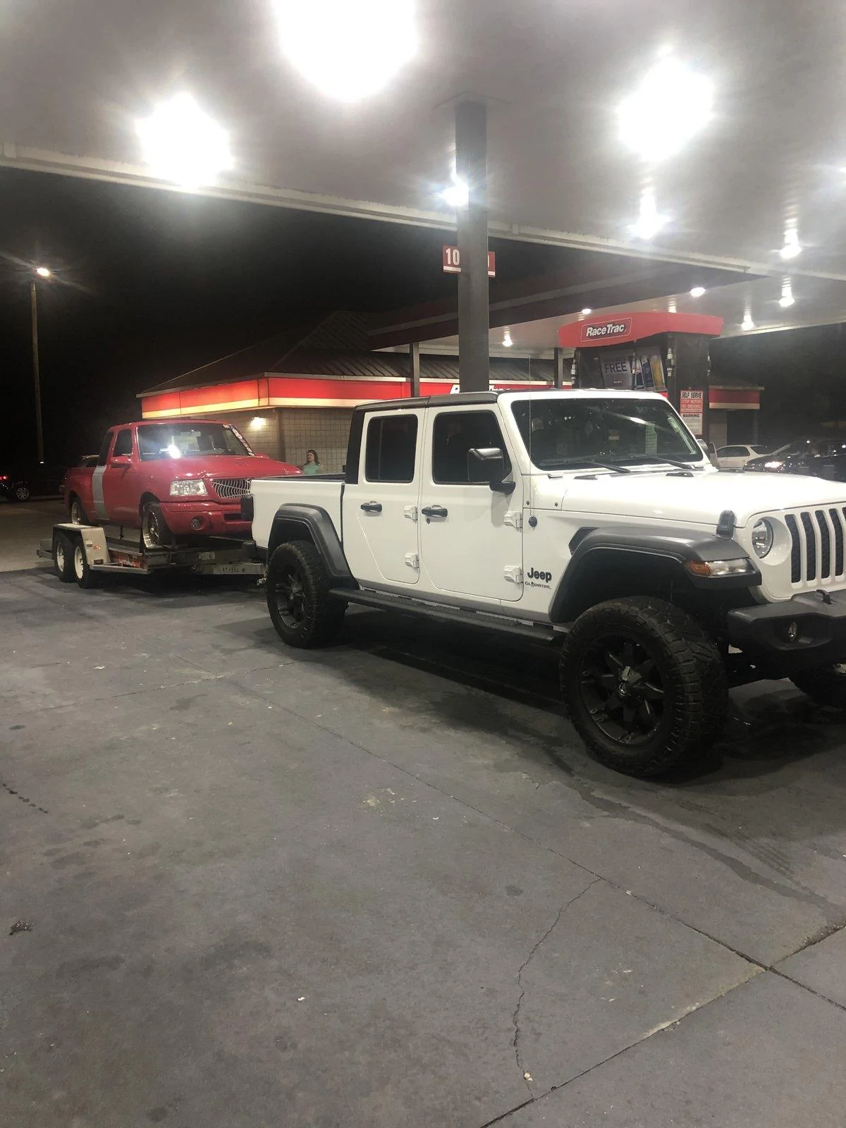

Just towed a ex cab ranger with a U-Haul trailer 2.5 hours in 6th gear at 70-75 mph 3500rpm. Still got 13.5 mpg too. I do have max tow package btw.

Perfect.
Those UHaul trailers are heavy duty too.

U-Haul designed those trailers to be bullet-proof, safe, easy.
13.5 mpg? Wow, I have trouble hitting 13 when I tow my rig even in fairly flat Illinois. I can easily do better not towing - like 18-20.

I was trying to find the weight of a Ranger using the window sticker from my father's 2010 Ranger he had- not extended cab, but it doesn't show weight. (just to know what you were towing on that U-Haul trailer)

I asked a few different people because I honestly wasn’t sure. From what I told it is around 3k lbs plus trailer weight. Yeah I was surprised with the mpgs. ESP beings I have 3.5” lift 20s and 33s.

I posted a the same picture from above in some FB Jeep pages, most people were impressed but you know there has to be a few idiots. I had someone say that the motor isn’t built for towing even though Jeep says it can haul 7600lbs. They were saying that I’d destroy my engine with in a few years or towing like this. I’m sure it was an old school jeeper use to the small capacity of the wranglers towing abilities. I had no issues my 2.5 hr trip hauling it. I knew it was back there, and the semis caused me to sway a little but other then that It did great
