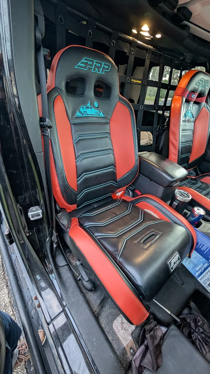

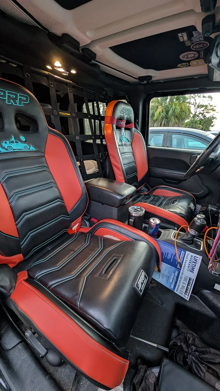

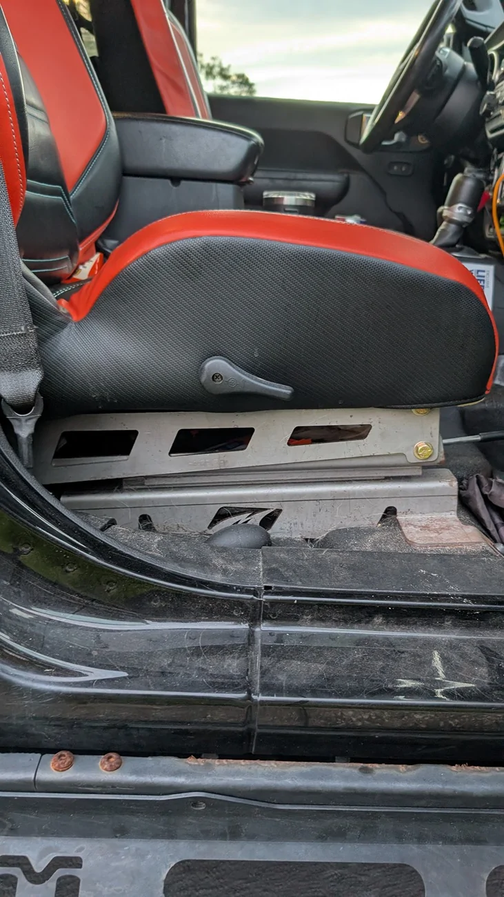

Have you looked into PRP seats? I swapped my SportS seats out with them and I love it.
I had them made with lumbar support but did not add heated seats. Instead I purchased OEM heated seat pads from an online retailer and then threw them into the PRP seats. Now I have heated seats that work with the factory controls. Super easy to do.
Edit:
The PRP suspension seats are not bouncy, however they do take out some bounce from the road/trail.
Seatbelt sensor was also easy to install. I removed the sensor bag from the stock seats and fit it between the bottom mesh of the seat and suspension cords. The seatbelt connector I beleive I attached to the Motobilt brackets I bought for the seats.
The airbag light is on for me because I never bothered to connect the grounding wire lol.

I went with Endurotrails i guess is what they are called now. Few years ago it was just "enduro" lol. Ill get some pictures to send you if youd like.
They fit perfectly and everything stock works as it should (seatbelt, airbag light once i stop being lazy, heated seats).
My wife hates the jeep (she drives a LR Defender with air suspension lol). But after these seats she was ok with riding around in it.
For long trips for me (driving from Florida to Pennsylvania and back) the seats were fantastic. Previously my back would hurt, my butt, etc. Now that happens rarely. Although after some years in the driver seat I think I need new foam for the butt portion. It isnt as supportive as it used to be. But itll be easy to replace.
