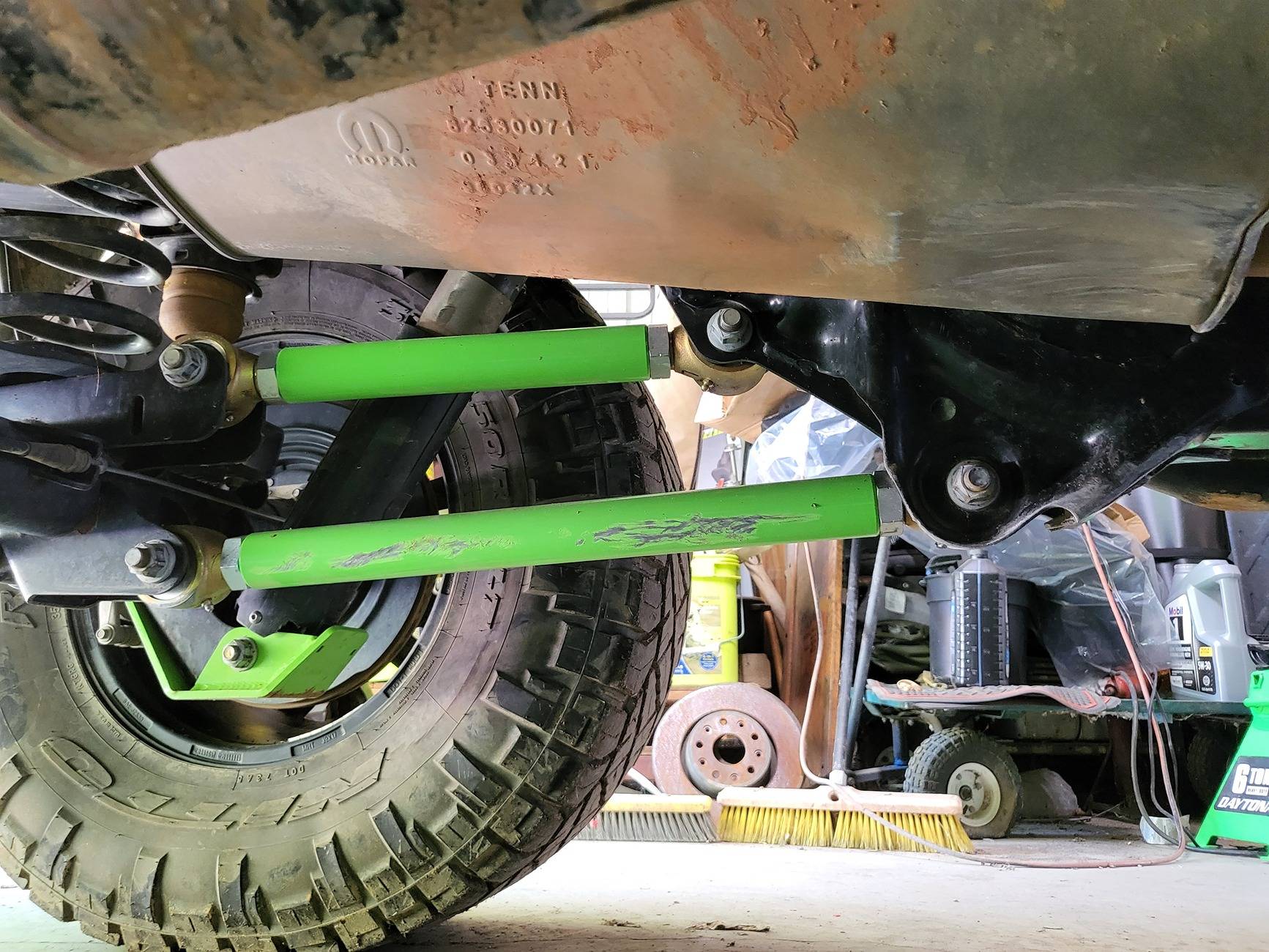

I have Core 4x4 control arms on all 4 corners and they are very solid. I went with what they used to call tier 3 but is now called x-crawl I believe. They have Johnny joints in both ends. The JJ's do require some routine maintenance such as greasing every so often. The build quality and color options are superb. I also have Core track bars. I have drug the lower CA'S over so many rocks and they just do their thing. +1 on pointing the grease zirks up on the LCA'S. I need to flip mine when I get a chance. You won't be disappointed.
