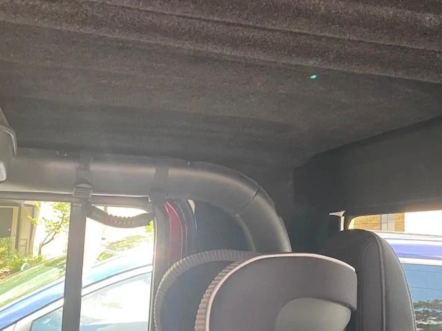

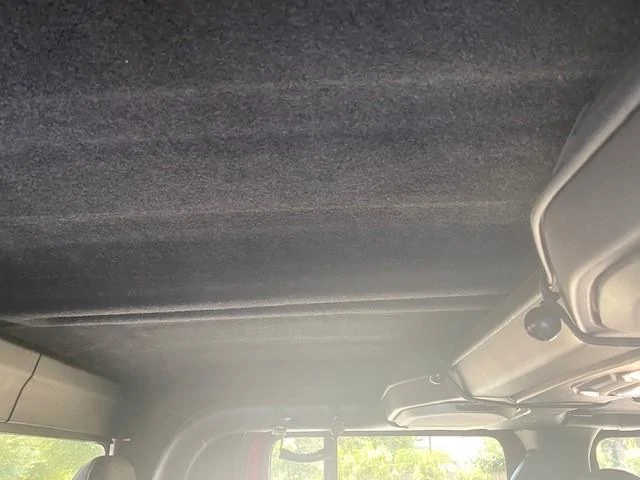

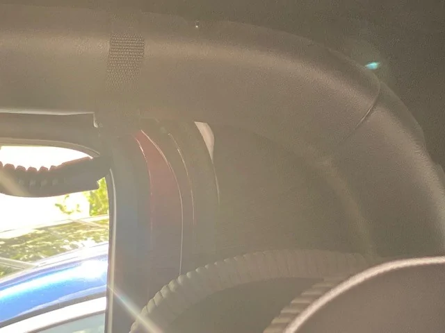

Thanks for the tips. Do you have any pics of how it came out, and the places you needed to trim? I was really looking forward to having this headliner, but now it sounds like a real pita and I’m wondering if I should send it back.
jcarbs
Joe
Apr 6, 2021
332
475
Houston, TX
2021 Gladiator, 2021 Tahoe
Even though it was a pain to put on, over all I am very pleased. I would just make sure you have a roll of gorilla two sided tape handy to help out where needed. Here are some pics. You will see the one corner where the fit could've been better but it's not the noticeable when sitting in the vehicle.
