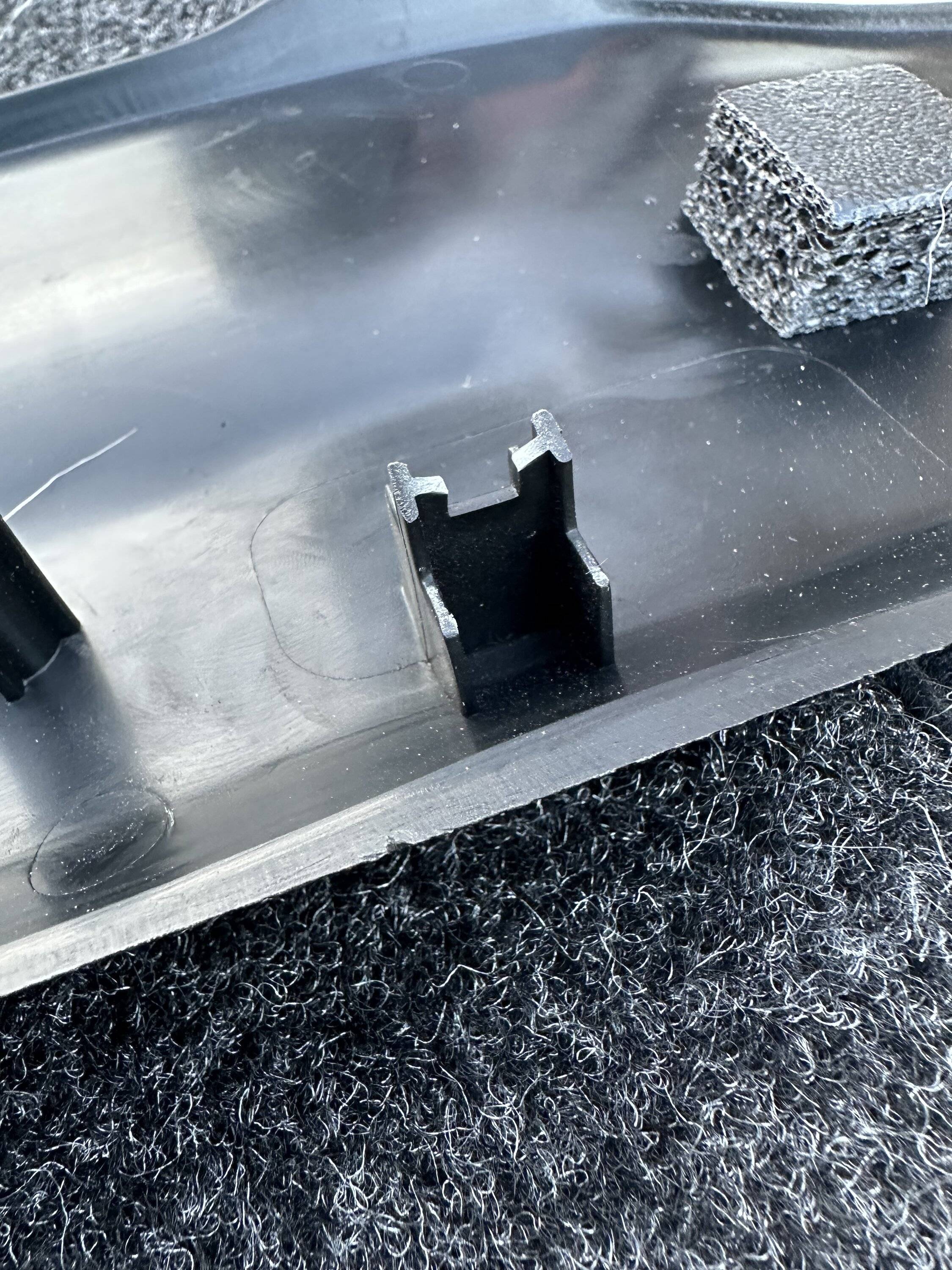

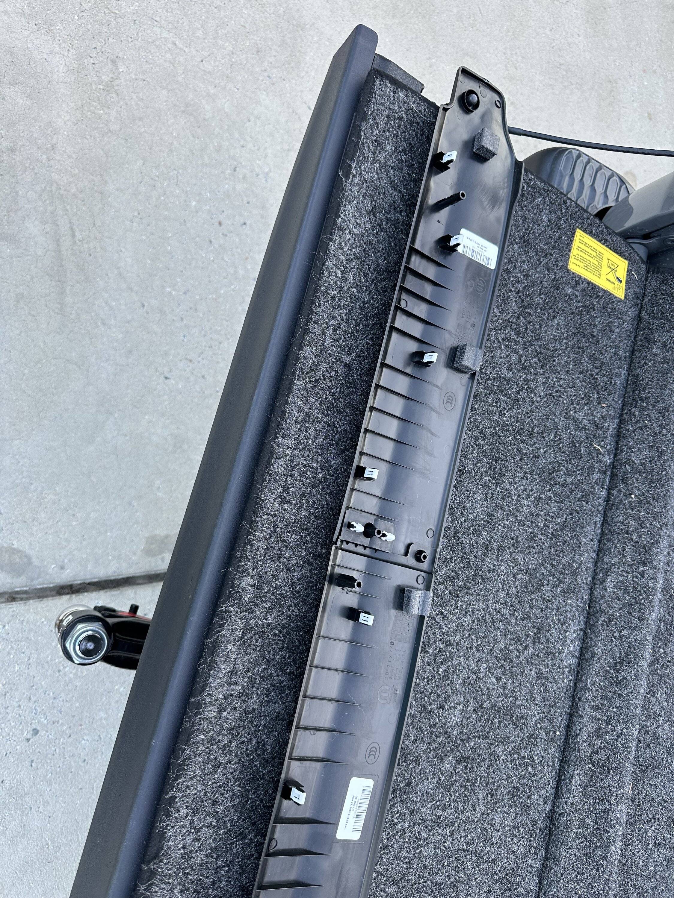

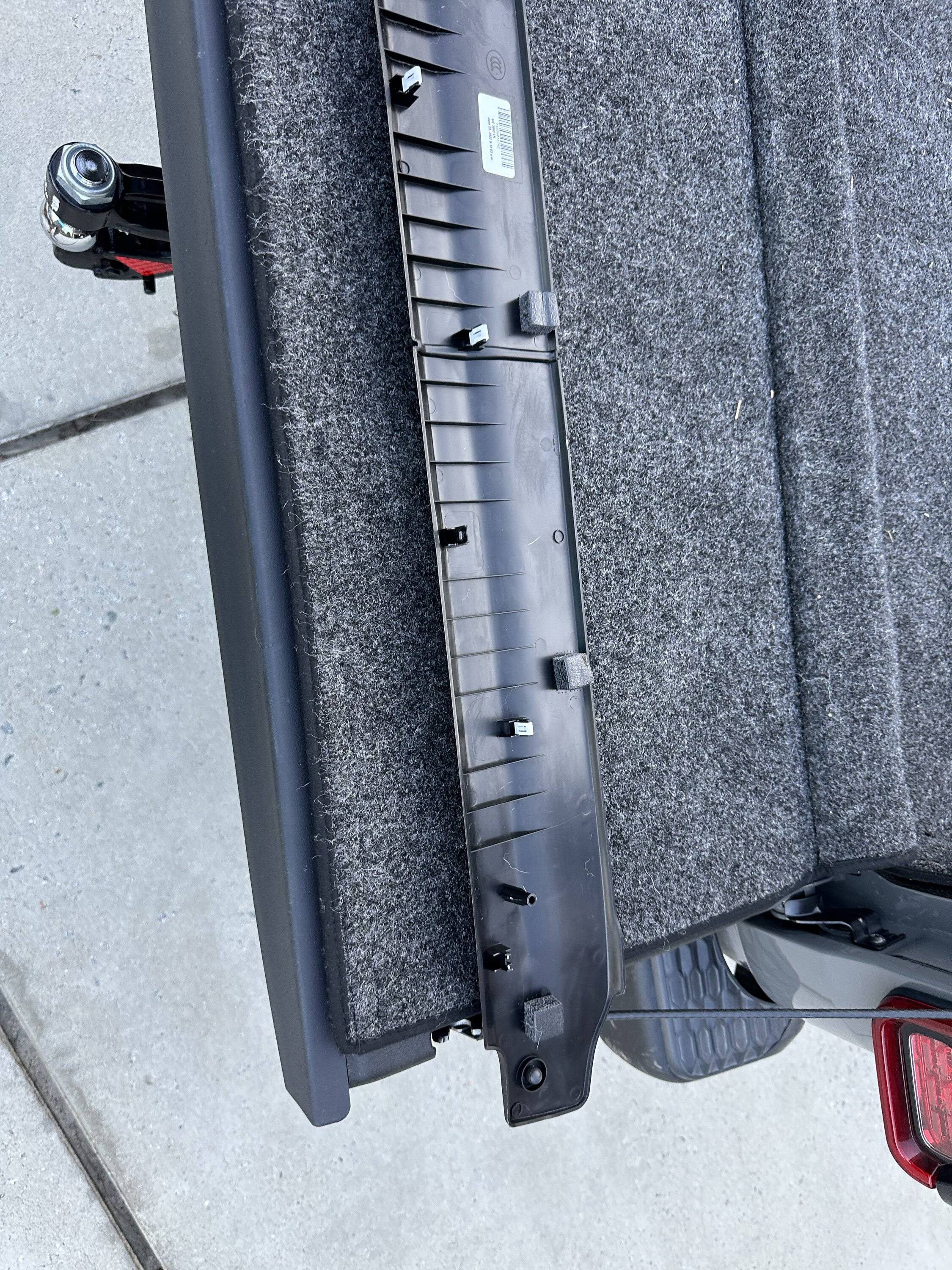

Here is the back side of the trim.
Jeep Gladiator Coverking Topliner - Review & Install IMG_8082
Jeep Gladiator Coverking Topliner - Review & Install IMG_8081
And the one that broke.
Jeep Gladiator Coverking Topliner - Review & Install IMG_8083

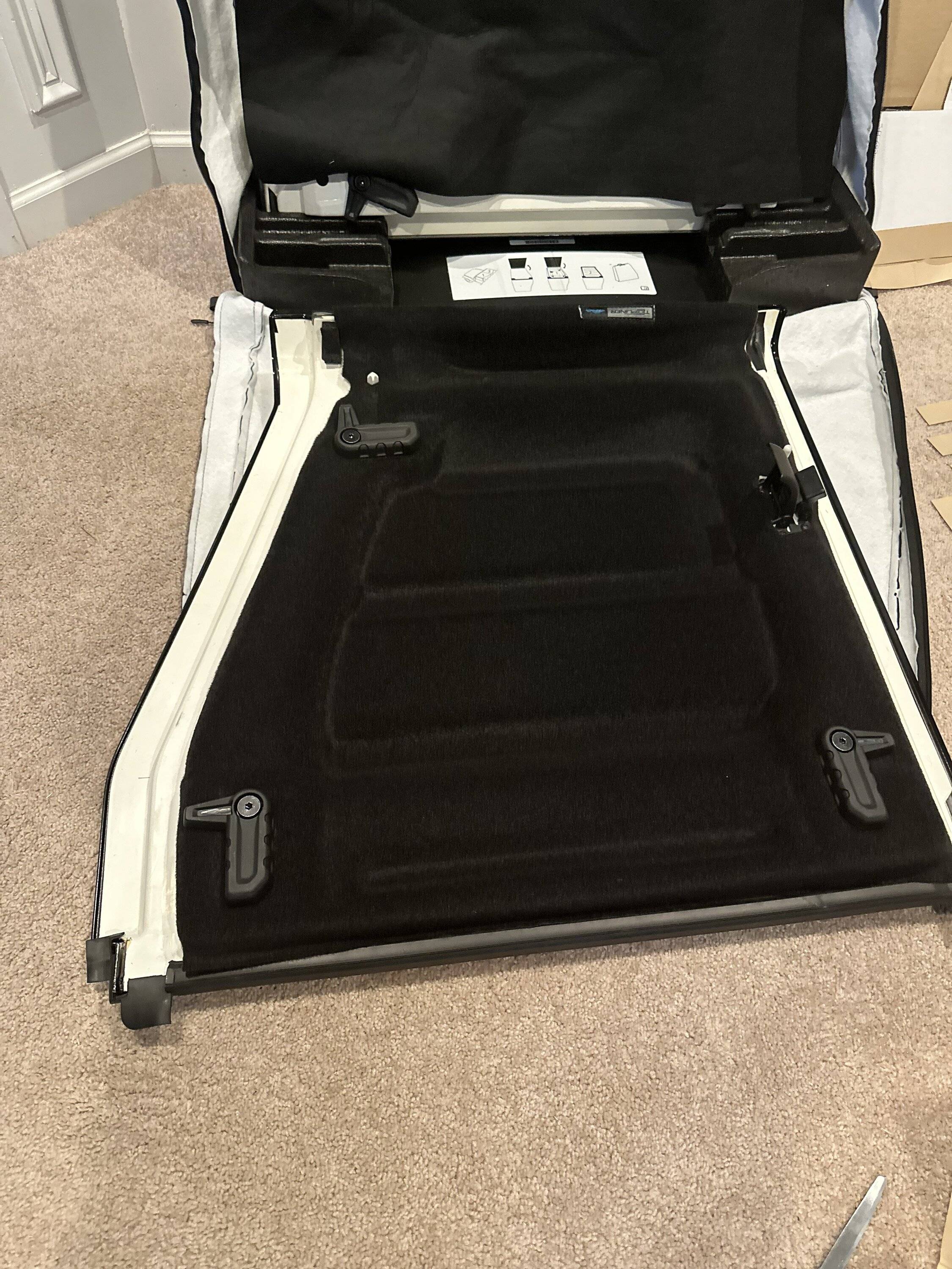

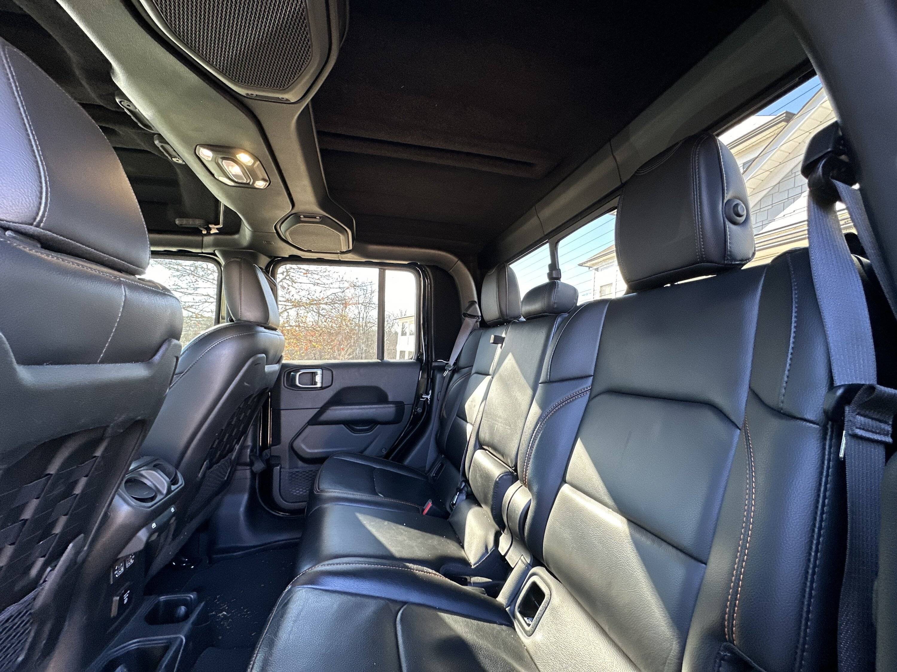

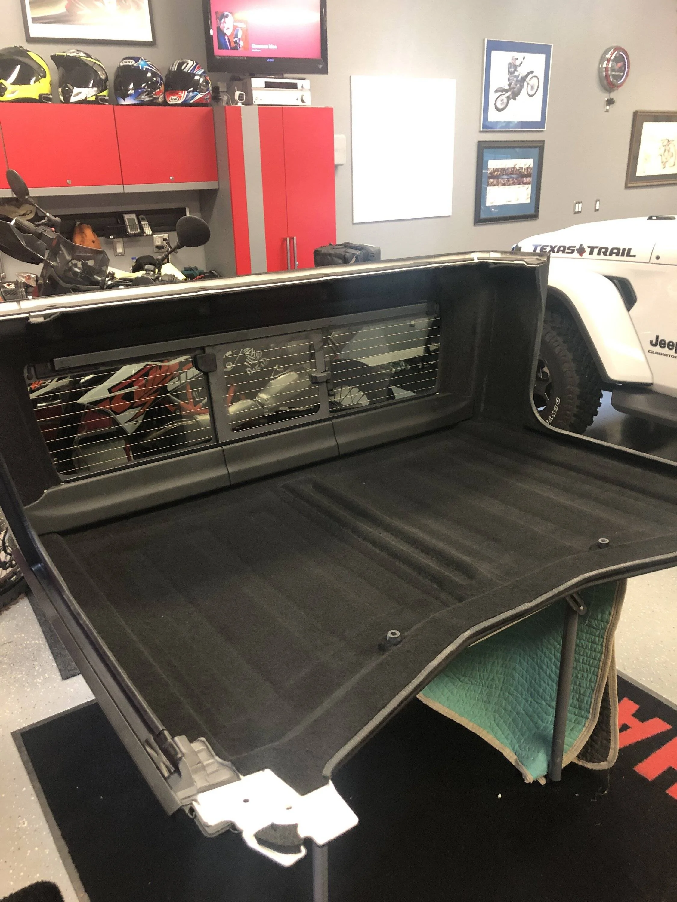

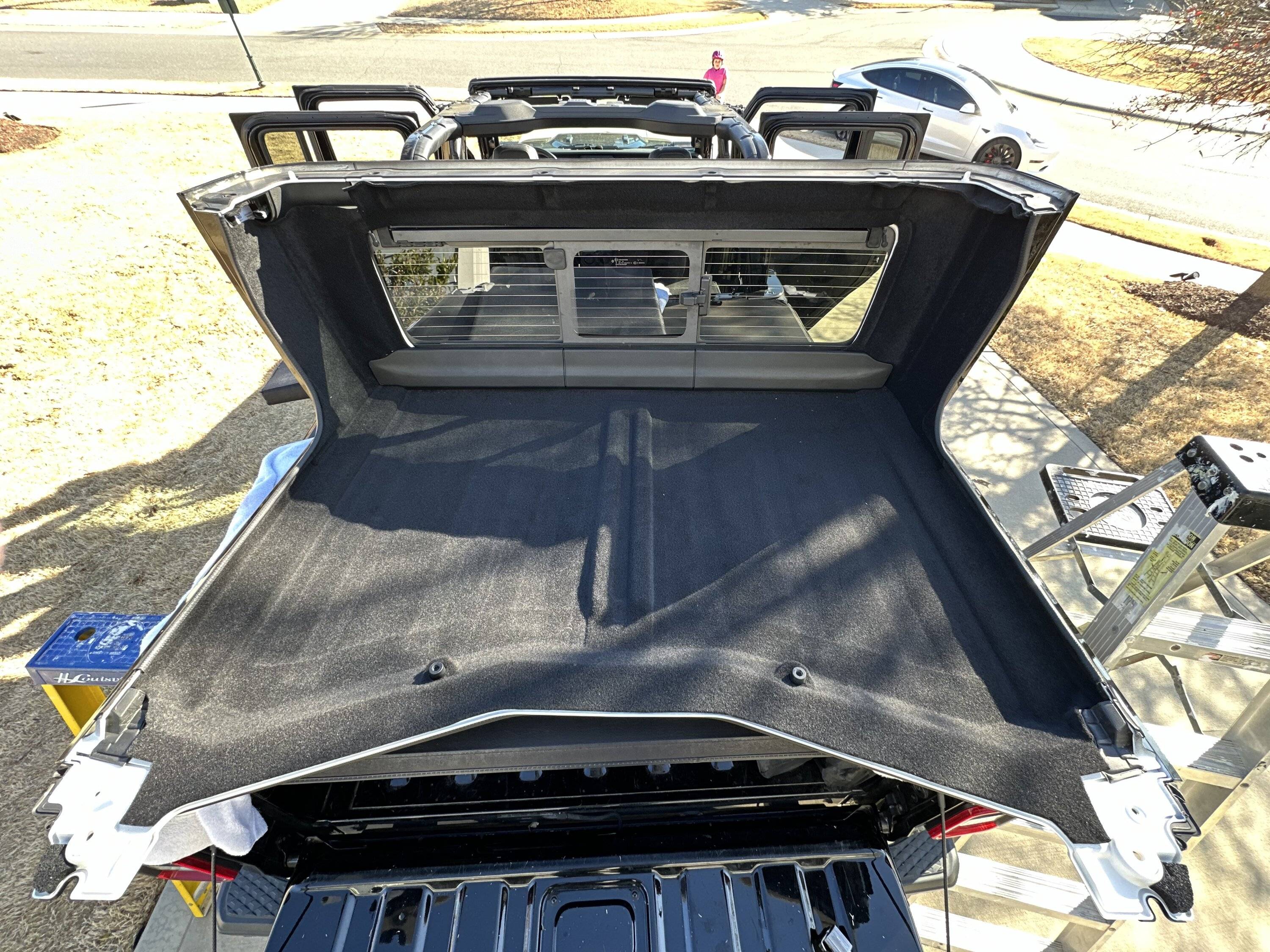

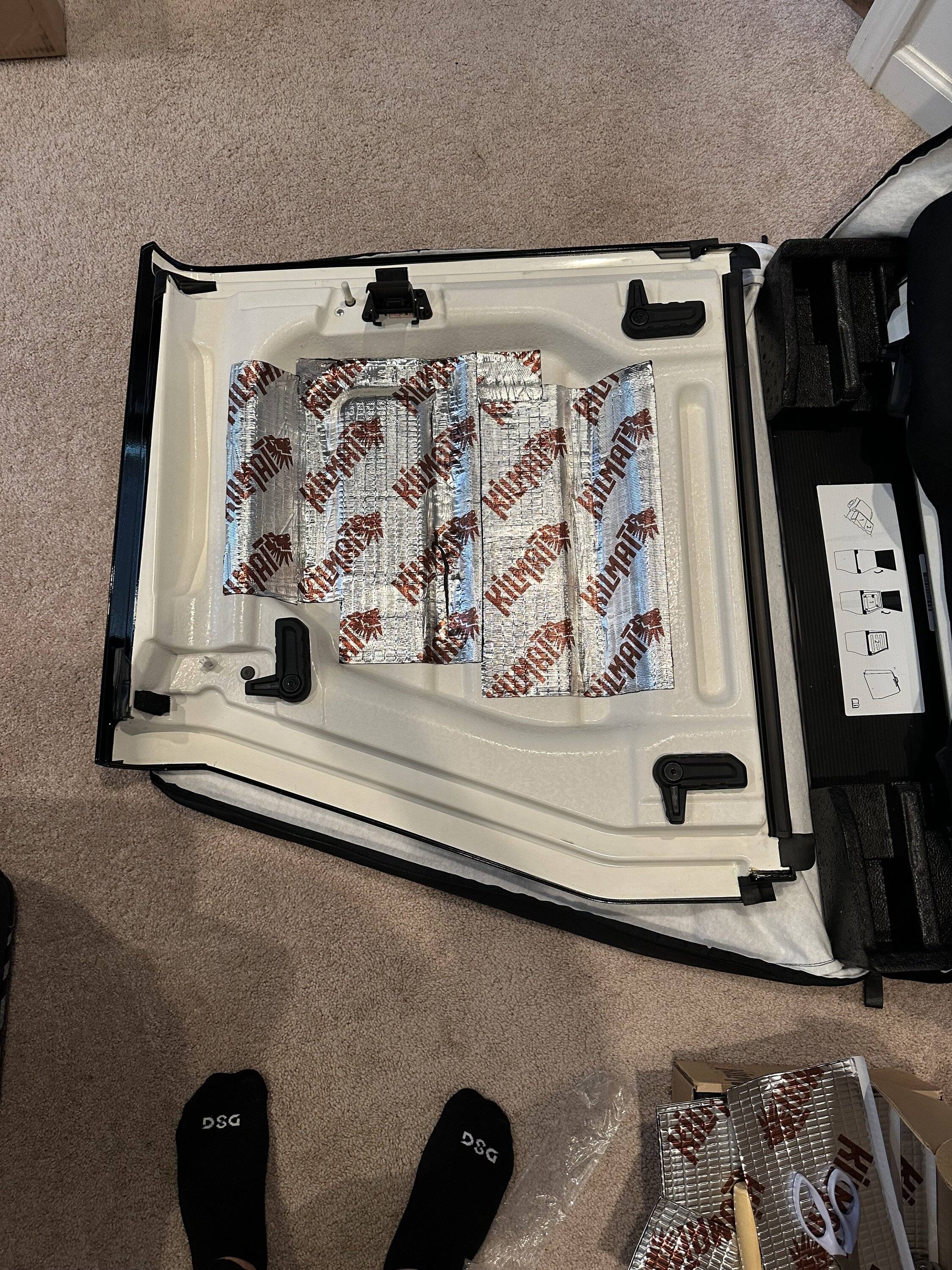

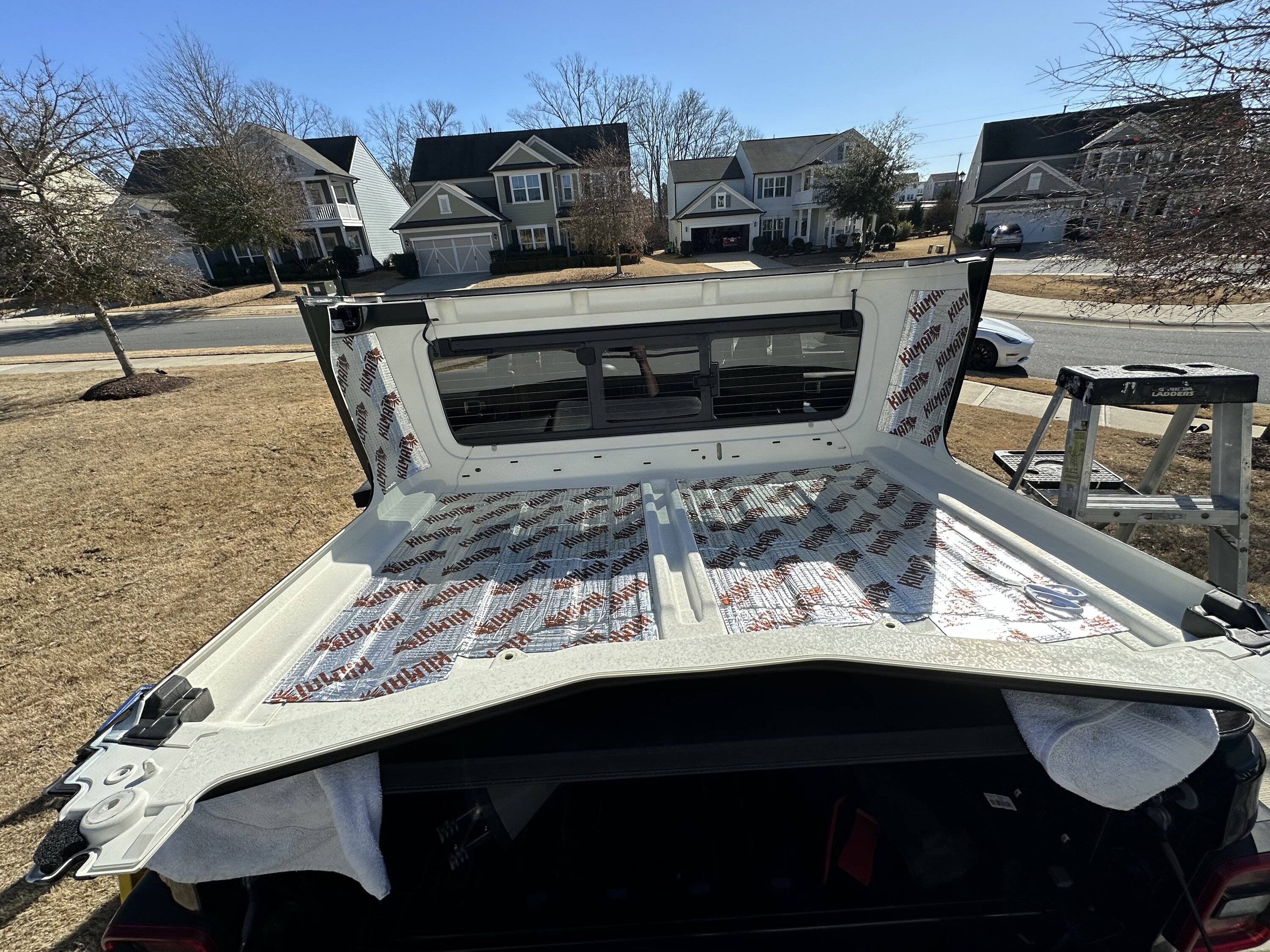

Adding my install. Front was easy and took no time. Yes the tape isn’t labeled well. You get the idea and I added just a little 3M VHB in a few places.
Rear just awkward due to size. Minor trimming and one spot hidden in the back I was probably off a bit but 95% perfect. Did 80mil under it and the sound difference is noticeable. Will test on highway tomorrow.

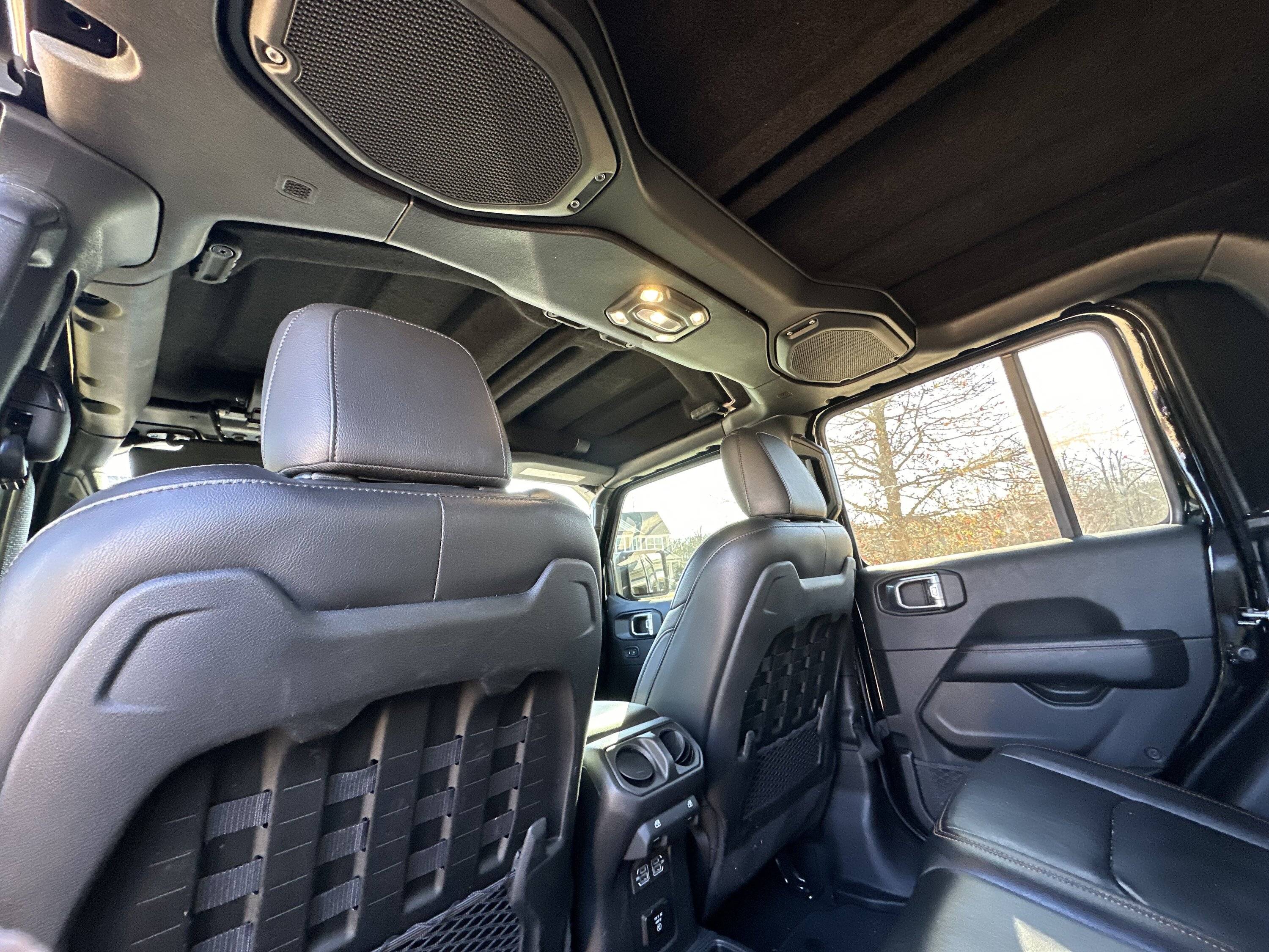

Installed this weekend. Used many of the tips in this thread to include using extra 3M double sided tape and 80mil sound mat. Had to do some trimming here and there but it was a pretty straight forward install.
Very happy with the results, wife drove it in today, temps in the negatives all day. Said it was a noticeable improvement. If she ever lets me drive it I'll find out for myself :like:
Thanks to everyone for the tips and photos!
