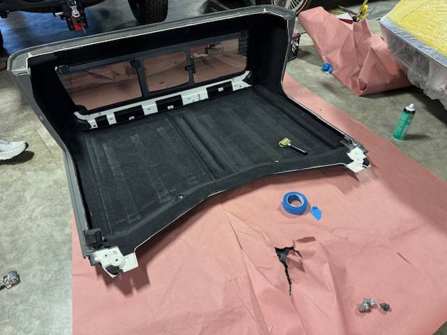

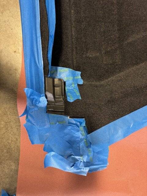

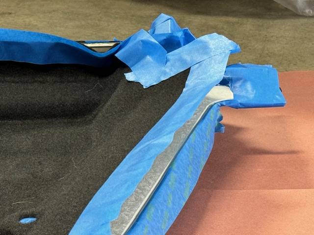

Finally got around to doing the back half of the installation.

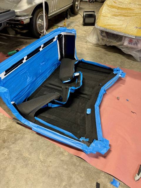

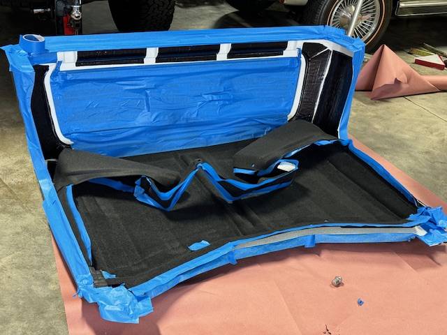

It was quite awkward trying to get everything ready to install using the spray adhesive. I taped the top and dry fit the headliner several times. The headliner needed some trimming around the plastic cover for the rear defrost wiring and the foam blocks near the front of the top.

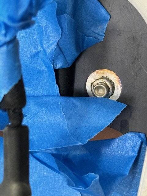

I sprayed the roof first and fit it before moving to the vertical section near the back window and C pillar. Ran into an alignment issue when I realized the rubber bumpers were off by about 1/2 an inch. Pulled it up and repositioned and it fit almost perfectly. The vertical portions went on pretty well but two sets of hands definitely helped.
I had to re-spray some of the edges to ensure a firm fit. I will definitely need to shave some of the extra material around the edges. I also need to put the edge trim banding on.
I meant to take more pictures of the process but was running short on time for other family obligations. Here’s a few.

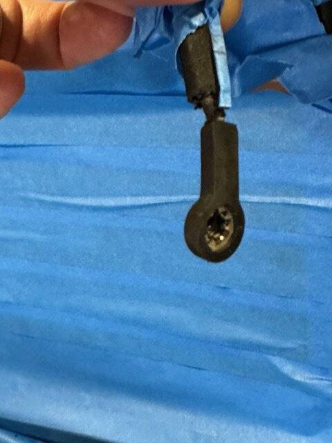

1) anyone know the part number for the rubber bumpers? Busted one trying to reinstall - looks like this is part no. 68005011AB
2) I still have a vibration coming from the back window area, is this that plastic panel rattling? Or is this just the window insert rattling - this is resolved, the sliding window was the cause

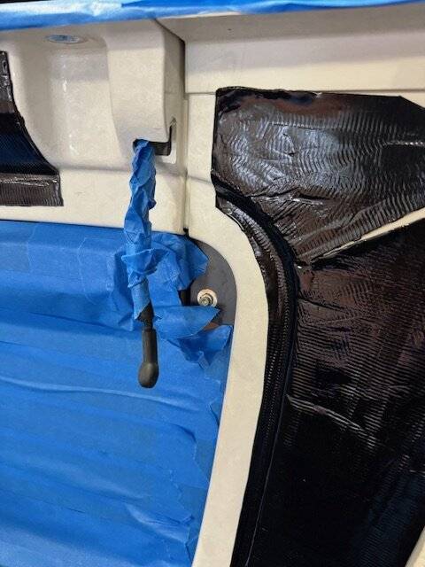

Received the topliner and kilmat today (80 mil for those interested) and got the front freedom panels done. Straightforward aside from figuring out which adhesive strips go where, and fairly tedious if you want it 100% perfect. I really like the topliner though, much better than the all white panels which are pretty jarring when I switch from my black SunRider in the summer months to white freedom panels in the winter. The kilmat/carpet combo definitely makes more of a "thud" when you hit it compared to without, so hopefully it does a decent job of deadening some road noise.
Going to do the rear top tomorrow. Below are some pics of how I arranged my kilmat and adhesive strips.
Edit: added a couple pics of the rear cap carpeting, which definitely took me a bit longer du to it all being one sewn assembly. I actually ended up just cutting the stitching that holds the small portion of carpeting at the base of the rear window which made it MUCH easier to get the rear corner sections put into place.
I absolutely wish CoverKing would provide extra adhesive strips so that you can button up certain areas that may pucker on you a bit. The fitment is close but not 100% and does require some trimming using a utility blade. But all in all, I'm happy with it, and was worth the cost and effort to install.
