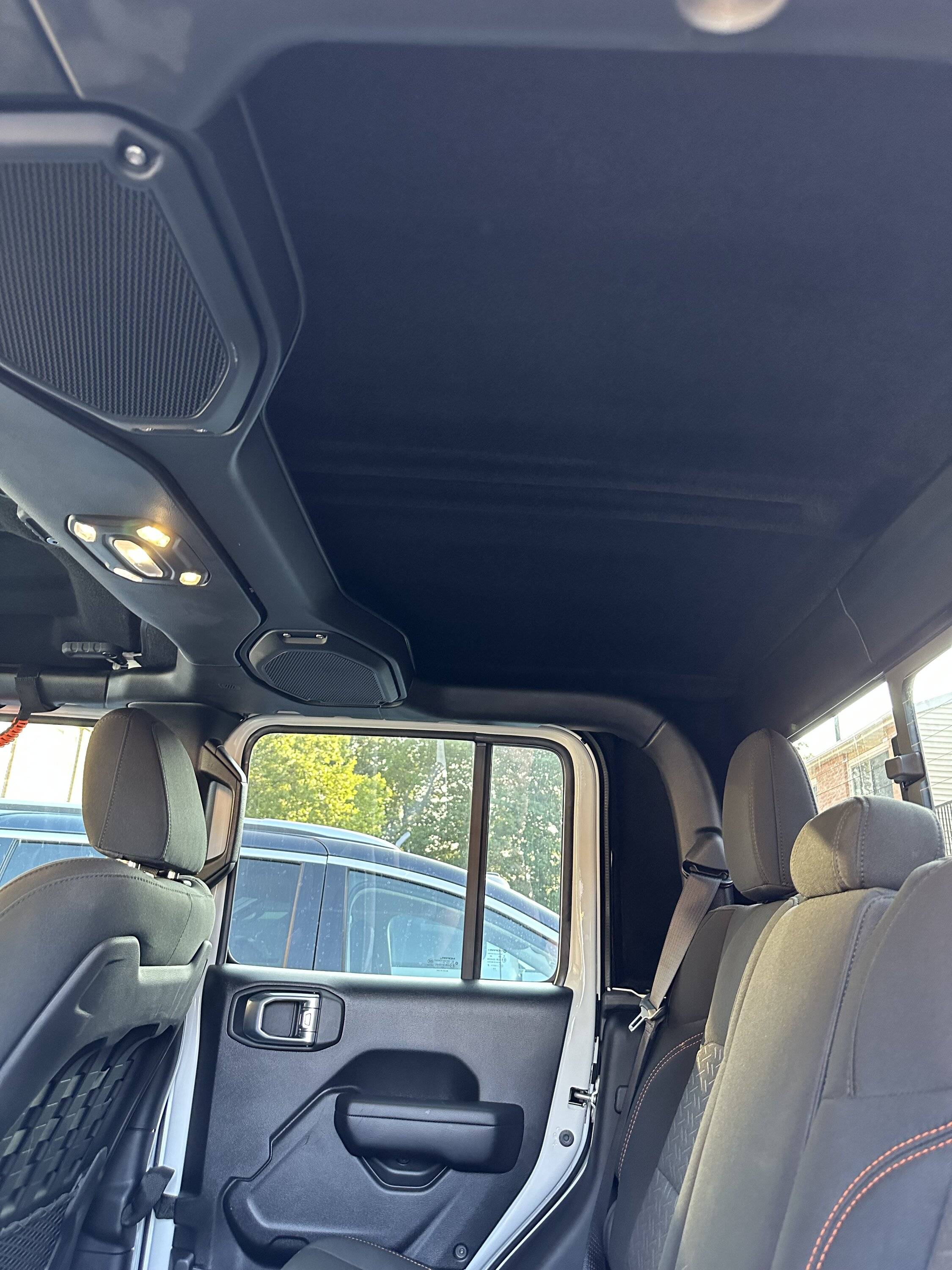

Finally had a weekend of no rain and installed the rear section. Really happy with the results and the weatherstripping was a PITA until I figured out what orientation to put it in. The kilmat did add some weight to the top towards the front. Not as bad as the TJ hard top but I did notice the difference putting it on solo.

Finally got the topliner installed on the front freedom panels... the passenger side holes lined up great, the driver's side was not so great. A little disappointed in that aspect, but it looks mostly decent. Like others, I used some 3M tape on the edges to hold it extra tight on those spots.

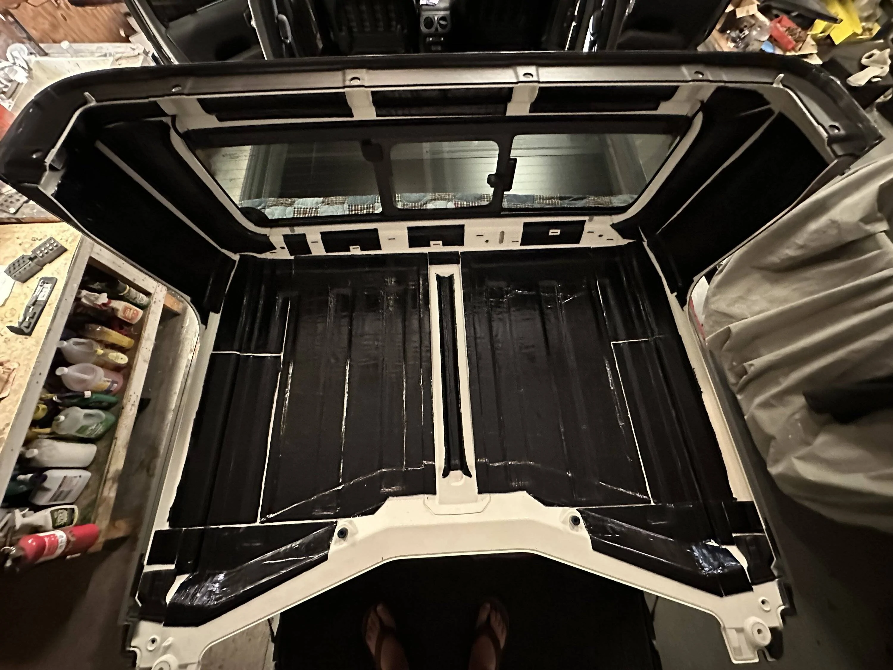

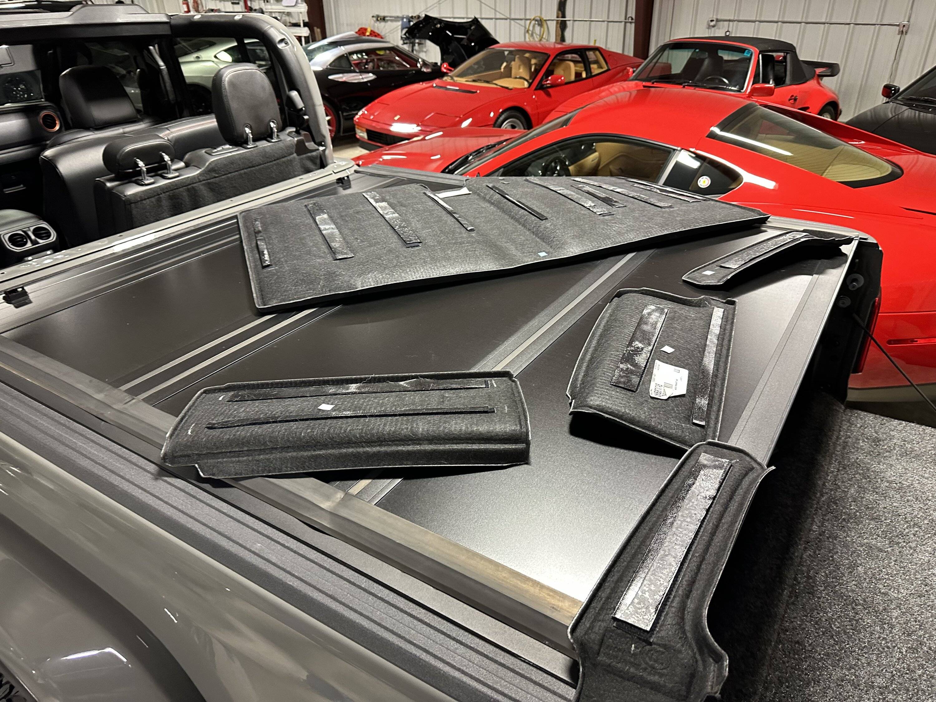

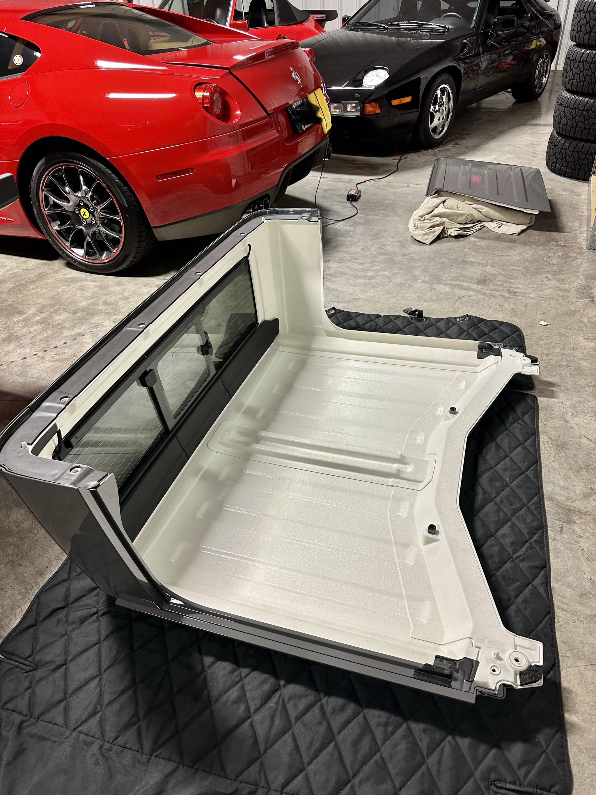

Finally made a little more progress on getting the back half of the top done. Removed the top and flipped it over to get started. Took out the OEM Mopar headliner and Velcro strips in no time. Wiped down the fiberglass with denatured alcohol and removed the leftover adhesive. *NOTE* do not use red microfiber and alcohol or you get a pink tint. :facepalm:

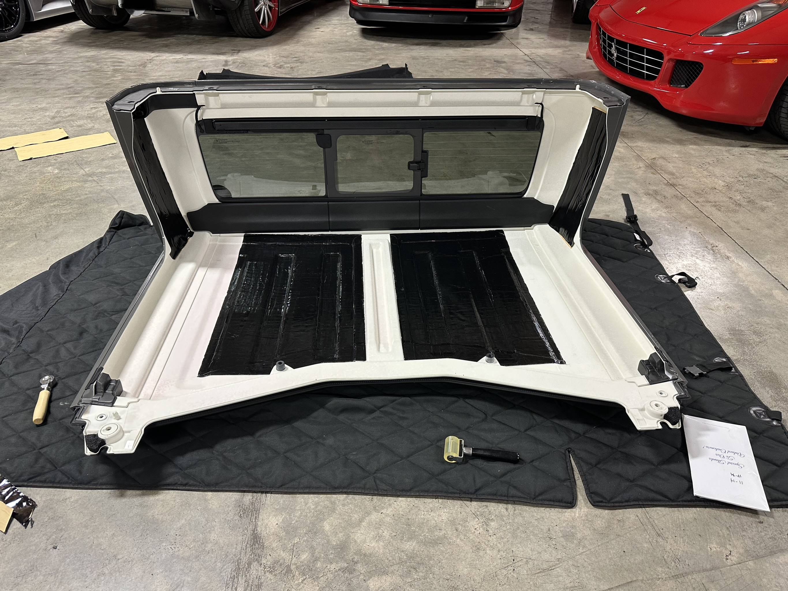

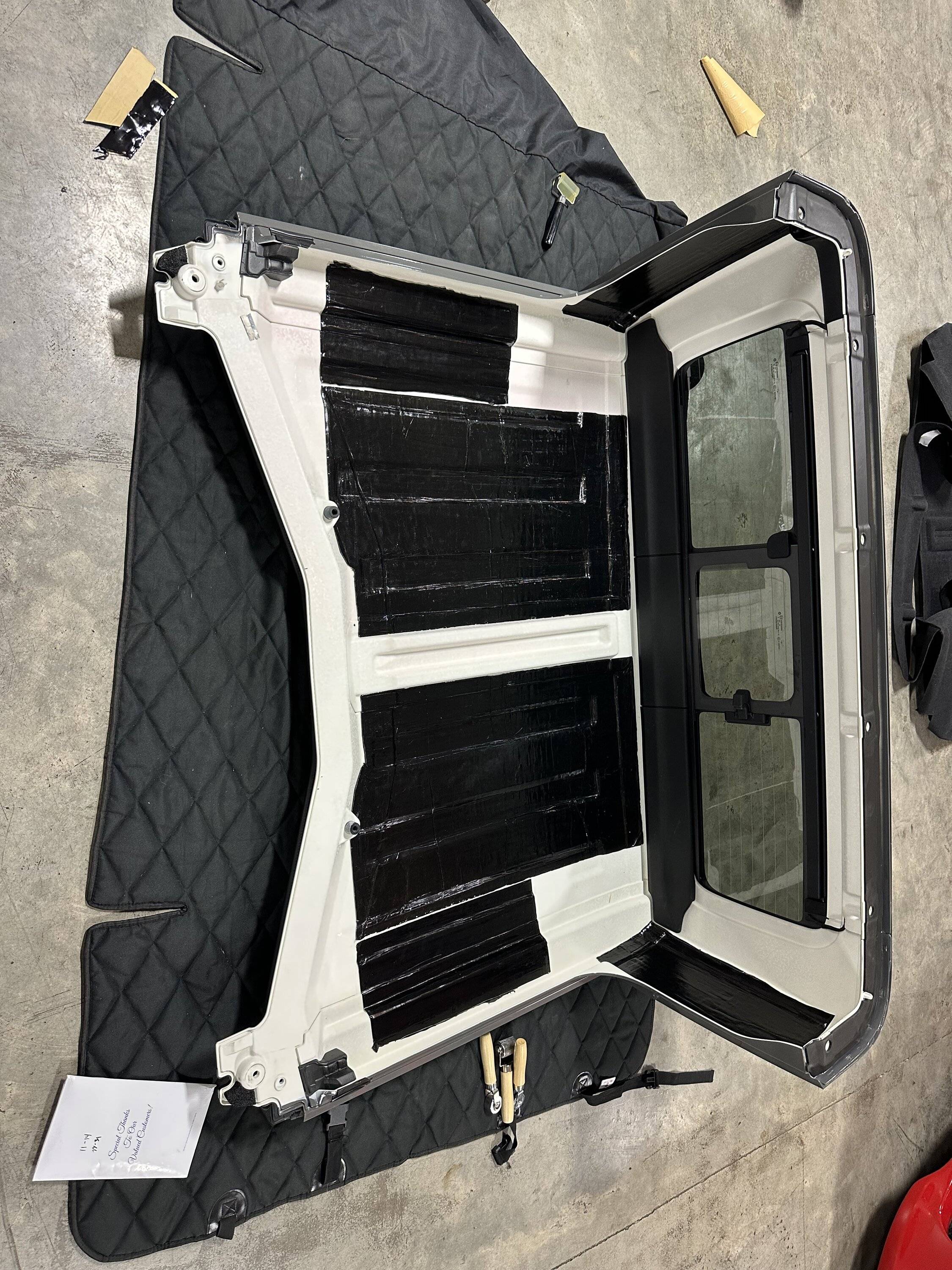

I had three full sheets of sound deadener left after the front freedom panels were done. I used two full sheets in the center with cut outs to hopefully allow the antennas to still function. I then split the third sheet into four pieces to start filling in the remainder until I receive the next batch of deadener.
The rollers were a big help over the old method I used for the freedom panels. Definitely worth the wait to get them.
I’ve popped the top back on until the additional sheets arrive. More to follow….

Thanks for the pics. You definitely added way more sound deadener than other installs that I have seen and I want to do the same. This and a bed cover are my next two projects and the pics really help. Where is the Satellite antenna located? The white section you left exposed in the middle of the curved section of the top?
Viper501
Oct 1, 2022
716
1,016
COLASC
2022 JT Sting Gray Mojave; 2025 Range Rover Sport, 2020 Mercedes GLE (Gone)
Ninja
@PDACPA Yes. When you take the top off you’ll see two antennas on the top of the roll bar. I should have taken pictures of those. One resembles the stick on Sirius / XM antenna and the other is a bit larger and I assume it is the GPS and U-Connect interface. I erred on the side of precaution since I want to preserve the reception of the GPS and U-connect (Sirius / XM is not something I use / care about but tried to future proof things just in case. Once the sound deadener is on I do not want to think about trying to get it off. If I had not used the aluminum backed material I would have gone right over the whole thing. However, I think there is plenty of coverage as is.
In applying the sound deadened I kept going back and looking at where the large surfaces were that had a hollow or tinny sound. Tapping your fingernail, or the tip of the tape measure, on the fiberglass helped identify what needed to be covered. I also wanted to get as much heat reflection as possible. I figured while I was there I may as well do it right.
One thing I forgot to describe above was the plastic trim piece at the top of the back of the main top. It is a PIA to get off and I ended up breaking one of the plastic stanchion stand offs. It is a two piece design but it is joined together by a clip so it all came off together. I’m debating whether I replace the trim or just see how it works first. I am leaning toward not worrying about it right now and see if it makes noise.
