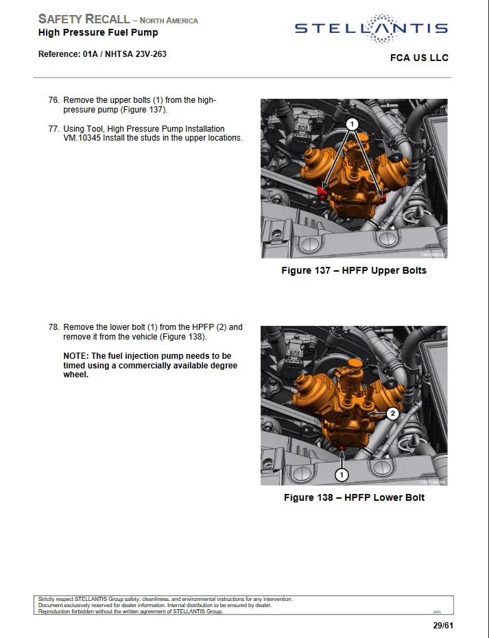

Removing the pump isn't to difficult but you need to remove the grille, radiator, condenser, etc.. to give yourself some room for the bolts and pump to come out. The pump needs to be removed straight out as it is pressed onto a gear attached to passenger side cam.

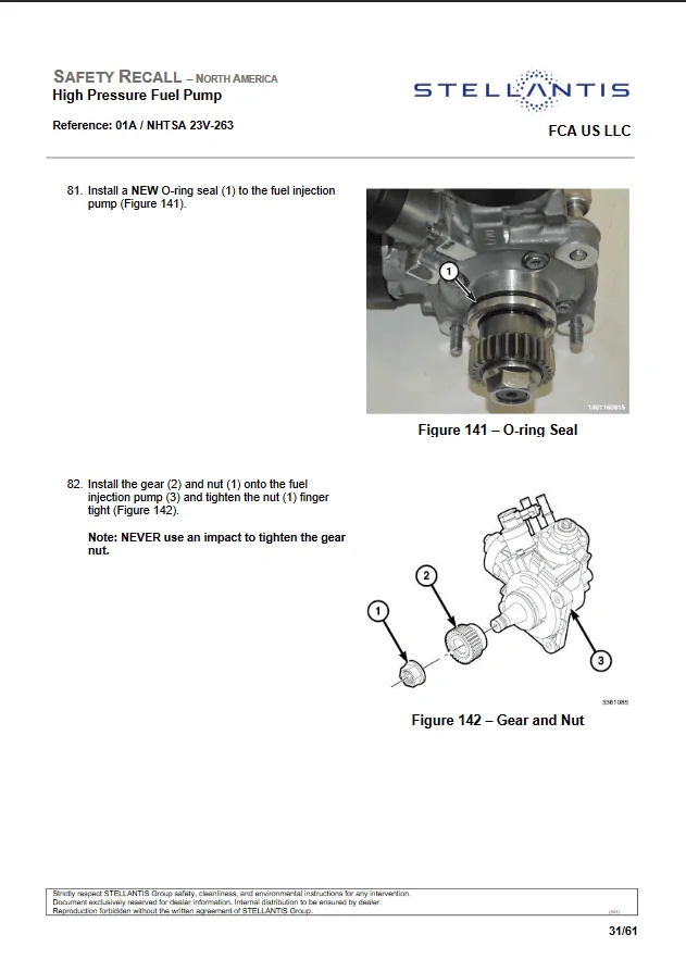

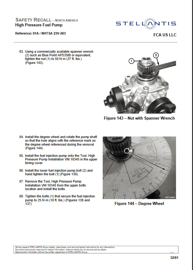

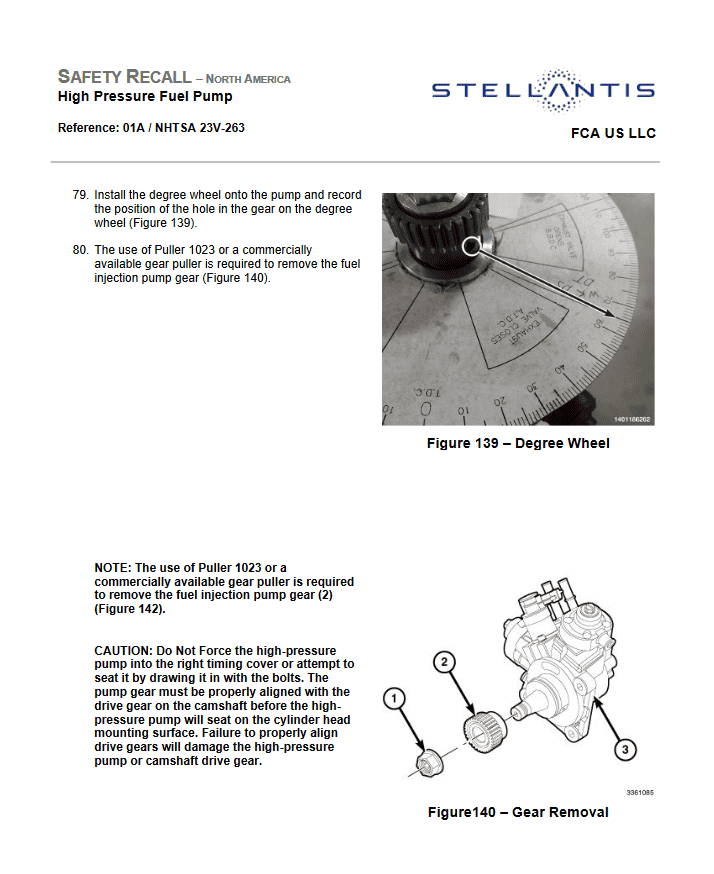

Looks like this is back as an option for me. Its basically lick and stick. You use the degree wheel to make sure its 100% aligned. Easy enough. doesnt say how to align the degree wheel? :

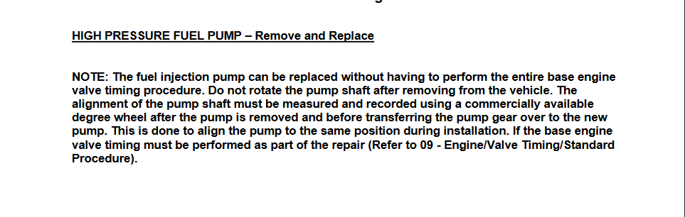

It sure does tell you how to align the degree wheel. You make a reference mark prior to removing the old gear, and then align the new one with said reference mark.

It sure does tell you how to align the degree wheel. You make a reference mark prior to removing the old gear, and the align the new one with said reference mark.
You place the degree wheel on the pump.....is it up is 0? Do you align 0 with a notch on the pump?
It does not specify. How are you going to get the degree wheel on 2 pumps in the 100% exact spot? Should be clarified. Still easy to figure out.
I mean, yes? You index it to a constant, whatever that may be. Some are keyed, some are not, but they all work the same way. You could even use your own index point so long as it's stable and repeatable. This is how these tools work. They're relative position tools, not absolute position.

The gear could end up 1/2 tooth off and the pump could then rotate 1/2 tooth either way during install to line up with the cam gears? I think the big thing here is that the pump doesn't end up unloading at the same time as the rest of the valve geartrain is also unloading so a rattle doesn't develop?

Turning something 100 degrees is 100 degrees, whether you reference the start from 12 o'clock or 8 o'clock it will turn the same amount.
