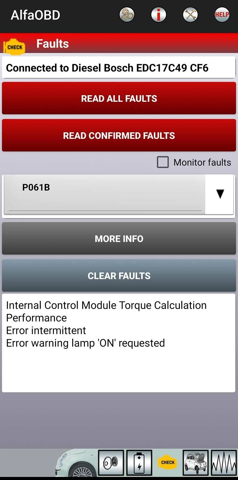

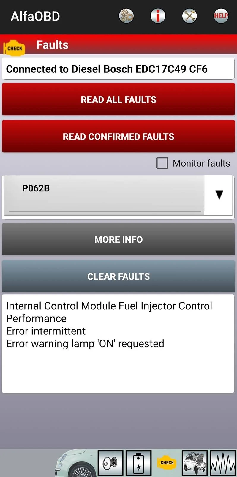

Well, my saga continues. This morning, I was leaving the house and heard a small rattle noise and turned down the radio to see if I was hearing things or if my jeep was making the similar noise I heard the last couple times that my jeep stalled. And it was in fact my jeep making the same rattling noise. But this time it didn't completely stall. I pulled over and as I was doing that the CEL came on. This is the first time that I have ever seen the CEL come on. Ran the codes and it pulled P061B and P062B. Both related to control modules. 61B is for torque calculation and 62B is module for fuel injectors.
So, back to the dealer it goes ans i will most likely be starting a buy back and get a new one, hopefully.
