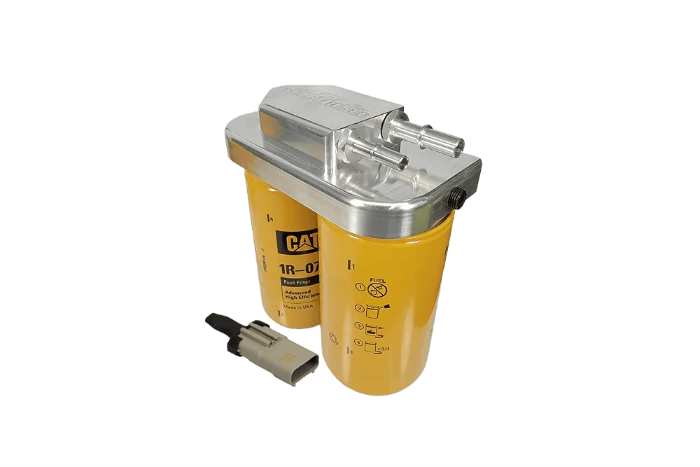

One day I might get board enough to figure out what it would take to put a spin on caterpillar 2 micron filter on and ditch this Mopar filter…..
Our TDI’s have caterpillar filters and they are awesome…. Larger, and better filtering media…. And just “easier” to change.
I am planning to install the cat filter on mine. I installed the filter/water separator on my 07 cummins since those didn't have the best stock filters and it worked good. It was similar to this

Just picked up my ecodiesel a week ago so have some other things planned first but here is the set up I am thinking about.
https://blackmarketperformance.com/products/2014-2019-ram-ecodiesel-bmp-cat-fuel-filter-kit
