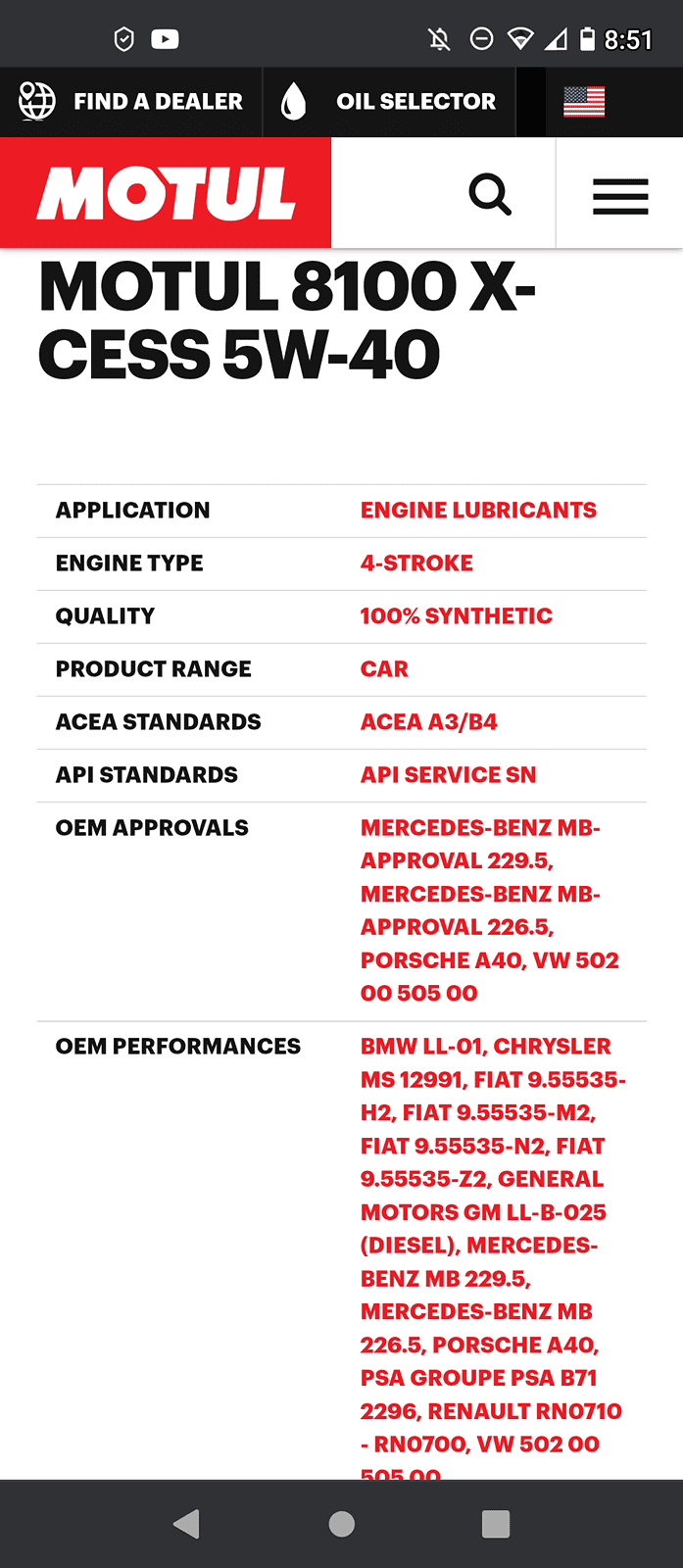

Looking to extend DPF lifespan. The newer lower SAPS oils do that but Jeep calls for the opposite. I am unable to find what exactly ms12991 is, what are the specifications? I have found "1" motor oil that satisfies 12991 and is Mid level SAPS.
https://www.motul.com/en-US/products/17700?product=MOTUL+8100+X-CLEAN+5W-40
Owners manual calls for Mopar oil or similar A3/B4 and ms12991 (full SAPS). It seems DPF must not be an important factor if the cloggiest oil there is is what is required.
I've been running this exact oil since my Jeep wave 3 free oil change was done. A hair over 52k currently and change it every 7k. I have never had the oil analysis done. No DPF issues as of yet.

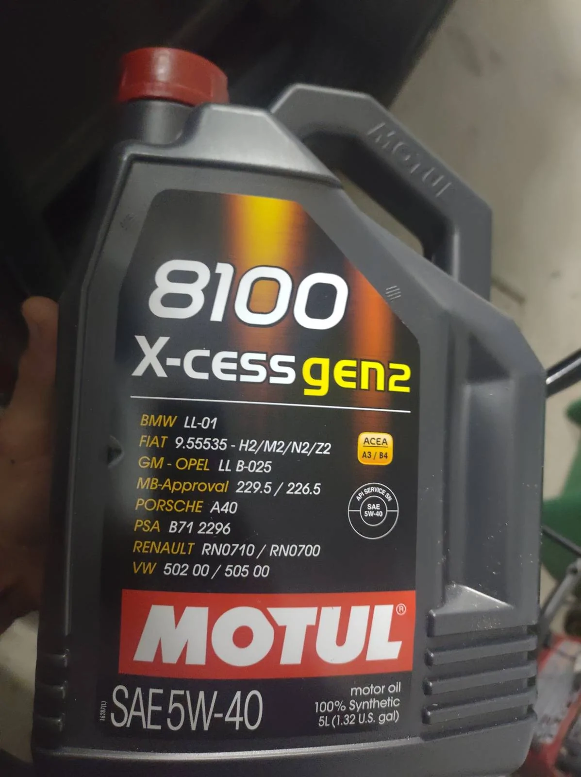

Which exact oil? Mopar or Motul?

This one

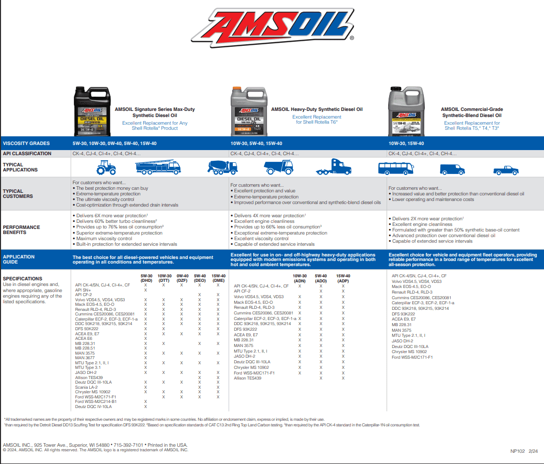

So far, Amsoil MS and HPL has shown to be the best oil for the Gen 3 EcoDiesel, but the XClean Gen2 isn't too far behind those two oils.

For those who are worried about SAPS, I have started a list of suitable oils for the Gen 3 EcoDiesel. In this short list, you can see why Amsoil MS will be superior for DPF longevity.
OilSAPS%
Amsoil 5W-40 MS EuropeanMedium0.8%
Castrol EDGE Euro 5W-40Full1.2%
