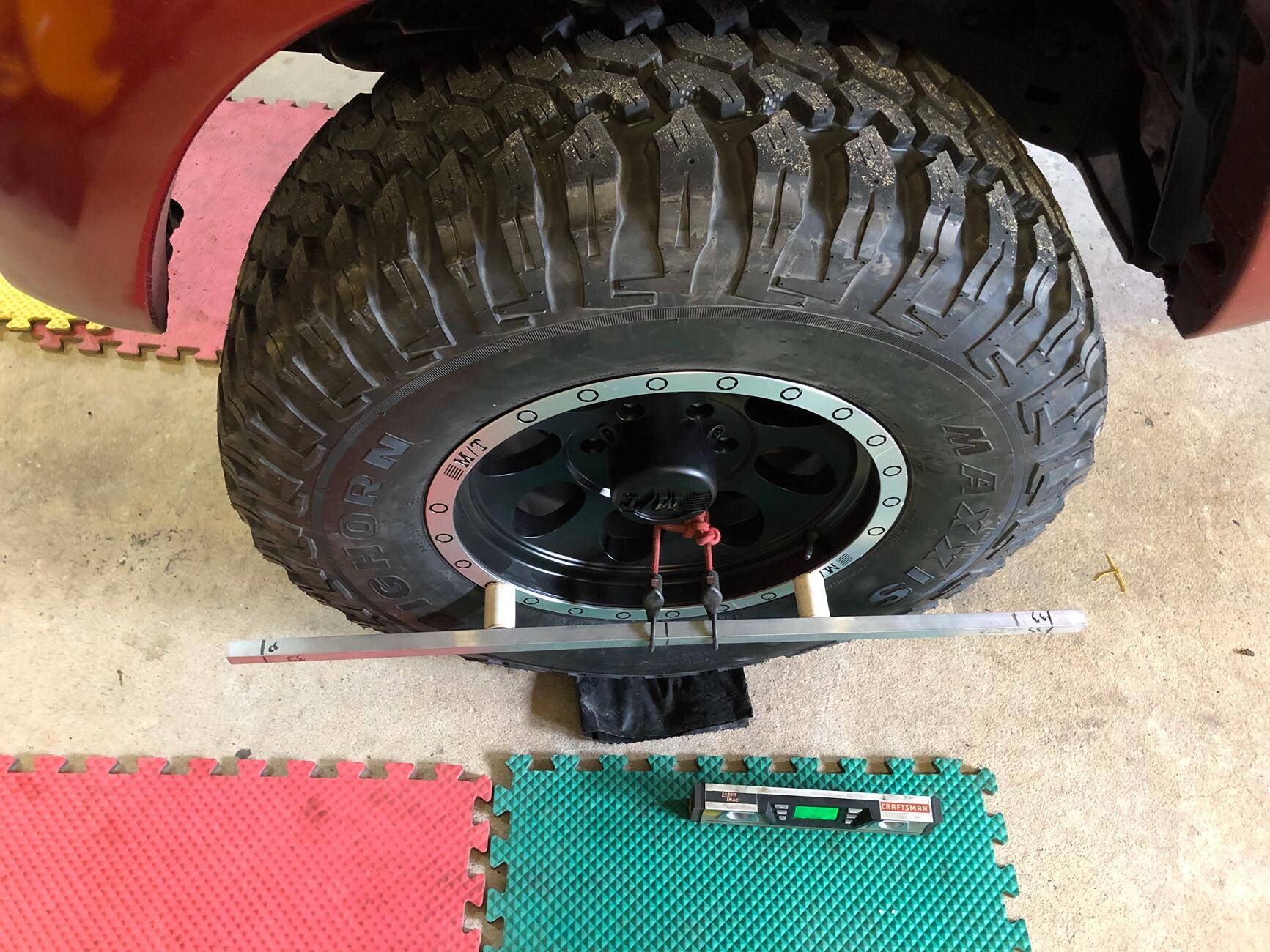

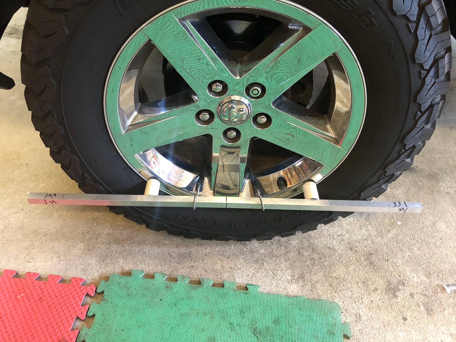

Only issue I see doing it from the rim is you are only measuring at about 17" apart . Now if it tells you in degrees thats fine . I prefer to measure about 36" a part when measuring in inches .
Jeep Gladiator Deal Alert: Digital Toe Meter for $11 tempImagexWyjG4
Jeep Gladiator Deal Alert: Digital Toe Meter for $11 tempImageXLfDkb
40,493
54,049
Easy enough to get degrees.
Degrees mean the same toe regardless of tire size.
If you are measuring out 36" then you are way off for my stock Mojave tires. It will give you a number in inches much larger than I'd get measuring off the 33" tires.
But then toe should be adjusted according to multiple factors......... tire size and more.

Retired Operating Engineer Local 825
Isnt that what I said , in degrees it dont matter . I figured it was given where you measure depends on the tire size and I doubt any one is running a 17" diameter tire which is what I was referring too when the poster mentioned he measured from the edge of the rim. I doubt their are many people who still have little tires on their rig setting their own toe now that the tie rod is not connected to the Draglingk like the TJs were, meaning their is a lot more you can do to the rig without needing to monkey with the toe
