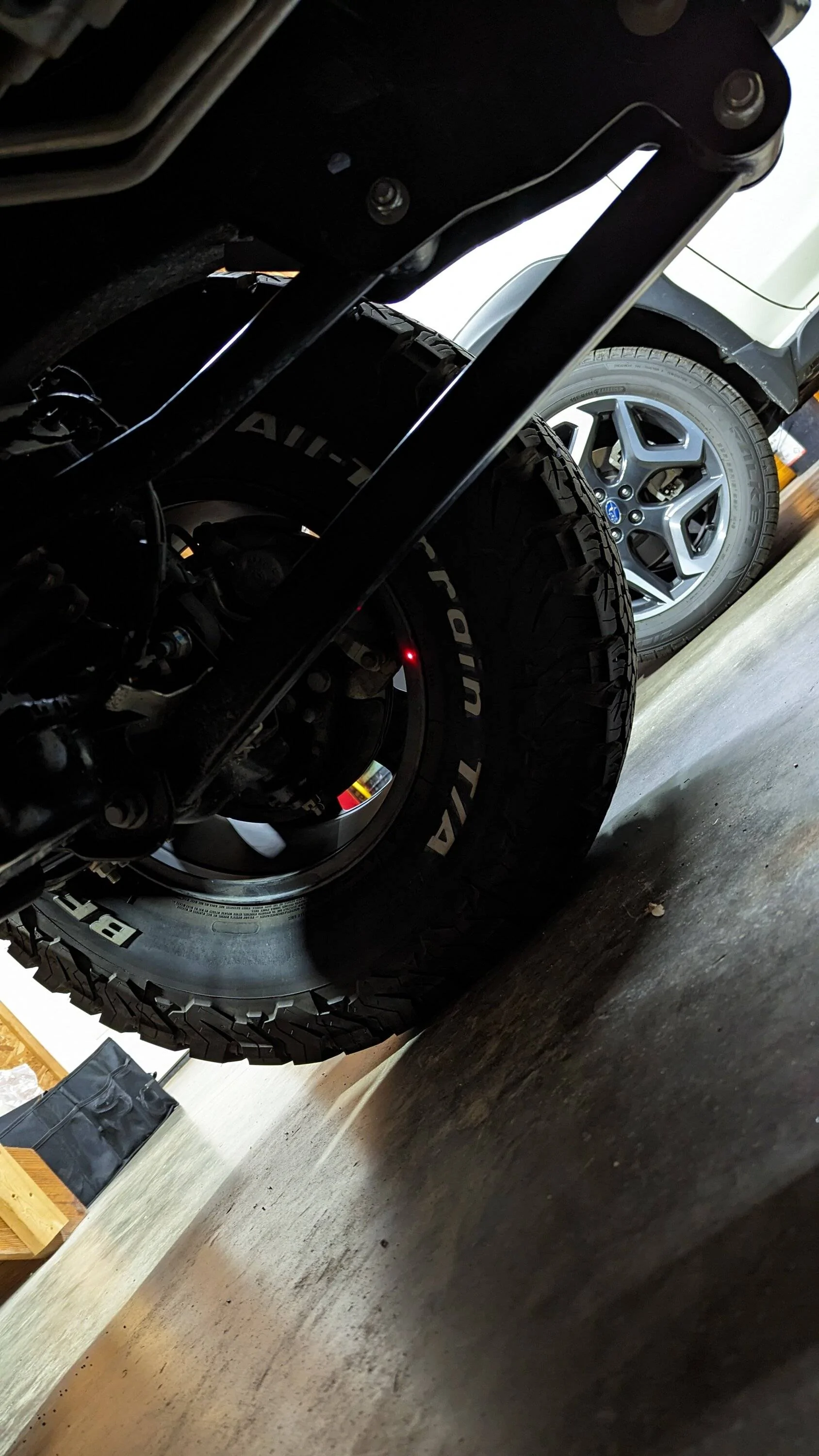

I got curious and took a picture of a random on lot vehicle. Anyone see what I see? (Yes truck is level in our drive through, the othe side was identical)
Remember that your floor slopes toward the drain on both sides, and the Jeep is straddling the drain. It makes it look like it has positive camber.

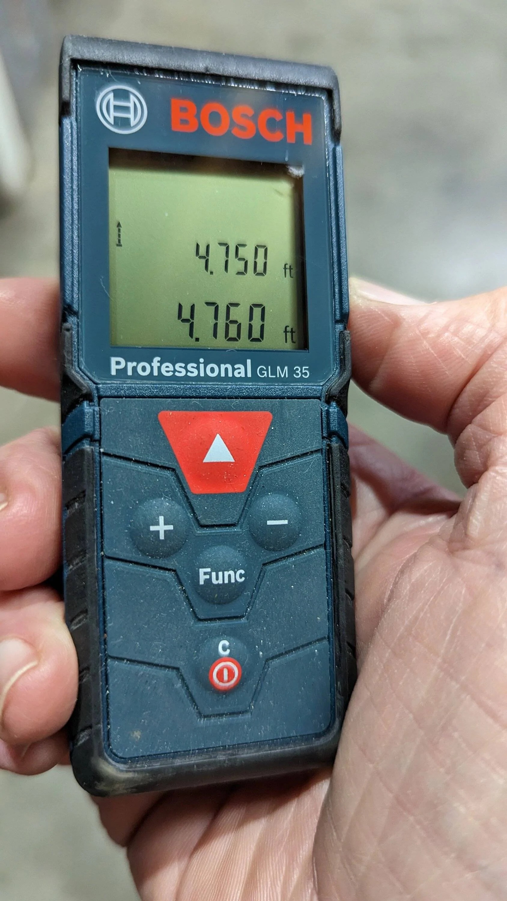

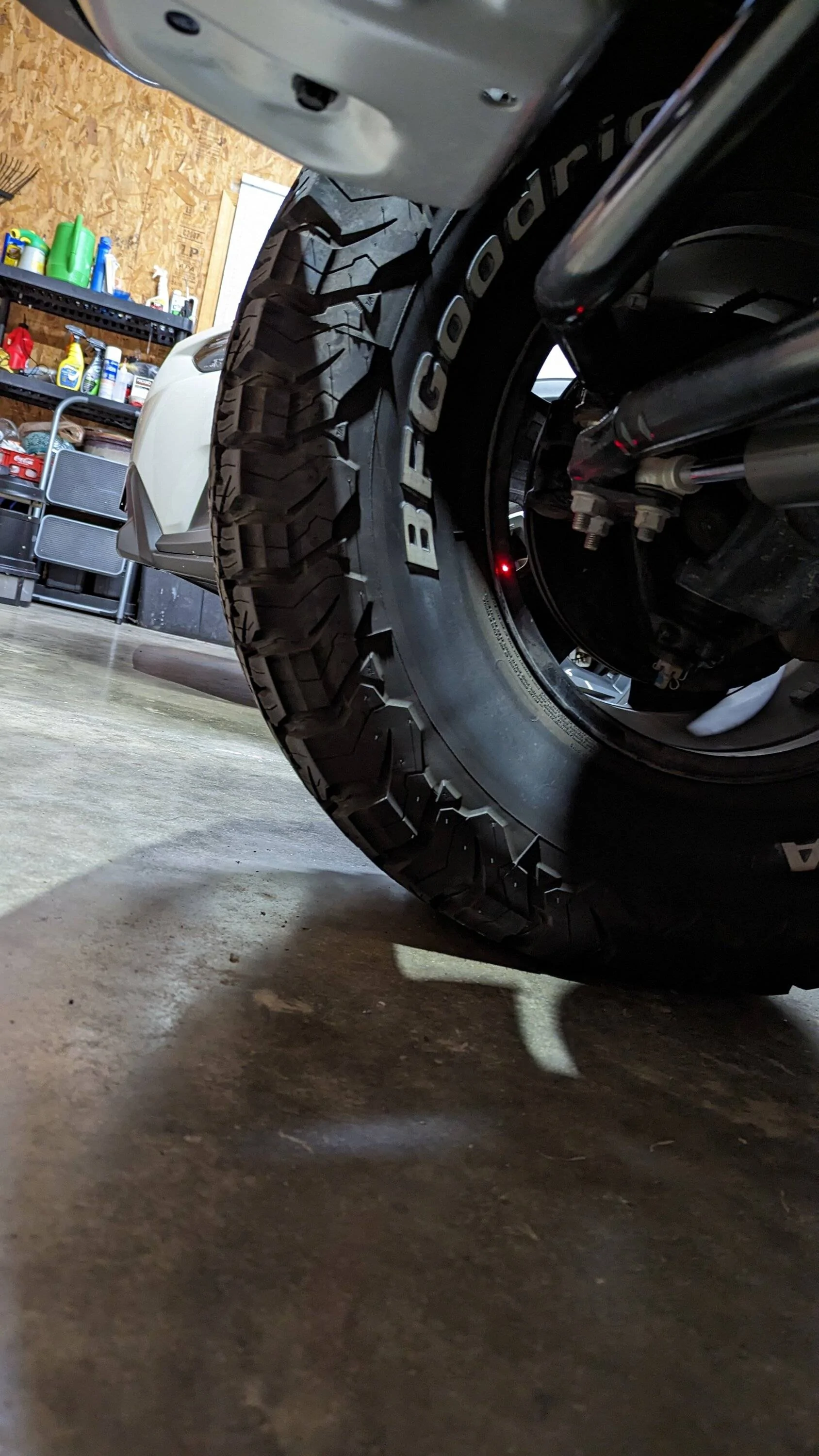

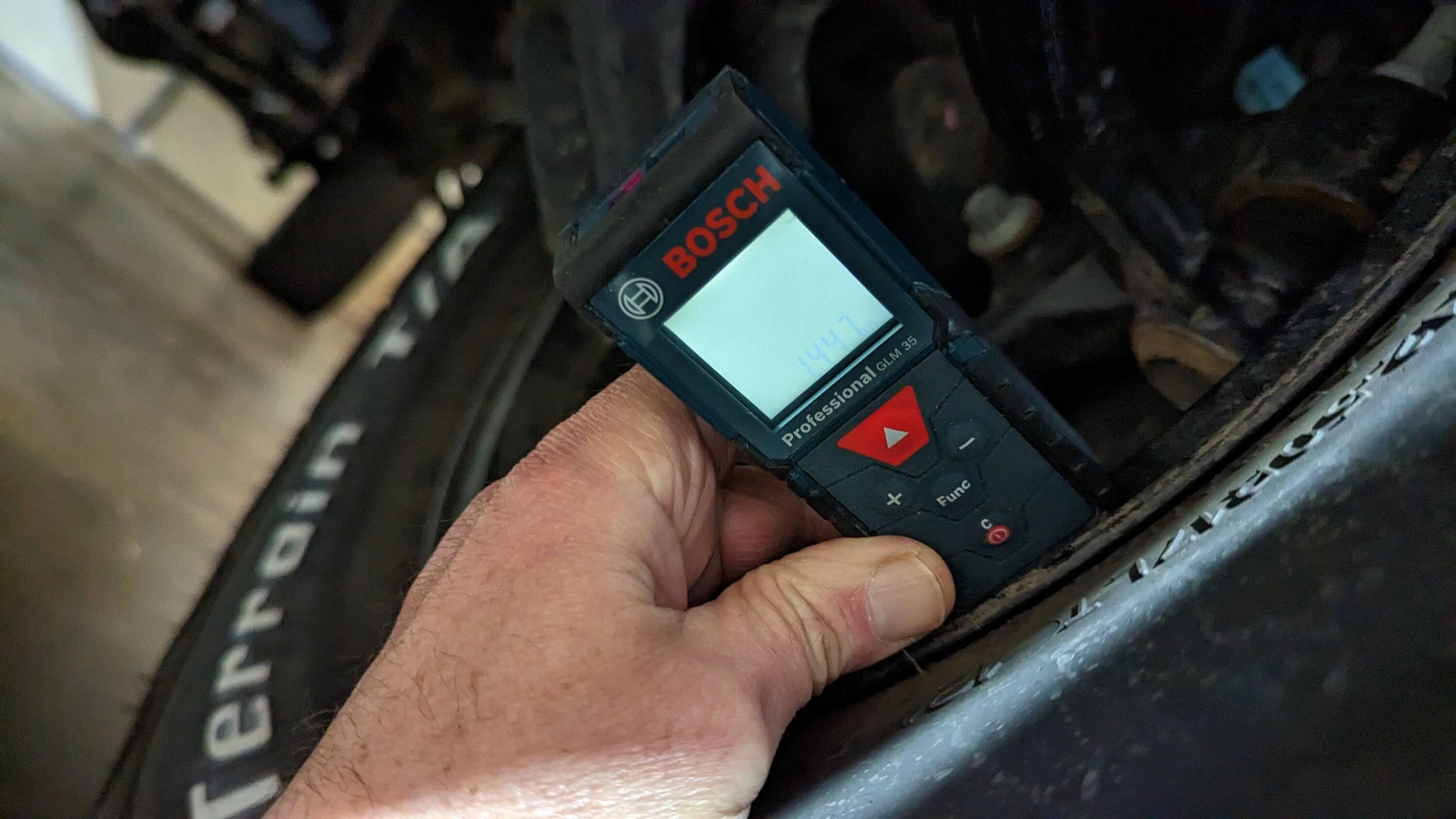

I'm not saying this is the end-all, but if you're having issues with handling, it's a zero cost try.
Obviously, the farther you measure from center the more the number will be in inches or millimeters.
I like the laser on the flat of the rim. It seems to get the same number every time.
This is an amazing idea. My 1 week old JT rubicon seems to wonder a lot more than my jk or TJ did. Was able to rule out bad alignment in 30 seconds
