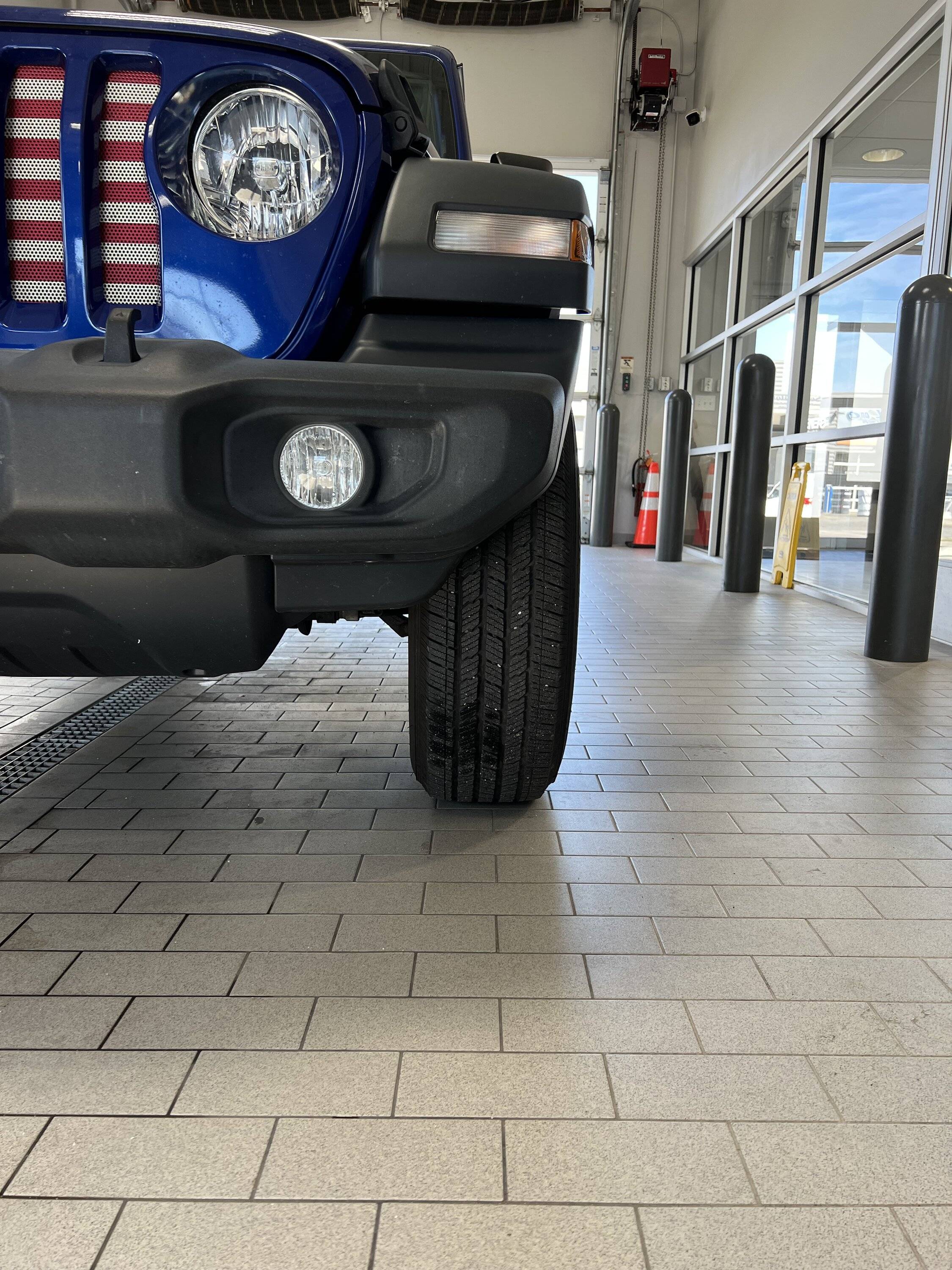

I got curious and took a picture of a random on lot vehicle. Anyone see what I see? (Yes truck is level in our drive through, the othe side was identical)

The floor is not level.

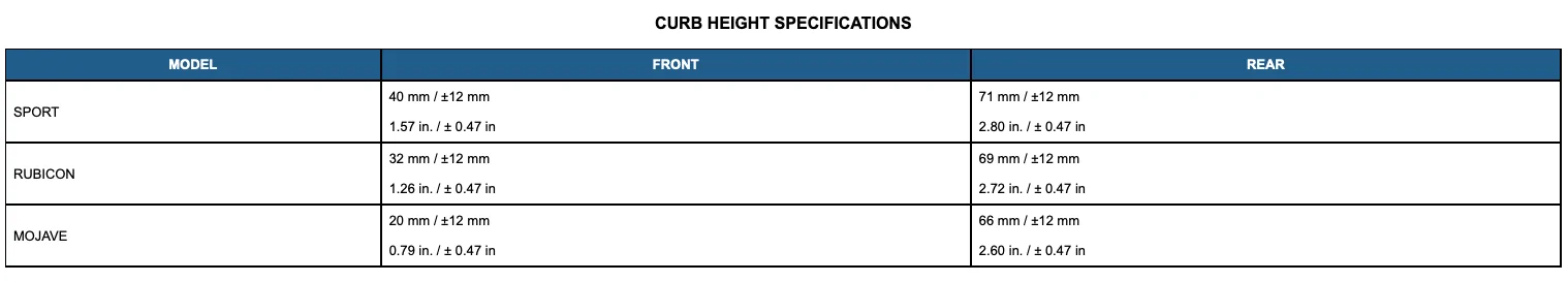

Also figured I'll throw this is, Factory curb height.
REAR CURB HEIGHT
  1. On each side of the vehicle, measure the height from the center of the lower control arm front bolt (1) to the ground.
  2. Measure the height from the center of the rear wheel to the ground.
  3. Subtract the lower control arm bolt height from the wheel center height to get the rear curb height.
FRONT CURB HEIGHT
  1. Bounce the front of the vehicle five times.
  2. Measure and record the dimensions
  3. Measure the height from the center of the lower control arm rear bolt (1).
  4. Measure the height from the center of the front wheel to the ground.
  5. Subtract the lower control arm bolt height from the wheel center height to get the front curb height.
This might ruffle some feather lol. ALso explains why my Sport was noticeably taller compared others with metric 35s
