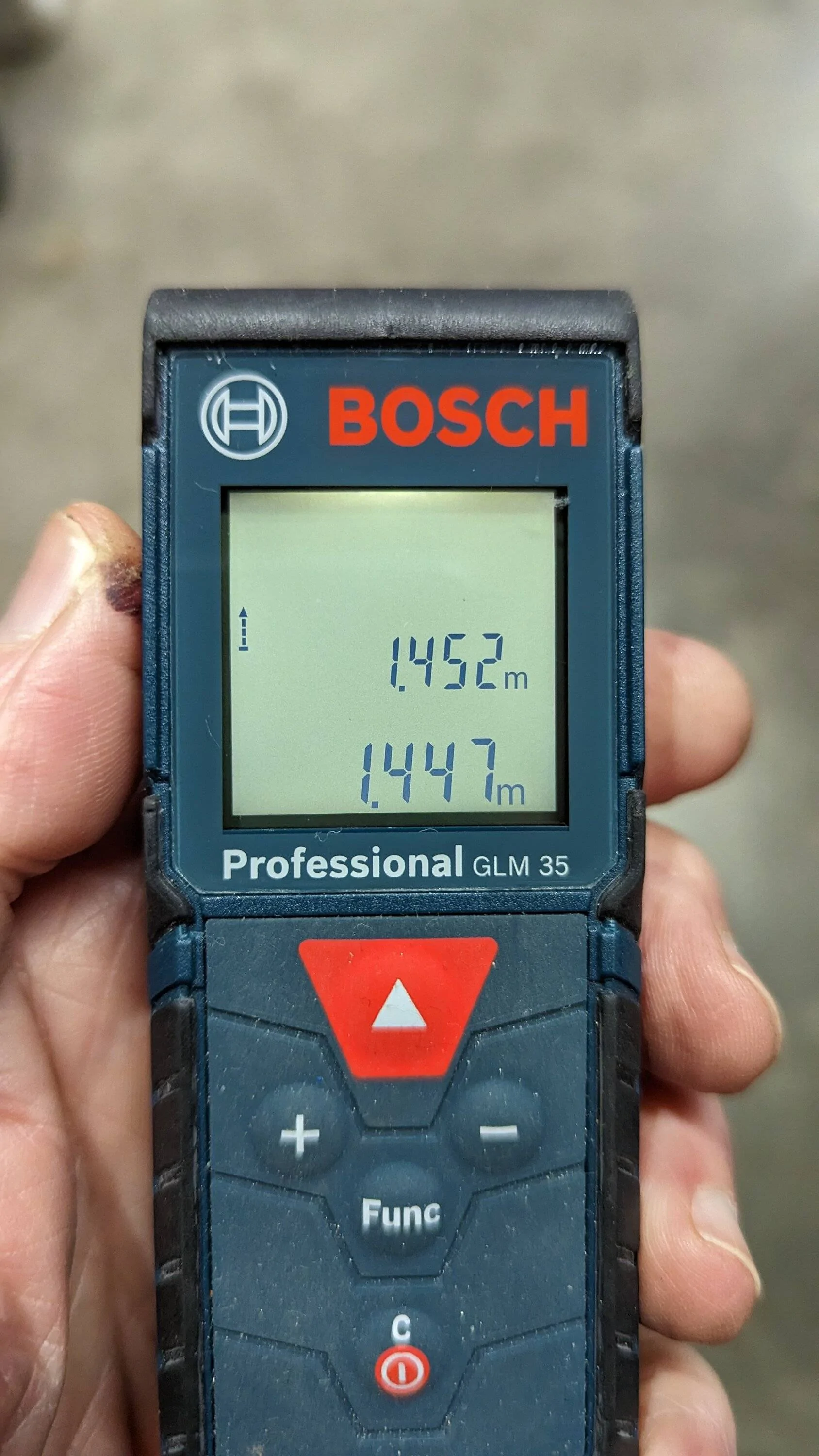

my point is that the degree of toe spec’d is so small that 1/16” of error, TO ME, is too much. Like I said, if the error is 1/16” wider for the front and 1/16” closer for the back, no matter how many times you repeat that measurement, you’re now how many degrees toed out? Im bad at math :p

Difference of 1/16" from front to back measurement on a 17" rim is roughly 0.2 degrees. That's a lot when the spec is 0.20±0.20 degrees
atan((1/32)/8.5) = 0.21 degrees

Sorry for bringing up an old thread but i must say this laser method is clever and works really well.
Measured from the tires and thought i had it set to zero toe-in when installed my new tie rod. I also spun the tires and measured at multiple spots. But, the laser says otherwise and it was 1/4" toe-in. The slight bump steer is gone, truck drives great again.
