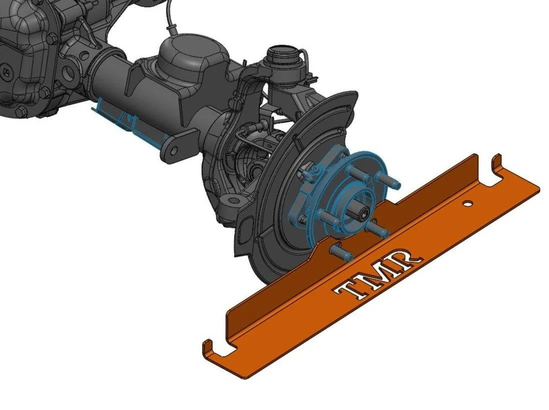

Could have just used angle iron or angle aluminum from a hardware store, would have been a lot cheaper.
Gren71
Jul 9, 2019
143
4,004
6,395
Magician
Yeah ... could have, but opted to buy a turn key option instead. Not your $$$
Got any examples? Id love to have a jig on the cheap
Bonanza
Apr 22, 2020
41
827
1,316
Southern CA
Sport S Max Tow Punk'n
I tried this once with square aluminum tubing on the tires. Then I re-did it with the TMR plates. It was not insignificant difference. I'd recommend getting the TMR plates.
