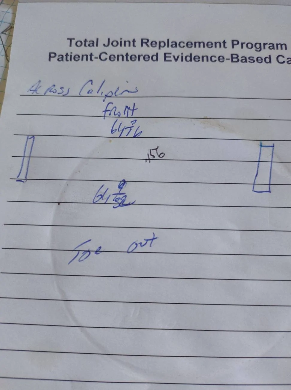

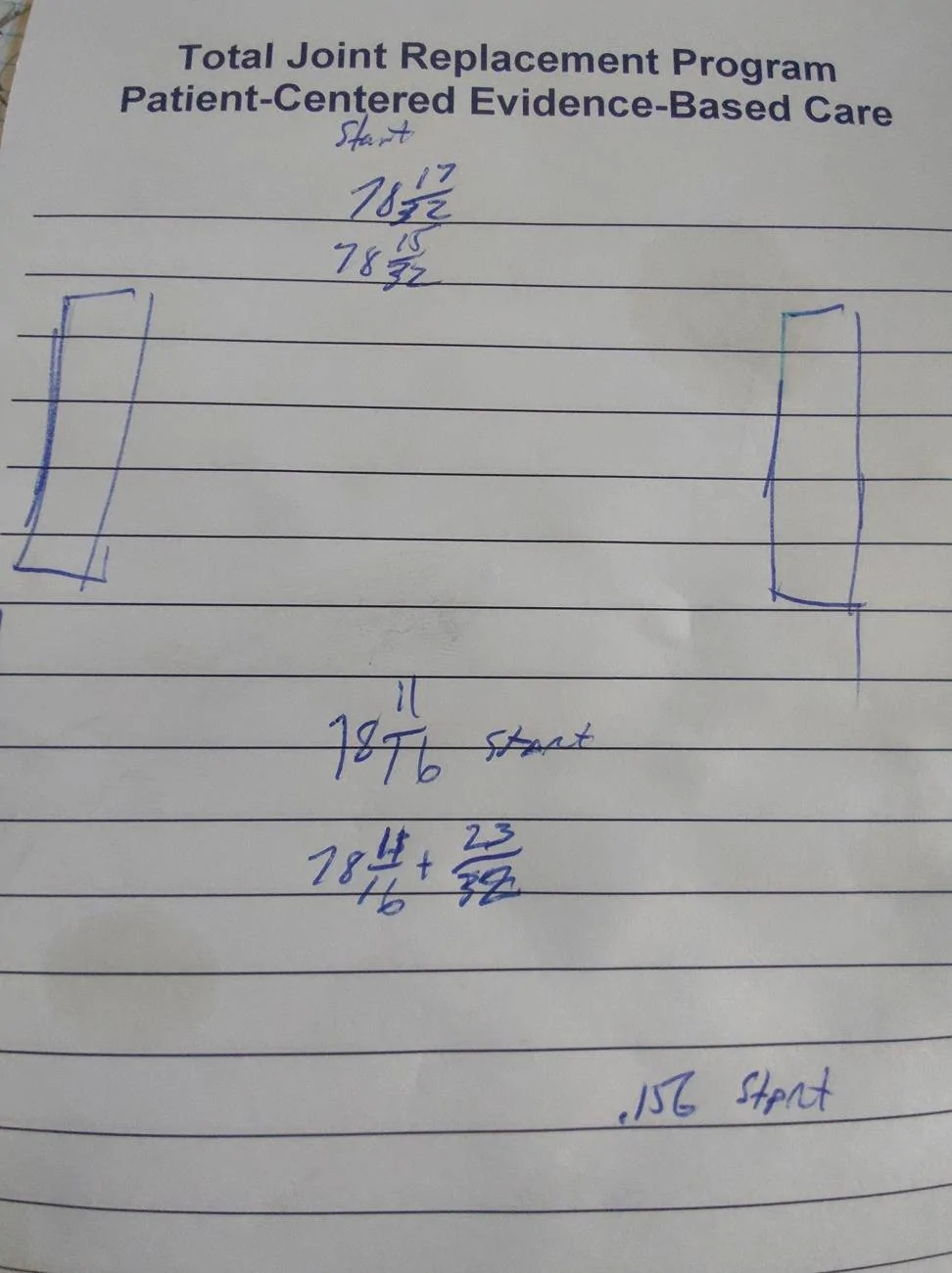

I ended up calling Metalcloak and asking them built my own alignment tool. Used their measurements. Came out a little more like .2 toe out. I'll have to find my notes.

Vegas 4X4 told me toe out on stock steering and toe in on upgraded steering. Still on stock steering myself. Took it in to double check alignment and they said .2 was to much. So they adjusted it to .1 Hopefully I'll get the upgraded steering on this weekend. I also had aluminum angle across the outside of the tires. For what it's worth it may be a starting point.
