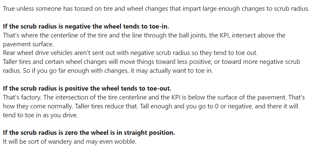

You should never need toe out on a stock vehicle. The tendency is to toe out.
So you set a bit of toe in, and then when driving the tendency of the road forces against the tire want to pull it back. That takes out all possible play and sets tension on the steering linkage for faster response in steering.
If toe out is required, then things have been changed or modified, such as a big change to scrub radius, causing the tires to want to toe in.

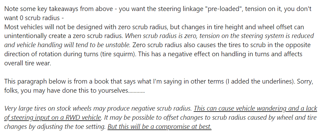

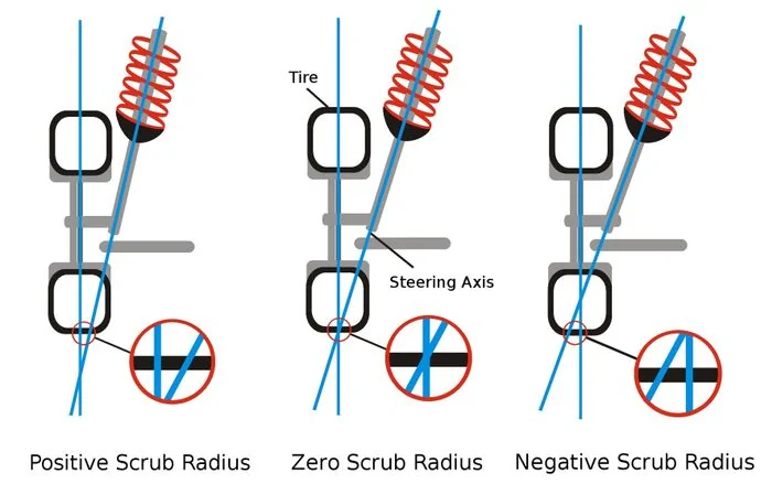

Not disagreeing, and yeah, that's about when I started, too.............
tires large enough and wheels sticking out, you change things and the tires tend to toe in instead of out.
But with just a lift and moderately larger tires, no.
So people know what's being talked about -
