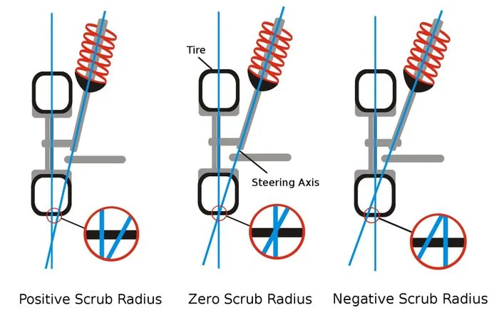

What's the basis of the assumption that otherwise straight tires push out instead of in when pushed forward?
The simple part I would say is becuase of weight on factory style back spacing. The face of the wheel is so far out, out it rolls.

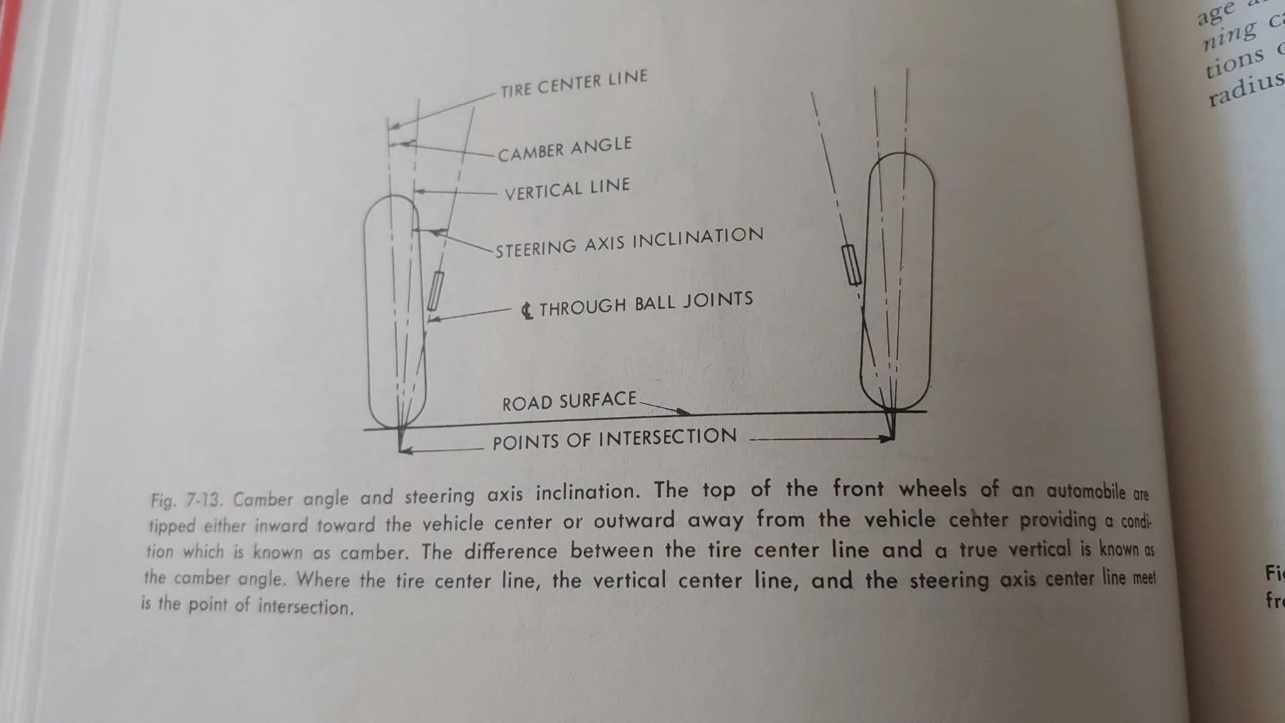

Scrub radius and the intersection of the angles as I posted earlier. I posted exactly when something will tend to toe out or in.
Jeep Gladiator Toe in VS Toe Out 20230115_120246
Jeep Gladiator Toe in VS Toe Out 20230115_120253
Jeep Gladiator Toe in VS Toe Out 20230115_120510
Jeep Gladiator Toe in VS Toe Out c65328d9f8fa4de6f42b7d1ed536d0d5
If scrub radius is positive (contact patch arc outboard of the pivot point), the wheels will try to toe out.

Just spit balling, is it possible some of these jeeps have negative scrub radius and would therefore naturally tow in?

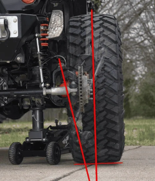

Interesting thinking and I've pondered that - and I don't have the answer for whether or not these are positive or negative scrub as they sit STOCK.
However, the toe-in setting should be a clue. If these are set to factory spec which is toe in, and they would naturally toe in, you'd see feathering of the tires due to the increase in toe-in as you drive.
Guys and gals who put on different wheels to move the tires out move their trucks naturally toward positive scrub radius. Taller tires move you toward negative. So one could do some math, put on taller tires and different offset wheels and keep the same scrub radius as stock or close to it.
Too much negative scrub radius, it’s unstable and provides less feedback.
Bingo! I found a guy who measured!
This is his quote -
A stock Jeep JK Unlimited Rubicon scrub radius is approximately positive 1-1.5-inch with 32” tires.
Jeep Gladiator Toe in VS Toe Out 1674054230456
The problem is that he states taller tires would increase it - looks to me that raising that axle by using taller tires brings the intersection up and reduces scrub radius - am I thinking that right?
