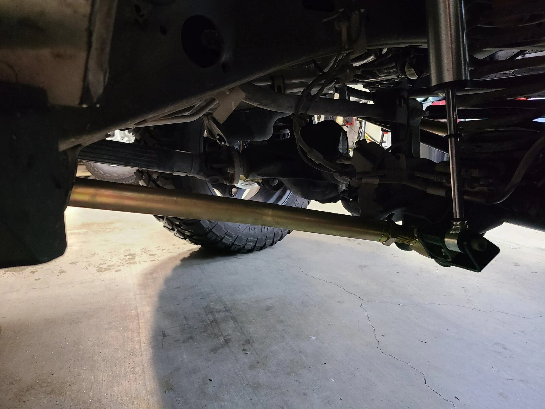

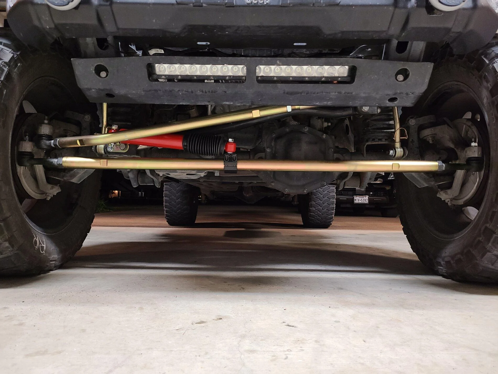

As a follow up: I replaced the OEM ball joints with Dana Spicer joints. Got all the adjustments done, then I readjusted and torqued the Steer Smarts set of track bar, drag link and tie rod which had all, within 2-3 weeks prior, been done, as well as tire pressure and balancing prior to install. Had incidents of death wobble before, during and after the install of the Steer Smarts set, and felt many more threats of death wobble, before the ball joints.
In this round, I went with the upper limit specified by Steer Smarts rather than mid point.
It's been about two weeks, with no death wobble so far. Yes, death wobble. As some say shimmy, I say skittery, is not death wobble. And, yes, several of these vehicles are getting death wobble, as well as shimmy / skittering. Both conditions from early on. With this set up, I also do not get the "skittering" either.
We should not be putting so much effort, and money($), into new vehicles to address these issues. And, should NOT have the dealer dismissing the issues because it doesn't want to admit there is such a "thing", going on for either of these conditions and the steering box.
BTW, it is now two months past the order date for the "corrected" steering gear box with no contact/input from the dealer as to when, how you doing, boo, just no communication! Even after an FCA representative sent a note asking if I'd heard from the dealership a few weeks ago.

You never said what type of lift. If it's the Mopar lift or a different type of cheaper lift it likely didn't come with adjustable control arms. I have the skykacker 3.5 coil spring lift and I had terrible DW after ~17k miles. I replaced my track bar, drag link and tie rod with Metalcloak HD steering kit...it didn't help. I initially took off my Fox ts stabilizer to put the rockspoet one on and that made it worse. I eventually installed MC adjustable lower CA's and ran the Caster way out - I don't even know the angle but they are extended ~1.5". This took care of the DW. My tires are wearing weird causing some bouncing but it never gets to full blown DW.
The lift was done by the Dealer, and the young man who first bought it off the showroom floor as the Dealer set it up, when I bought it. It does have Mopar parts, and no, they did not replace the control arms. It is a 2.5" to 3" lift by my reckoning. Again, the Dealer will not provide any information on what they did, or did not do; will not provide a copy of the window sticker or any other documentation.
Now a month into use with what I have installed, Steer Smarts and Spicer parts as noted, I do not have any occurrence of death wobble, and have not had an indication it might.
And still, no contact, response to message, regarding the expected receipt/install of the replacement steering gear box.
