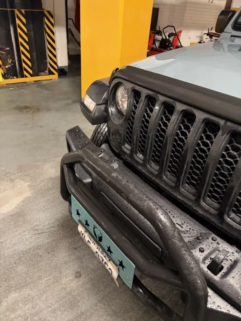

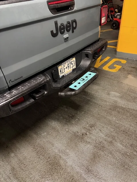

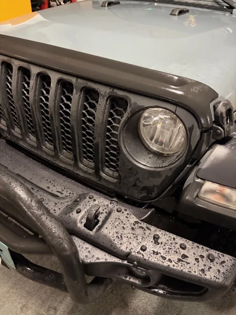

Finally installed the front and rear steel bumper. Included a pre-2024 Mopar black satin grill. Still need to mod the skid plate to fit with my snow basher(Tyger bumper guard). AM loving the steel.Am done with plastic!!
