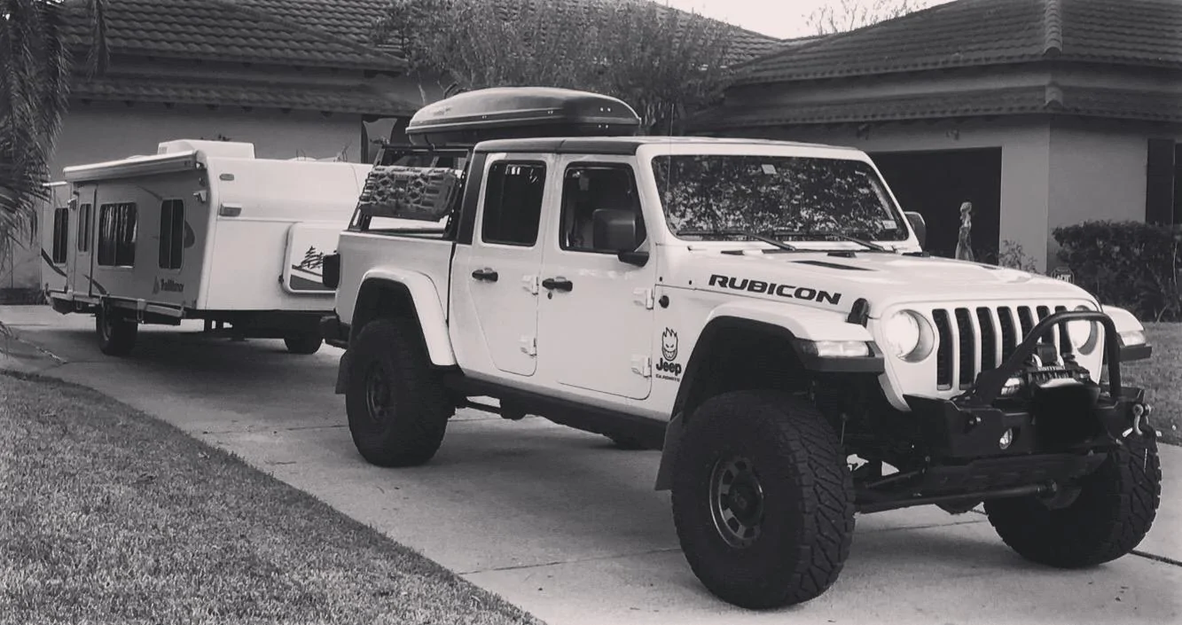

Well, at least it's a lot narrower than a Raptor!

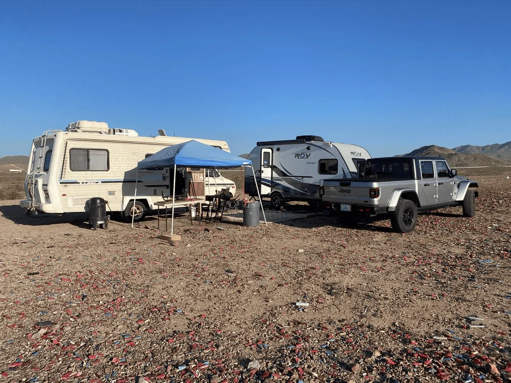

I have a Launch Edition, so that means loaded Rubi with an auto and 3.6. I tow a travel trailer that is full sized (high wind load) and weighs around 3500 loaded. I run a weight distribution hitch, and think that's critical (and only $230). That is far better than air bags, and never needs further adjustment, can't run out of air, etc.
It tows really well, far better than my JK did. The 8-speed trans is the key. I also have adaptive cruise which is so nice on the open road. Just slip in with the trucks and worry about nothing. The photo below was taken at the top of a long climb (215 in CA) which it pulled easily. I got it to 85 for a moment just to see that it can do it on that big hill.

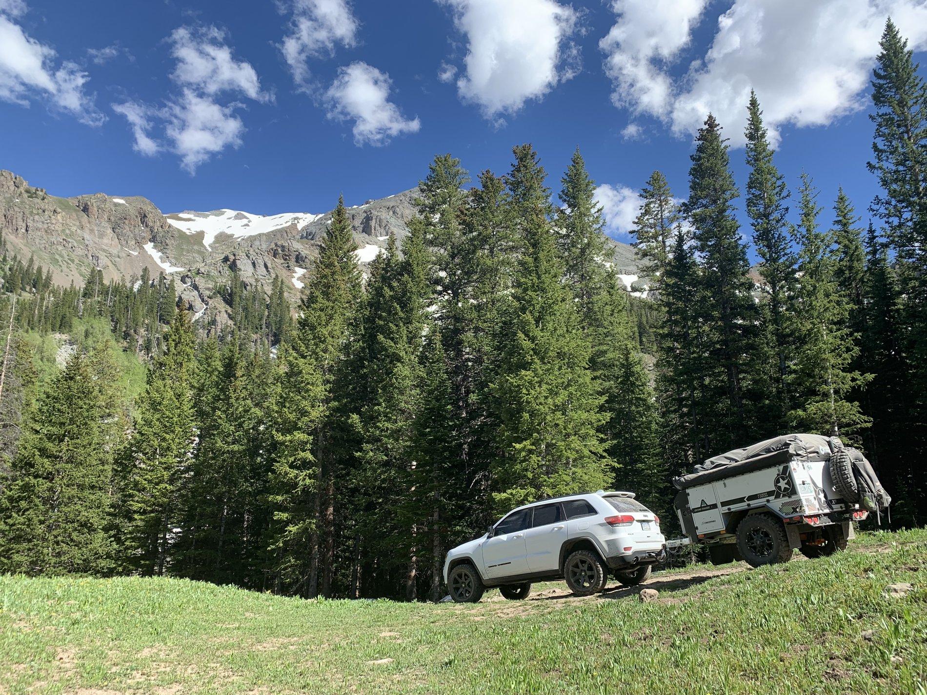

New member but been following the threads for a couple of months. I know coming in here is like going to a coke dealer and asking if his coke is the best resulting in biased answers but it's worth a shot.
I'm on the fence of ordering a 2021 JTR w/ tow package. Please feel free to tell me if I'm wishful thinking and to forget about getting a JTR, let alone a JT.
Wanting a Rubicon because I do actually wheel my vehicles offroad (i.e. lockers, having front discos, oversized fender flares) and want paint-matched hard top/flares, remote proximity sensors, 8.4 screen, leather. But here is where I run into my concerns (PAYLOAD):
-Rubicon of course has a reduced towing and payload capacity.
-I tow a low-center of gravity offroad camper that comes in at 3395lbs loaded, 400lbs tongue weight (see pic below).
-I was wanting to make the following mods - steel bumper (at time of order), warn synthetic winch, rebel offroad half rack, rotopax (diesel & water), soft tonneau cover offered through Rebel, mopar 2" lift, 37s w/ new wheels & matching spare, removal of the rear bench seat and for purposes of staying on topic let's just say I chose to install the goose gear setup for my 2 large dogs, along with a dual ARB, of course my recovery gear and RTT down the road.
-Now throw in the fact that I was wanting the Ecodiesel (live in CO, had one in our '15 GC Limited, and turbos are king out here at higher elevation - mostly tow from 5400-12000' elevation and the 3.6 in our current GC sucks towing through the mountain passes) which drops the towing & payload capacity even more (although I haven't been able to find concrete confirmation other than 1 TFL article referencing towing at 6k).
If I calculate my needs correctly, I come up with:
Trailer tongue weight - 400lbs
(2) adults - 300
(2) dogs - 140
front steel bumper - 60
Winch & Plate - 100
Rebel half-rack - 150
(2) 2-gallon rotopax diesel - 30
(2) 2-gallon rotopax water - 24
37" spare w/ wheel - 15 above stock
Removal of rear bench - (93)
Goose gear seat delete - 39
ARB compressor - 10
Total = 1,175lbs
Too many OEM items to give up going from a Rubicon to a Sport S w/ max tow but based on this it would be too much payload for the Rubicon and that's not even taking into account a full tank of diesel or a RTT down the road.
If I skipped the rack & rotopax, that only saves me 204lbs.
I can't stand the 3.6 in the wife's current GC trail hawk for towing, which is why we take my F150 super crew w/ the 3.5 RB on all trips but I was hoping to downsize the # of vehicles we have and go from my F150 and my LJ wrangler (that rarely leaves the garage and is left behind on every trip) to a capable JTR.
My last resort (which I really don't want to do because of the hassle it can create), is to forget about a JT and just upgrade my F150 to a new F250/350 and tow a flatbed trailer with my LJ and camper loaded to our designated and then park the truck and trailer, offload and tow the camper a short distance behind my LJ up the trails to our remote camping destination.
