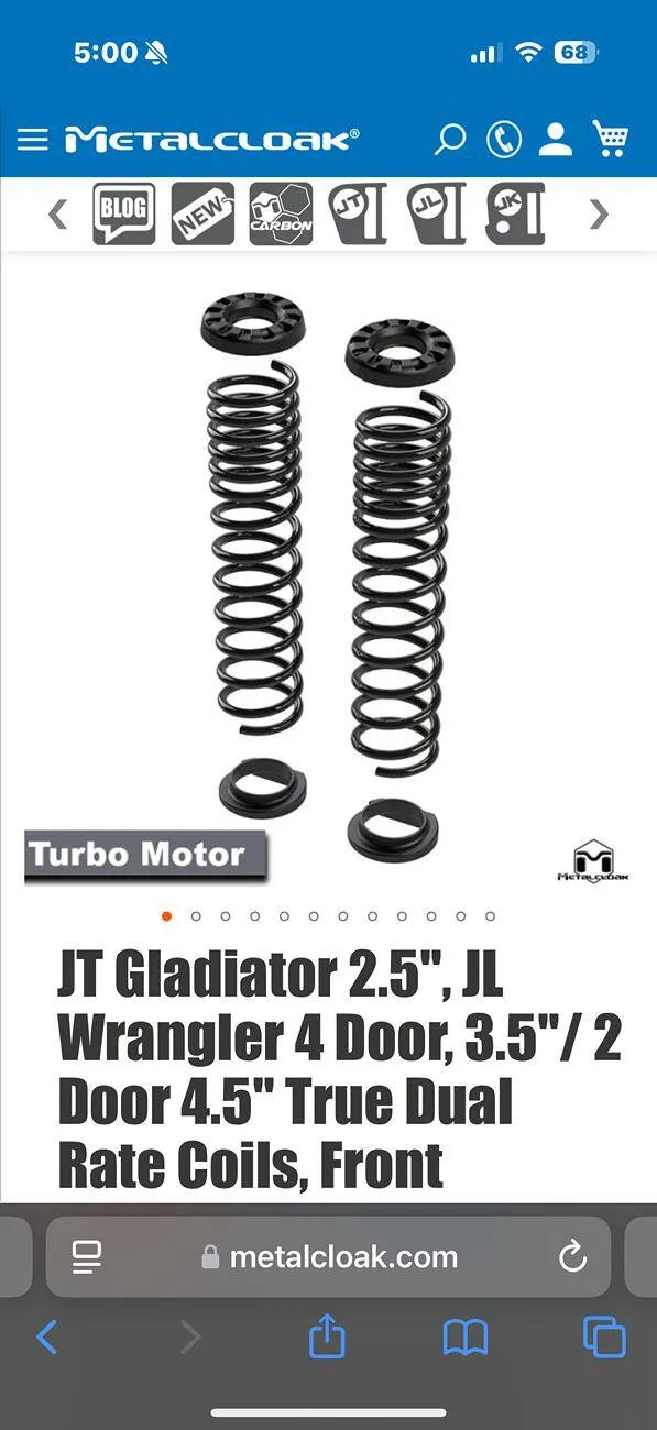

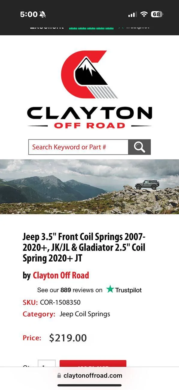

Looked up the part number in the picture and it’s a 3.5” JK/JL 2.5” JT front spring with an adjustable front track bar from teraflex as well and 1/2” or 3/4” rear spacer

Looking at the part number on my fronts springs they’re for a JL anyway. My front axle seems to be pulled back some. Probably just remove what is on there and start from scratch.
Which # did you use? I found just the springs typing in the whole #

I looked up the part number on the coil springs, and the track bar looks identical to an old teraflex track bar I installed on a buddies JL cuz the collar is what stuck with me as to why they would do that instead of just the one end being adjustable but they did that so you could adjust it in the vehicle

JL and JT front ends are the same. Same parts.
Oh I know but for some reason they always mark it as an inch less for gladiators over wranglers. Don’t know why but I don’t design and build them
I’ve seen 1/2” less for rubicon, but didn’t notice a JL JT difference.

I have yet to understand it especially if they both have a 3.6 then every thing should be identical but most places do it
Weird. I hadn’t seen that, but who knows. Metalcloak does keep their spring rates pretty close to the chest, so who knows why.
