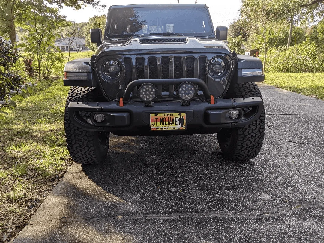

Mojave had a plastic bumper and silver skid plate , Rubicon also came standard with plastic bumper and same skid plate only black. There is a different factory skid plate to bolt to the factory steel bumper, actually bolts along bottom of bumper. So if you in fact have the factory steel bumper on a Mojave you can get the right skid plate if needed, and might have some issue with the remote shocks but not sure….Jack
This ^^^ is the only post that correctly explains what is going on.
Stock Mojave silver skid plate will not work with the OEM/Mopar Steel Bumper. Neither will the stock Rubicon black skid plate. Not without modifying the skid plate or the bumper.
The black skid plate that is designed for the OEM/Mopar bumper will work on both Rubicon and Mojave without any additional modifications. The remote reservoir shocks do not need to be relocated.

KevinC has the bumper on a Mojave with Mojave shocks…..BINGO!
To add to this, the Mojave fox shocks and reservoir brackets fit just fine on Rubicons.
The shocks (I forget, front top?) need a sleeve for the bigger bolt holes, and since the coil bucket is raised, the wire brackets holding the shock hoses don’t fit.
