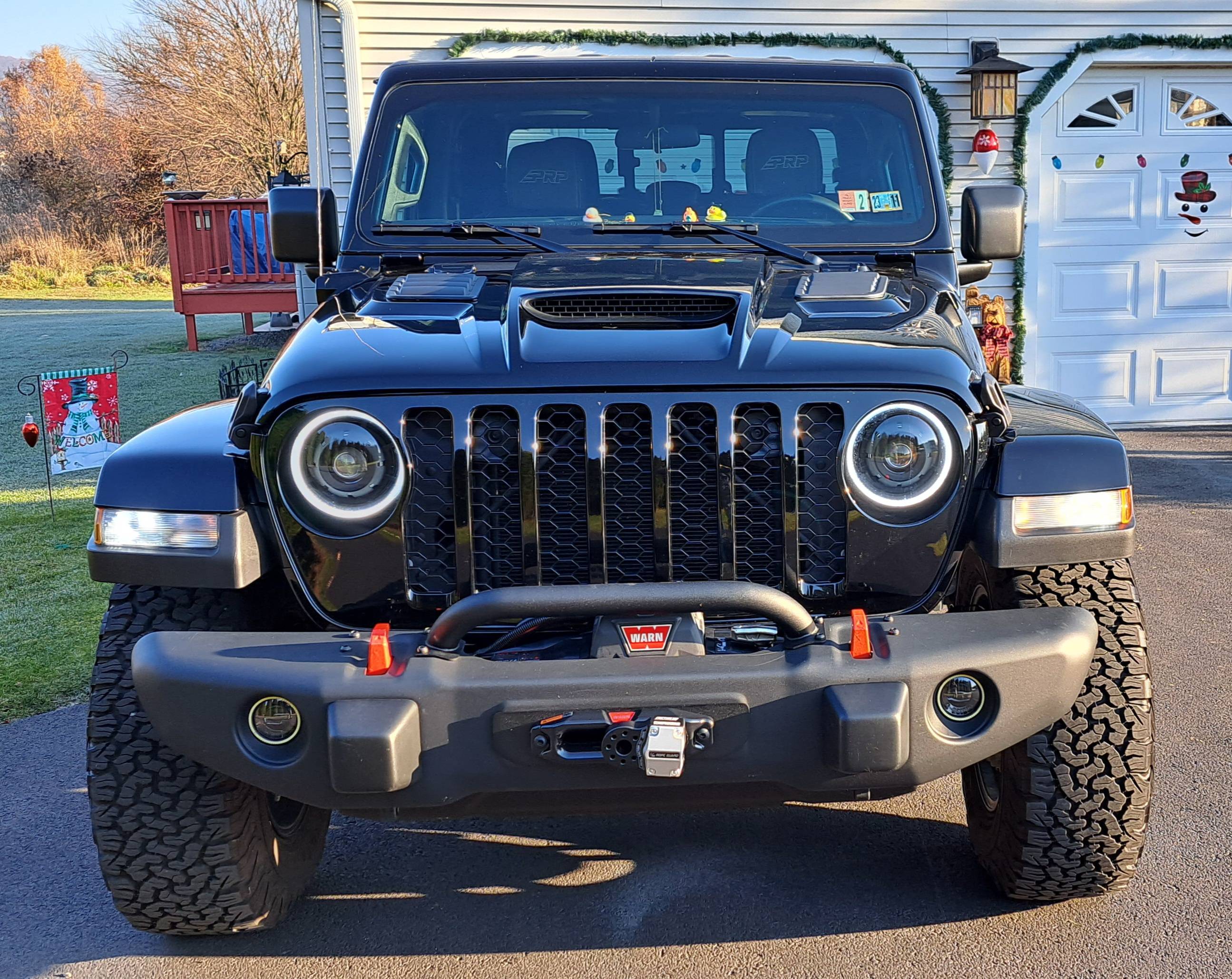

Your ARB Bondi is an awesome bumper. Old Man Emu and ARB make great products that will last. If I had an ARB on mine, it wouldn't get changed out.
Good looking JTM
Thank you sir!
Absolutely, that ARB quality is top tier!

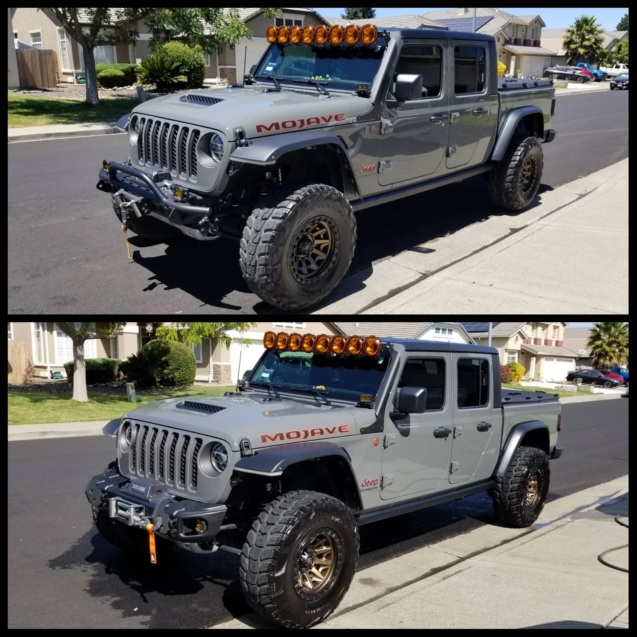

Are you still running the 37’s with no lift? How’s it been doing? No rubbing?
I added 2” AEV spacer lift and 1.5” wheel spacers a month later because I already have it on hand. But during the time without the lift, (just fyi this is) the 37x11.50R17 did not rub at all on stock suspension. I‘ve taken it to Joshua tree, Big bear, and power line roads doing Mojave stuff, no rubbing what so ever. I run them on 30-31psi for roads and 15psi while wheeling. So far no issues throughout.

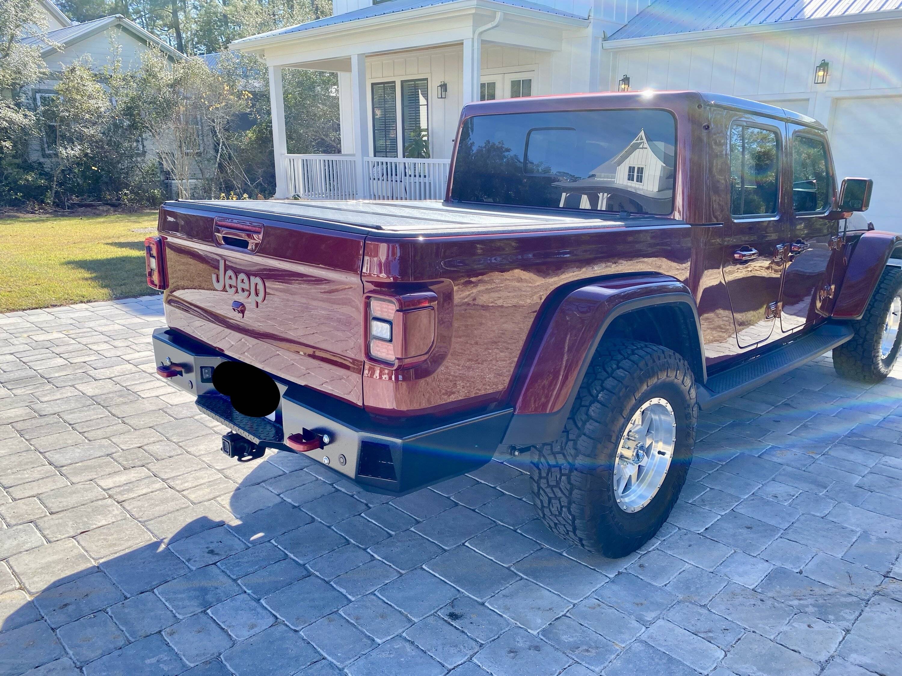

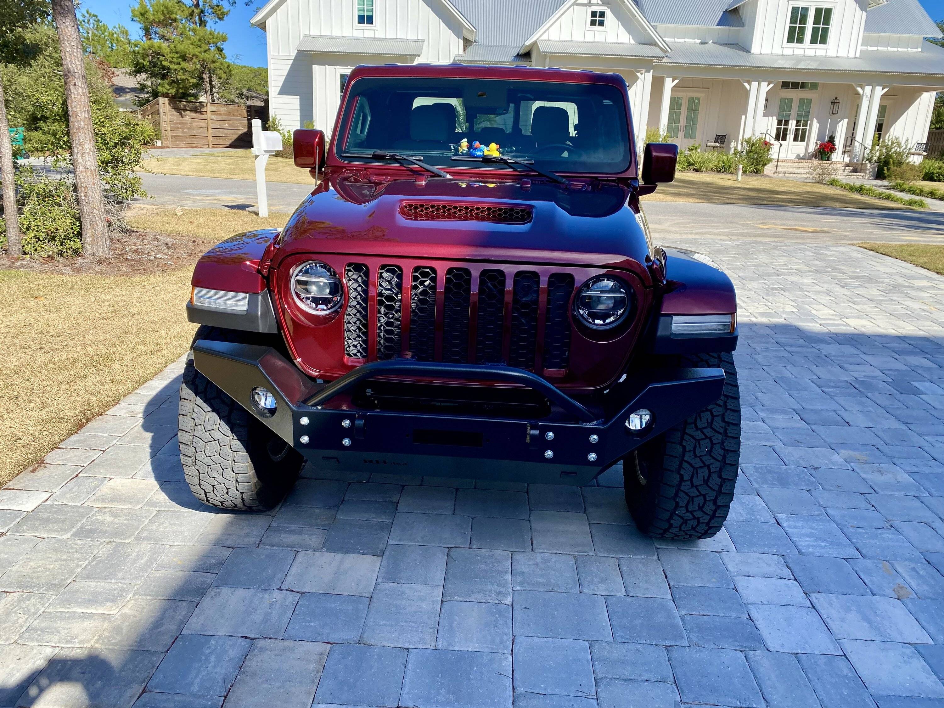

RockHard 4x4 Full Width Aluminum on the front. No winch .... yet.
Jeep Gladiator Mojave Front Bumper Options IMG_2781

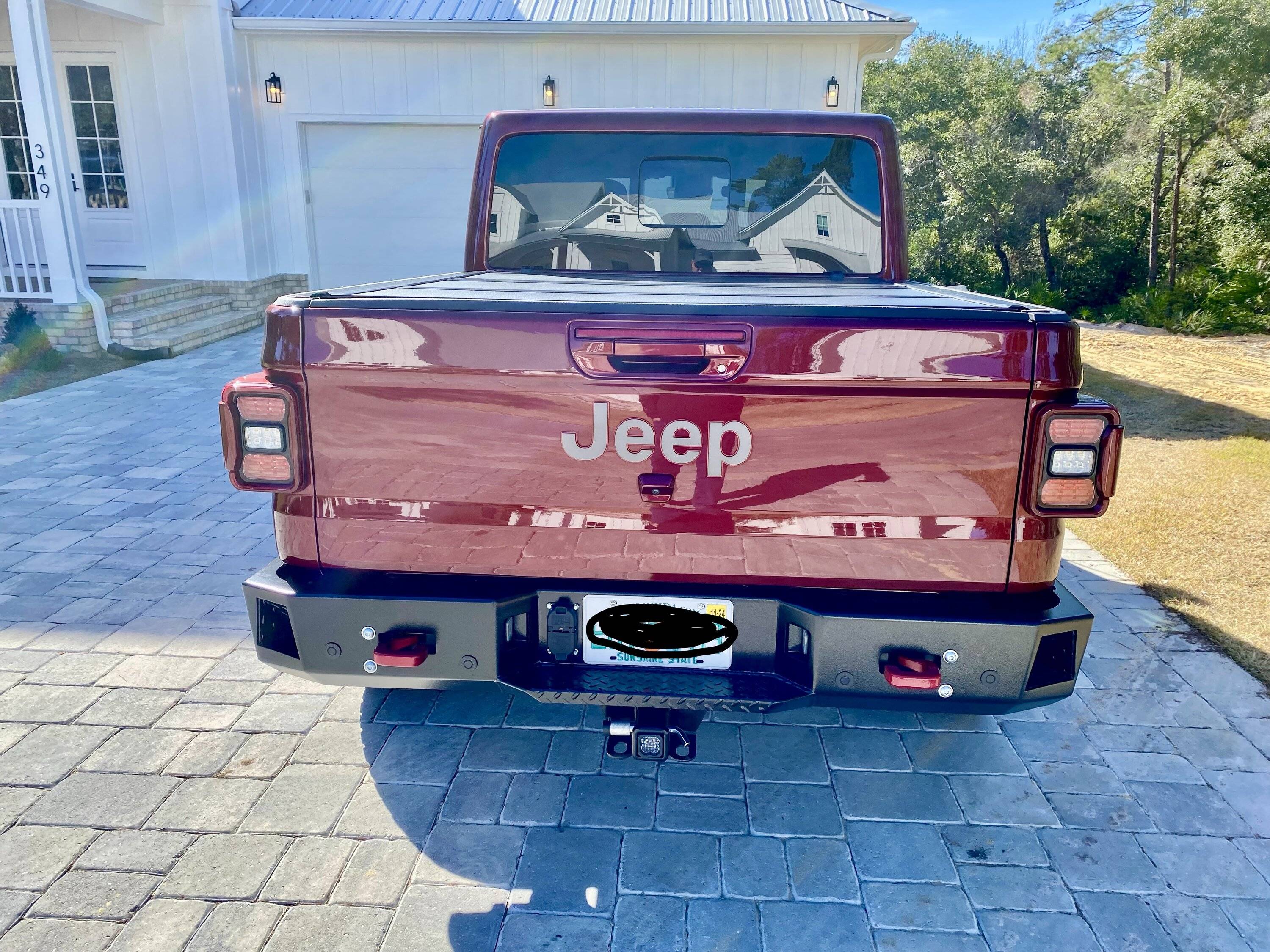

RockHard4x4 Steel on the rear.
Jeep Gladiator Mojave Front Bumper Options IMG_2782
Jeep Gladiator Mojave Front Bumper Options IMG_2783

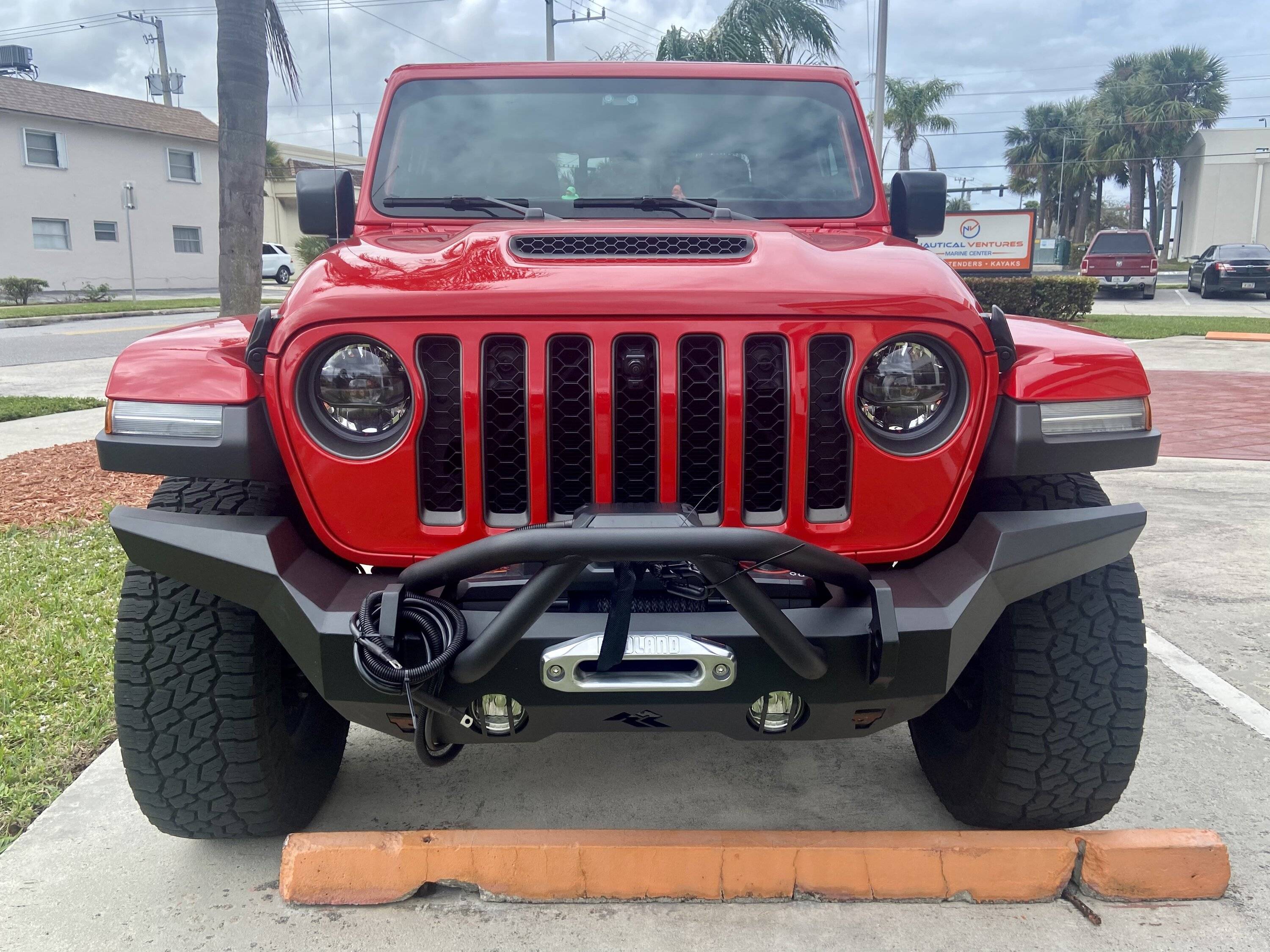

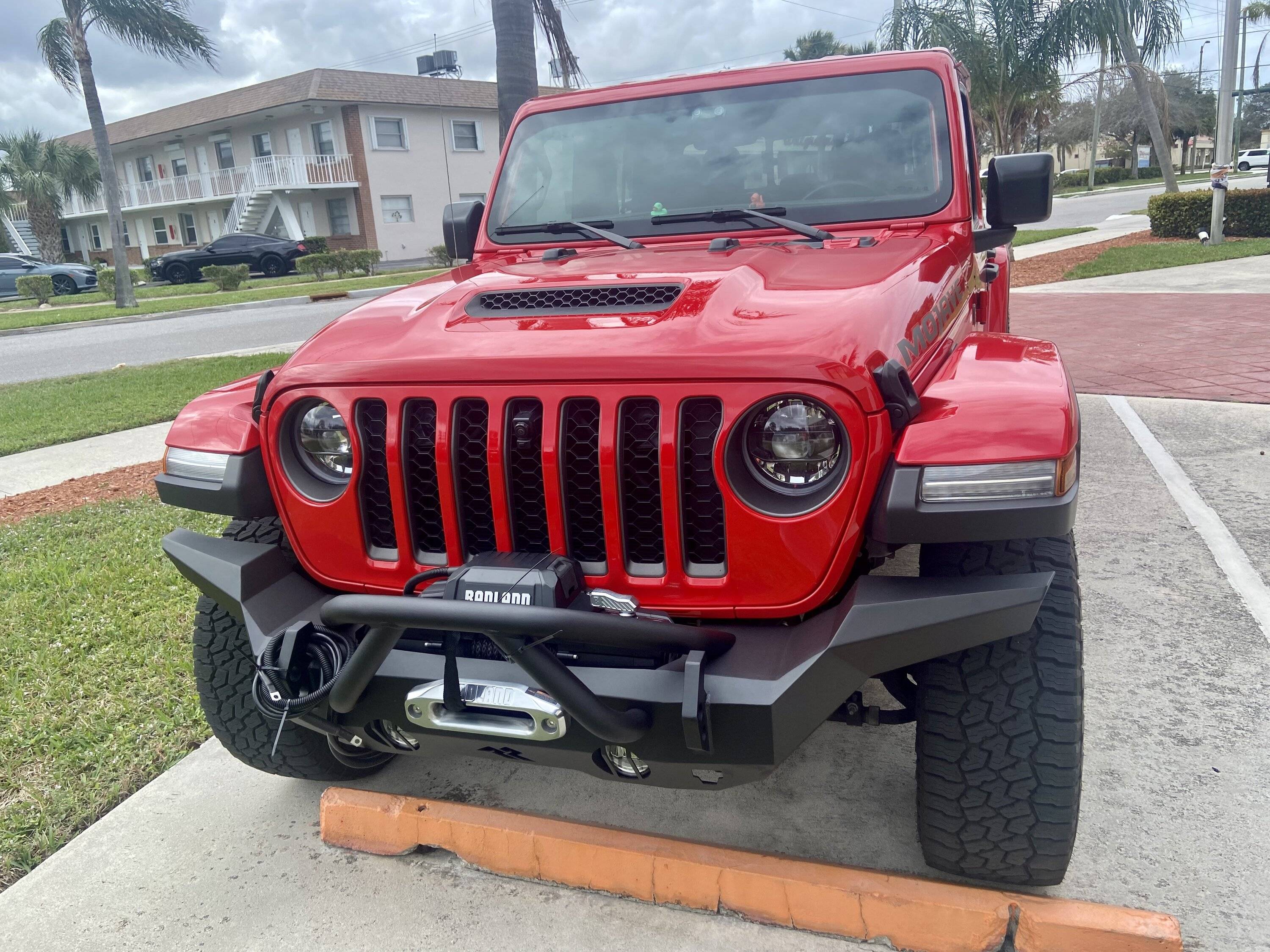

Finally got around to swapping bumpers. I sold my Rubicon steel bumper to a friend and installed the Rugged Ridge HD full width bumper on my Mojave along with an Apex 12000 LB winch. I also purchased the Rugged Ridge X-Striker Bar which really adds a great look! Installation went smoothly except for a couple things.
First, the winch positive power cable needs to be relocated from the back of the winch to the side of the winch to clear the grill. It’s a tight fit. This required removing the winch top covers, drilling a hole in the cover and rerouting the cable. It wasn’t hard to do, just a little time consuming.
Second, due to the fog lamp location being more central on the bumper, I need to remove a couple of frame harness clips to gain the additional length to plug in the fog light harness.
I ran out of daylight and still need to hardwire the winch and reinstall the Mojave skid plate. That will be a job for next weekend. In the meanwhile, here’s a couple of preliminary photos! I think the combination looks great!

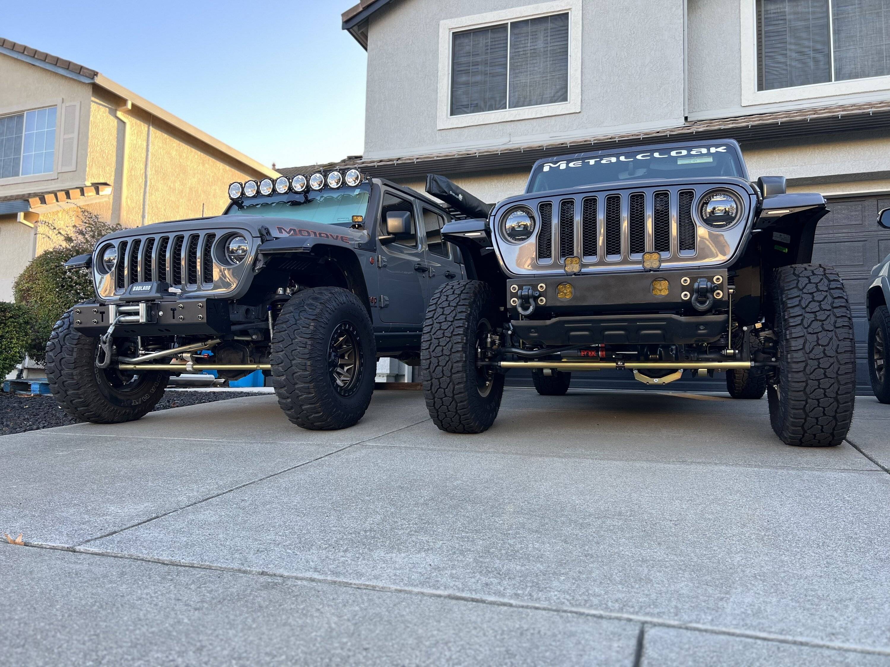

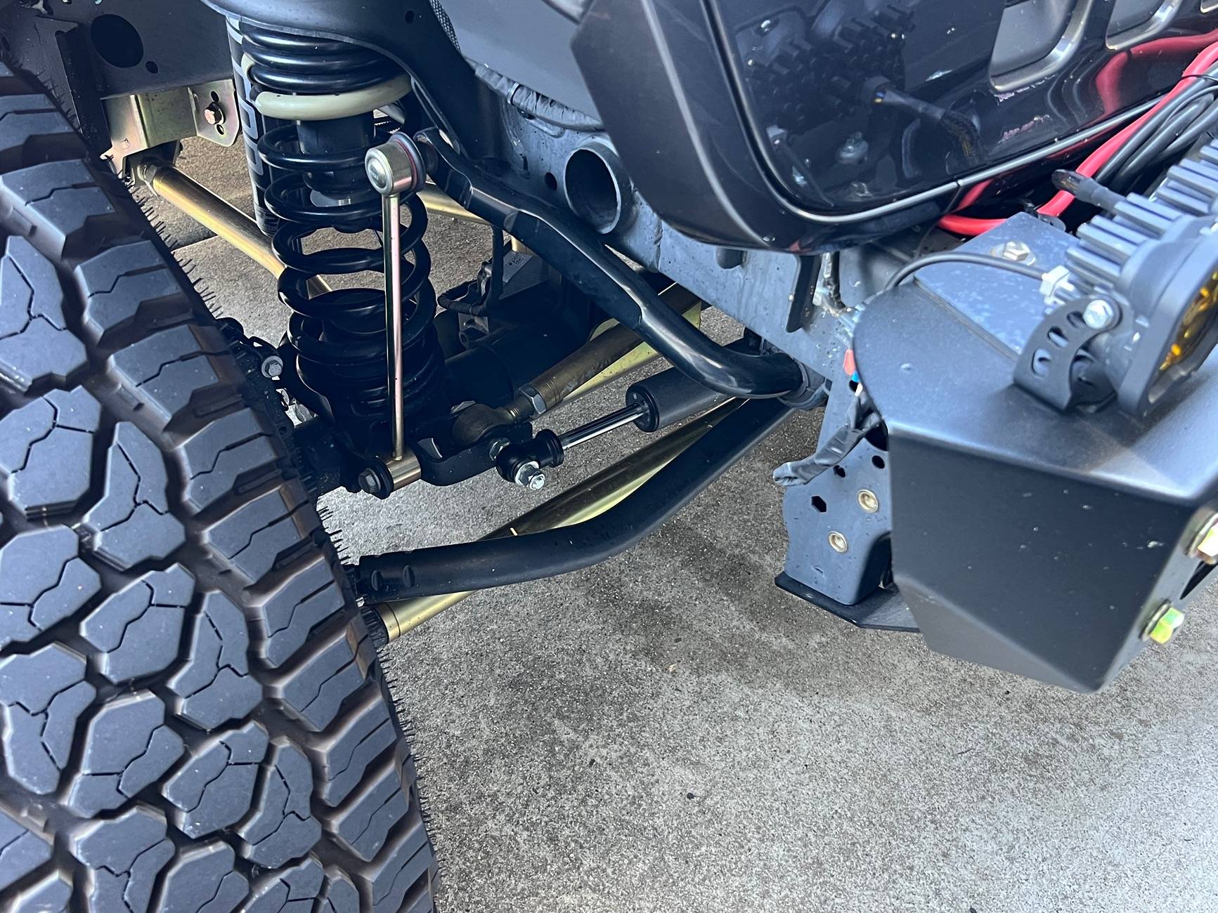

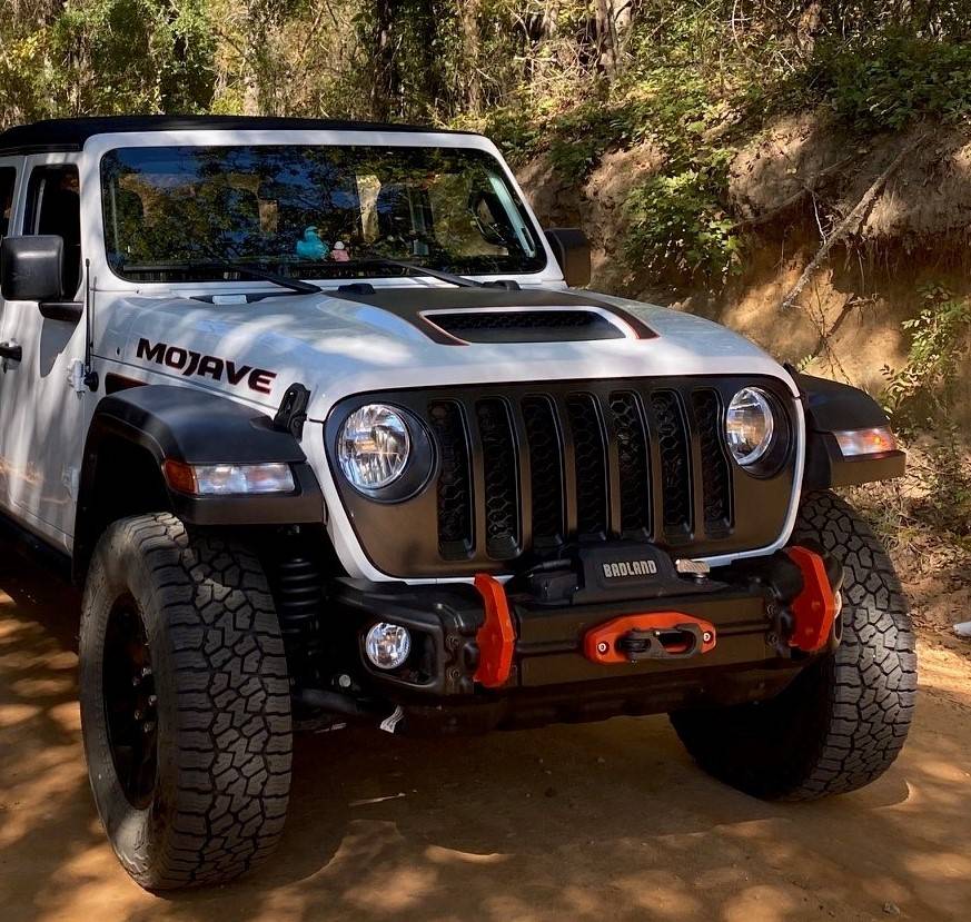

I ran the Arcus but changed out to the Barnes but then realized I don’t need that front skid and cut the frame horns and went EVO
I see you have the MetalCloak relocation bracket on the falcon stabilizer. For the fox are you just using the stud that came with it? Mine rubbed a tiny bit on the tie rod, but I was told the MetalCloak bracket wouldn’t work for the fox ats.
svc707
steve
Apr 28, 2021
515
674
Vacaville, California
2021 Gladiator Mojave
On the fox I’m just running the stud mount
