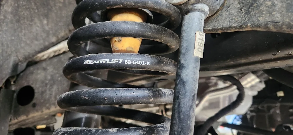

So the front springs are Readylift 68-6401-k and when I look that parts # up there is very little info. What does come up are some marketplace listings with spring with that number on Jeep Jku's.

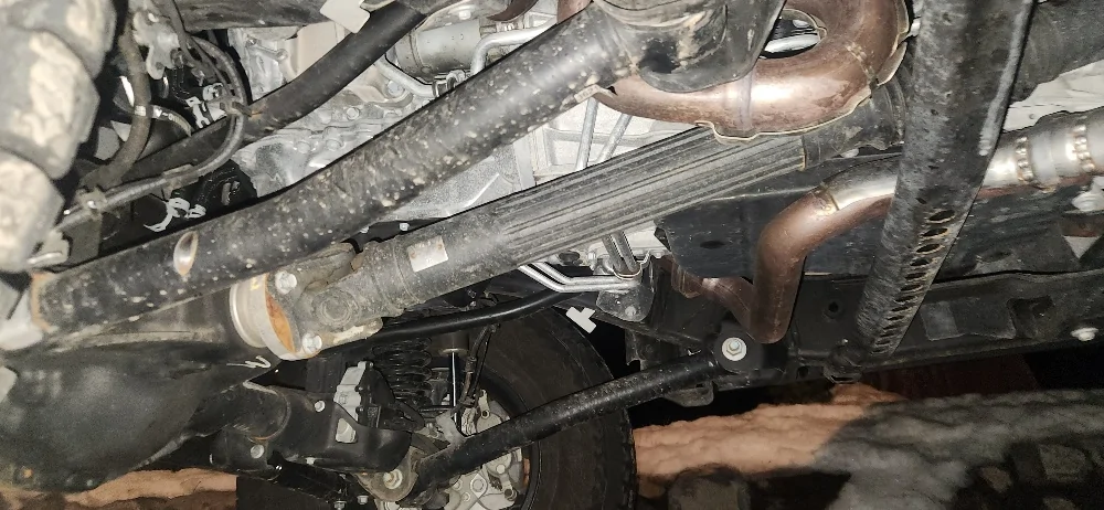

I believe that is is a full Readylift kit, but the part number has me off. Plus I don't quite see all the components in the photo of that lift kit.
The track bar is adjustable. The Control arms are not. And they are tubular.

If those control arms are not adjustable, you may need more caster.
With a shimmy, I'd check the condition of the drag link and tie rod ends. Make sure there is no play in them. Hold your hand on the ends while someone shakes the wheel back and forth and feel for a clunk.
I have a shimmy right now that is bordering on death wobble. I also detected a clunk in the drag link ends, so a new drag link is coming Saturday and we'll see if that alleviates the issue.
Torque should be checked on all the drag link, tie rod, front control arm, track bar, and ball joint connections. Check the front ball joints for play.
Even if it's low mileage and certain items were never fooled with, you never know where an issue may lie.
Solid axles suck like that. Worn out components in an IFS vehicle just means a rattle or a pull in the wheel. It usually needs substantial wear / damage to affect drivability. On an SFA, the slightest wear in things can really throw it off.

So I called Readylift and yes that is the lift I have. That part number is the coil that comes with it. Strange that theres nothing when doing an online search, but whatever.
