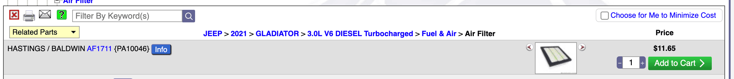

Don't make the mistake I did and pick up the matched part for the Hastings filter on RA. Not an expensive mistake but was still surprised they list it despite clearly being for the 3.6 once in hand. Docs Diesel had them for awhile, I ordered an extra but they no longer have them in stock. I grabbed a few oil and fuel filter sets on their recent father's day promo. I'd give them a ring and see when they are getting their next air filter batch in.
Screenshot of the non-fitting (yet listed as a match) filter to avoid:

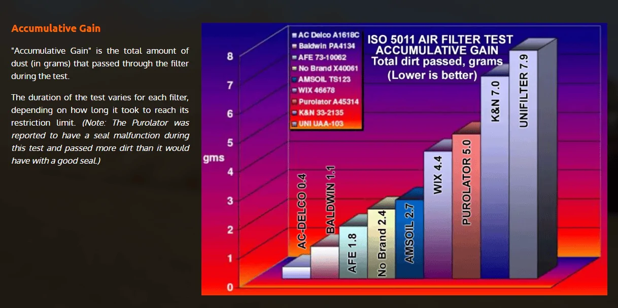

Marketing and those believers or kooaid drinkers that rely on anecdotal stuff out there.
They are fine if you must have maximum air flow and aren't so concerned about the dirt also getting through.
They are the worst or near to for actual filtering. I have the charts from real ISO testing - scientific testing, not DIY youtube stuff.
Any engine exposed to fine dust will have issues. Not a matter of "our Jeeps" or gas or diesel, they just do a poor job of filtering.
They rely on marketing and believers going out and about and promoting them.
It's a thing that has taken on a life of its own - they look cool, and so on.
Hey, that race engine has one, they must be good - but think of the drag car on a 1/4 mile strip compared to a vehicle used on real roads and with an engine that's not torn down every few miles. When your high-dollar catalog outfits like JEGS, Summit and others sell something, it must be great and cool. The proof is against them and yet they still sell like hotcakes because peer reviews are better than science.
K&N is next to the worst one tested in amount of dirt it let through or passed -
Jeep Gladiator Diesel air filter for 21 JT. total-dirt-passed
They are also real quick to lose capacity - in other words, they may flow air very well when just put in, but are quick to lose that advantage, all while passing more dirt. In short, yeah, you can clean them but unless you constantly clean them, they get restrictive (again, while passing more dirt)
One guy tested a K&N direct replacement in a Ford pickup - on a dyno. He picked up a couple of HP - at RPM in the 5,000 range. So how often do you drive at that RPM?
